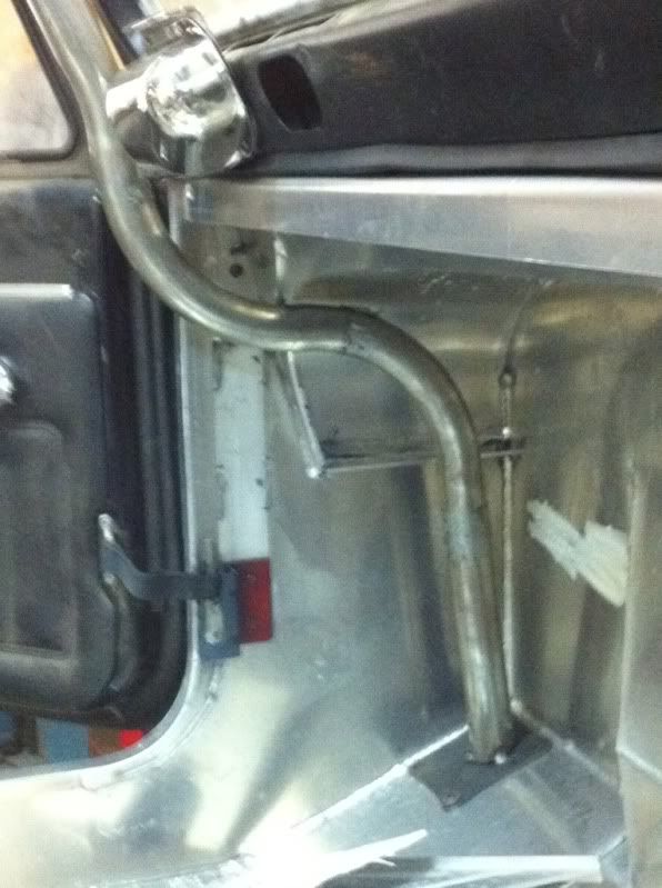

How about this. I 've been following this thread because I am also doing a CJ-8 Aqualu tub project. I'm in the middle of my cage and this cage will be a through the dash style to have more foot/leg room, needed for my wife. This was done with a ProTool bender(converted to air/hyd) and Bendtech software.

Aren't those bends going to fold if you roll it onto the top?

Possibly but I would trust this one piece of tube(1.75 DOM .120 wall) bent like this to the floor, than bolted to the dash. I considered the dash idea but don't think it is strong enough. Cages are always a compromise between function and safety and this design will be fine for my use. I'm sure others will disagree but that's fine too.
http://
Thanks for the images and ideas. It looks great. Those tubs sure are nice and shiny, aren't they. How are you planning on finishing the aluminum?
