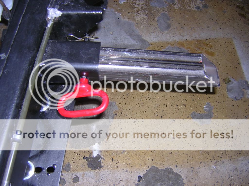

Jim, roughed in receiver for step a while back, (got idea somewhere on JF)might incorporate into sliders
This is a cool idea and good detail. I wonder, though, if it will bounce around, knocking, making rattling sounds on the trail? I've never seen a reciever that didn't if it didn't have enough weight on it, like a boat.

Easy fix, weld a nut on top or bottom and install a bolt to keep it from rattling!

Quote: This is a cool idea and good detail. I wonder, though, if it will bounce around, knocking, making rattling sounds on the trail? I've never seen a receiver that didn't if it didn't have enough weight on it, like a boat.
To stop the rattle and create a tight fit, weld some beads on tube then grind them down, fit, grind, fit. Worked on previous project.
Great ideas! Either method would work.

Trees moving??? I've had more problems with the road disappearing below me!!! The winch save me from that!!!
In your line of work Bill I figured you'd have heard that excuss before.
Guy I have a question about sliders. I see them made where they either bolt right to the tub or attach to the frame and have a square tube under the tub. Both have dom bent and welded to them that protrude past the outside edges of the tub. Most of what I see the tubes are welded on at an angle pointing up. Why is this? Why could they not just be welded on at a 90 degree angle to the side of the tub. To me that would make a better step and give just as good of protection.
Ideas???

Wouldn't they be more prone to getting hung up on something at 90*?
