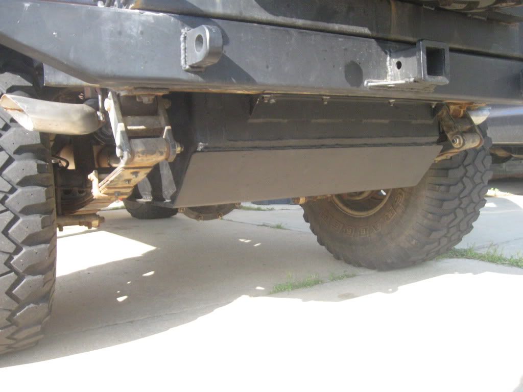

Jim, I have a 26 gallon tank made by Aero. Is huge and sticks down a little farther than I like, but its nice not looking for a gas station so often. I got it used for a good deal, only reason I have it. It has a heavy duty plate welded to the bottom of the tank as a built-in skid. I think its similar to what you are talking about
That's just what I'm thinking of building. Could you get some rough measurements off of it for me please? Looks heavy duty! Thanks

I can get measurements tomorrow, here is their website, mine doesn't have the in-tank pump option. They want around $450 new for them, got mine for $150 if I remember correctly. The make a 33 gallon for a CJ8 too. I'm sure you can build one yourself better and cheaper, don't trust my welding enough to make one myself.
http://www.aerotanks.com/vehicles/jeep.html

Went and looked at the Aero website. They look to be well made. $598.00 for the tank with everything. Considering I will have to find a shop to make my bends for me, and it's 40 miles away, then the work to build it....hmmmm I might not make this after all.
Our post must have crossed paths. Your tank looks well made. I think I'll check with them Monday and see if they can move the filler to the other side. I used the YJ tub and didn't move the filler, I'd rather have it on the driver's side.
