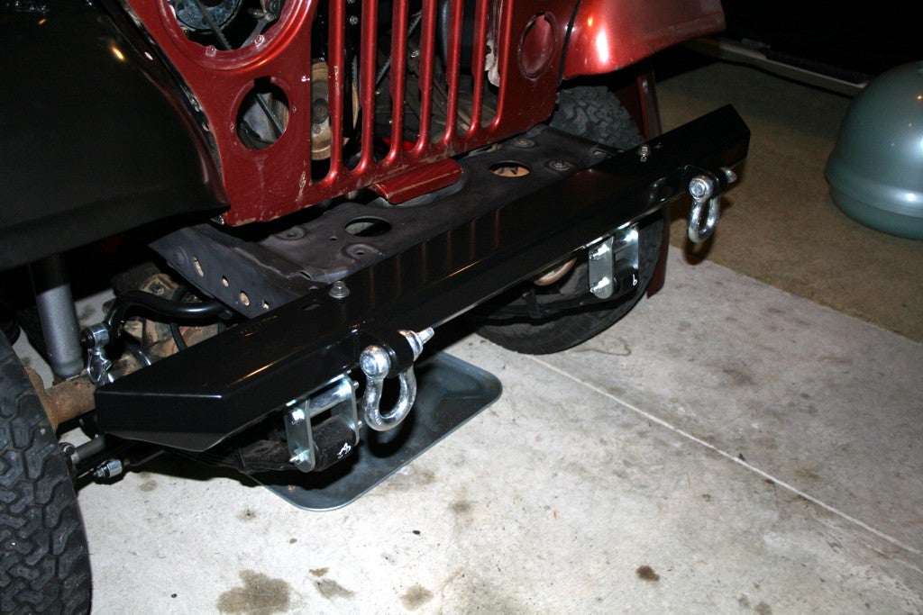

While I'm waiting on a choke...
I'm waiting on an electric choke to come in the mail for the new Motorcraft 2150 carb I'm getting ready to put on the Yeti. Mine got damaged during shipping. So while I'm waiting, I ordered a new Pro Comp Jeep Crawler front bumper with D-rings for the beast. Real heavy duty. Got a good price on it I though. Looks good. I'm very pleased.
Air Force Jeep Club - Tail # 200
