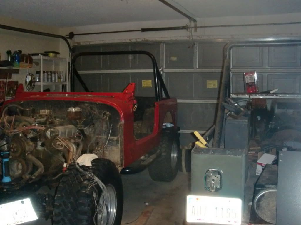

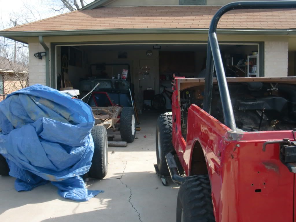

ok so the city came by because since i have the two jeeps in the driveway my truck and wifes car were in the driveway over the sidewalk. they left us warning stickers on our windows. i was so mad because the sticker just ripped when i tried to pull it off. luckily the jeep still runs just no steering. so both are crammed into the garage.

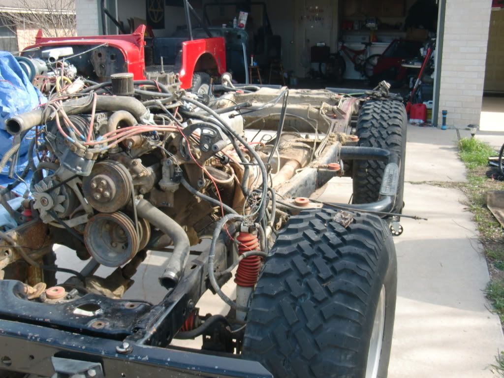

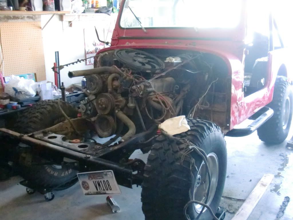

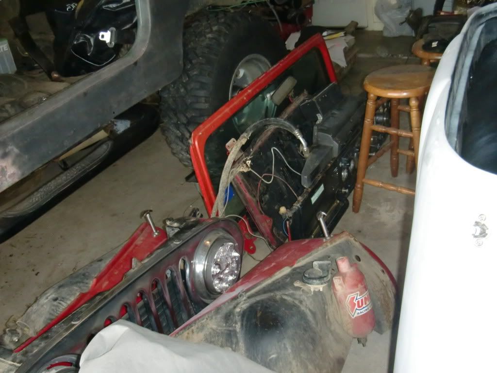

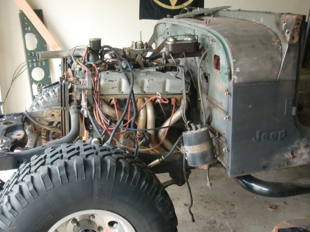

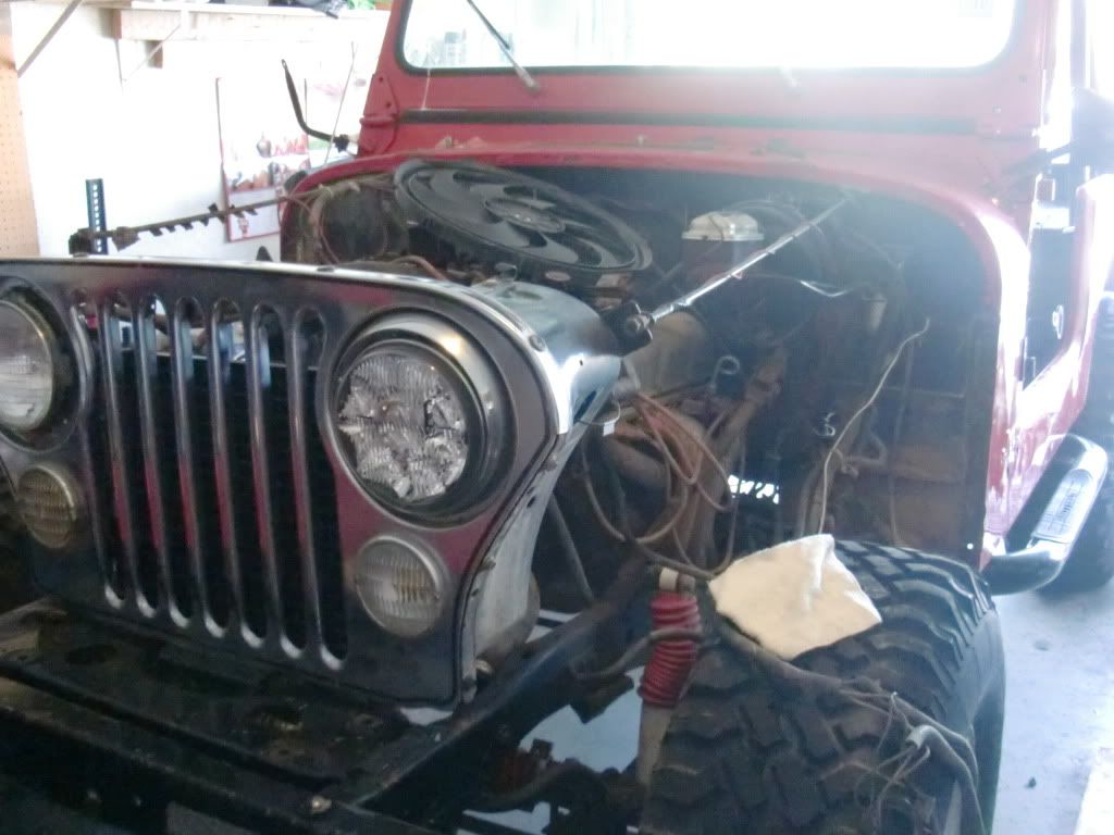

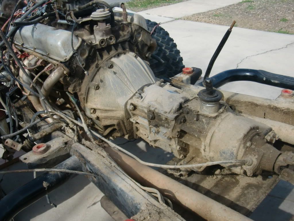

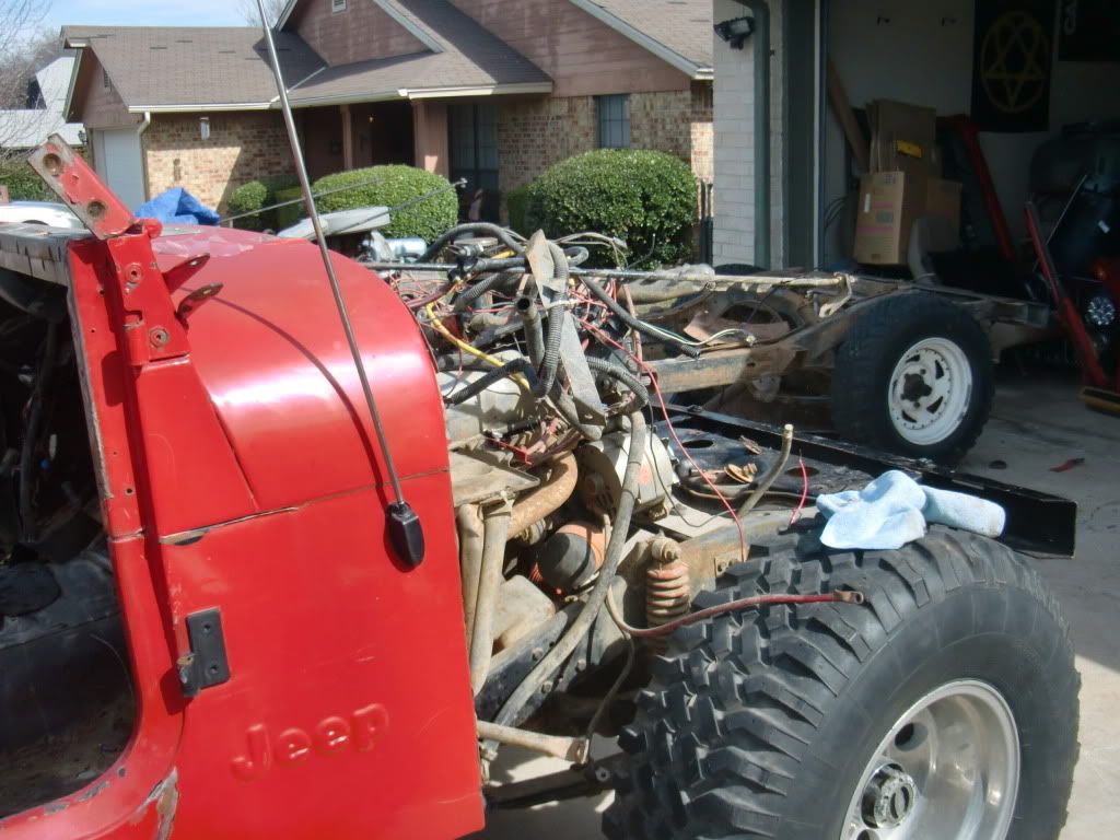

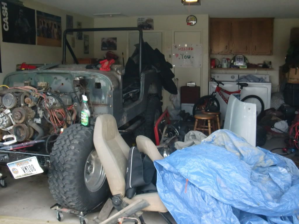

Teardown of the Big red Beast

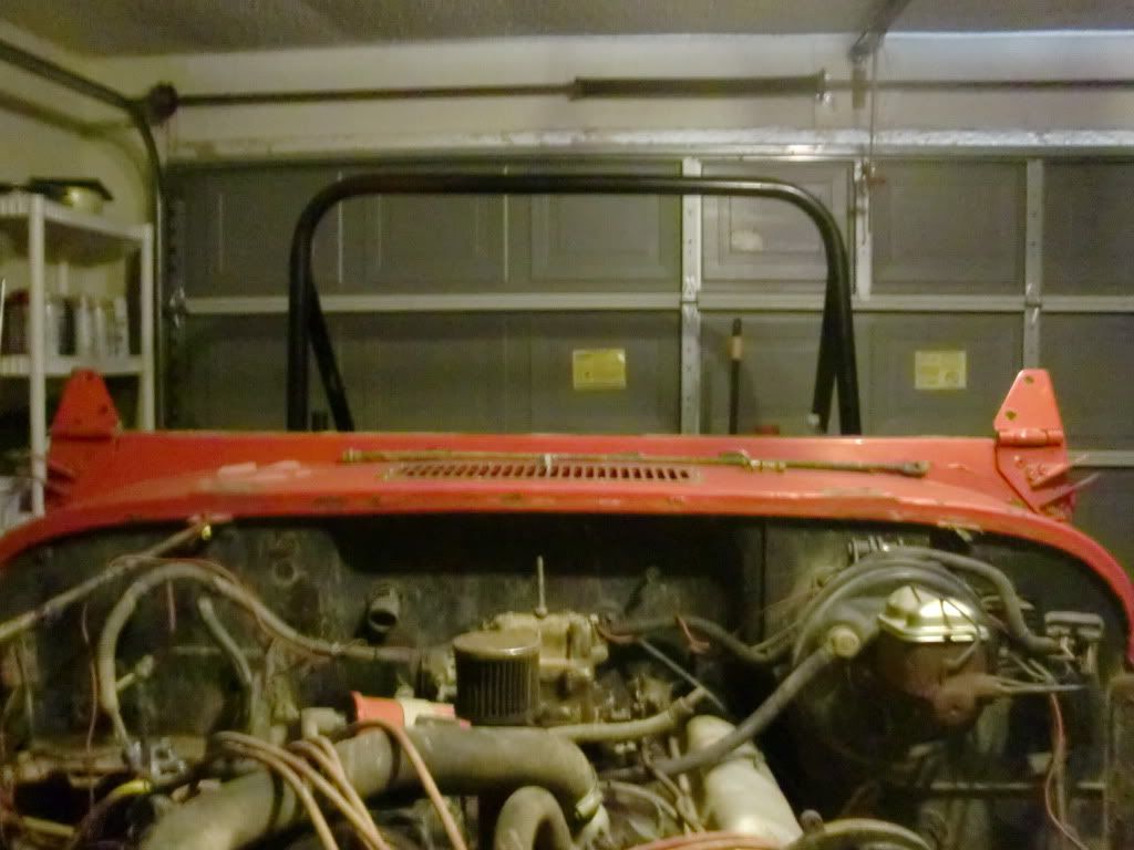

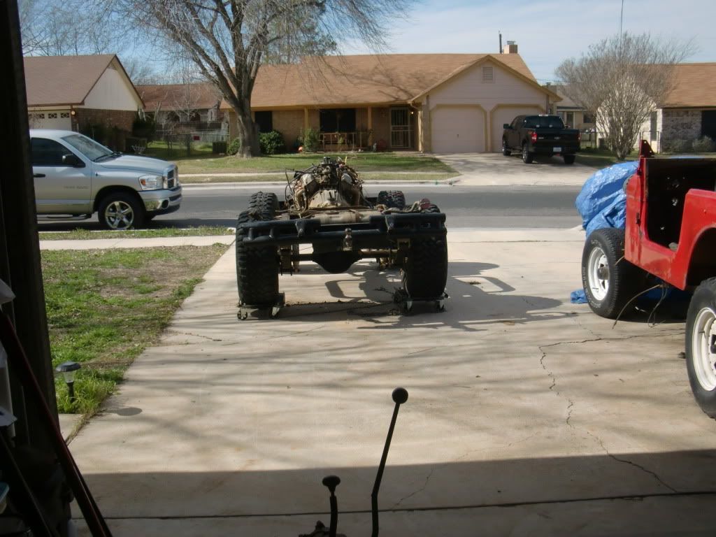

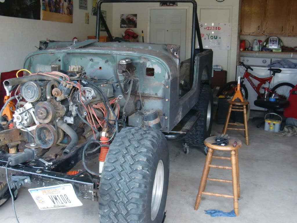

well started to teardown the red jeep.
went alot better than the green jeep
been looking this over and thinking im going to paint the engine tranny t case ford red so i can see leaks. easier now that its all off.
couldnt resist taking this i know everyone else does this sorry
got it all off in the morning can i just say I HATE TORX AND ALLEN HEAD BOLTS. NEVER AGAIN.
the boys wondering whats going on
the wife looking at progress
green jeep in the background

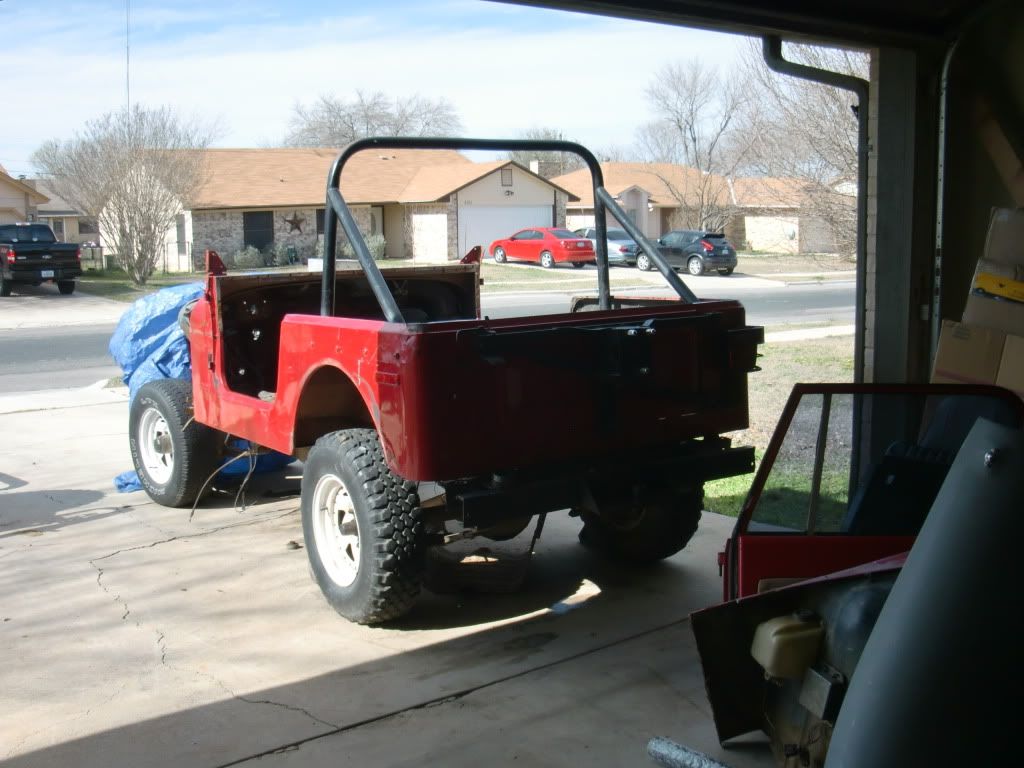

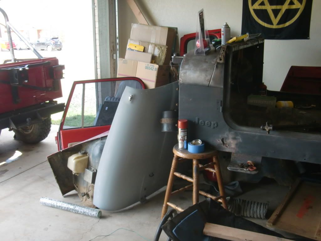

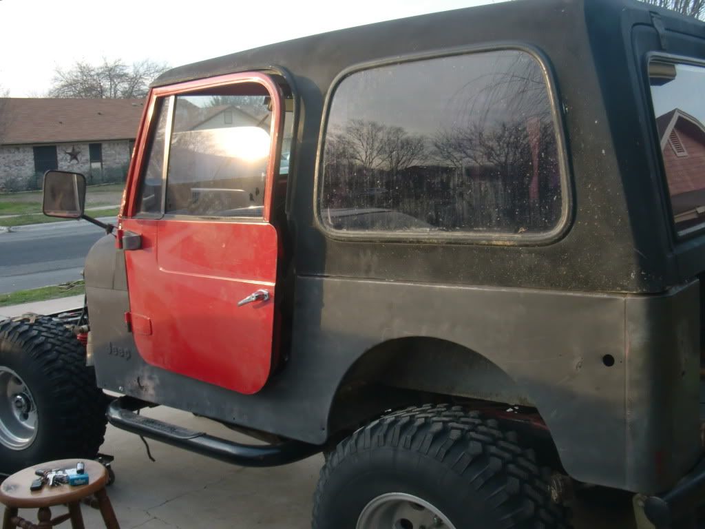

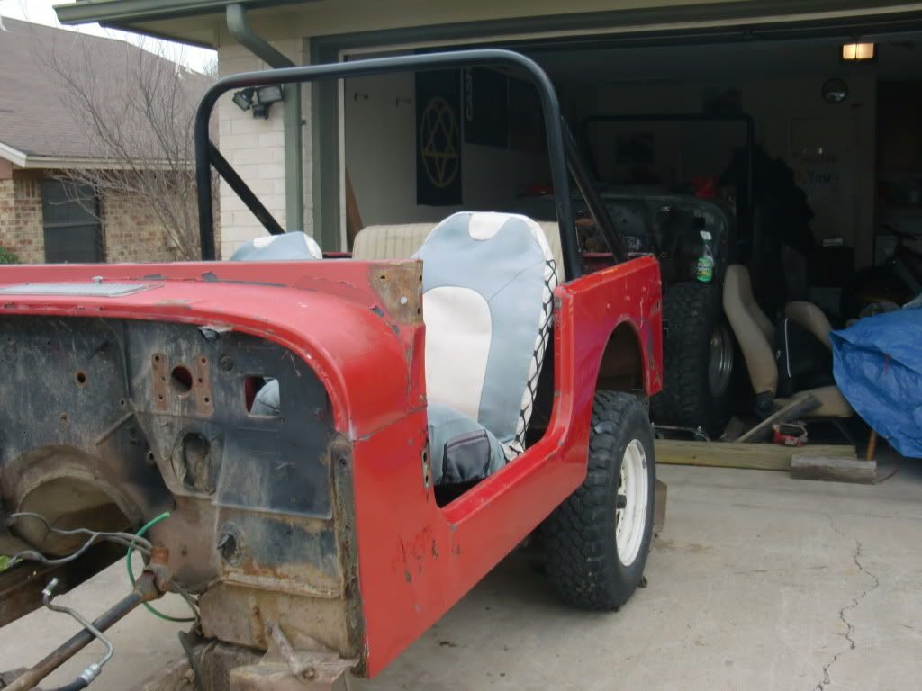

well some buddies came over to help me take off the tub of the red jeep. now going to clean it up.
planning on towing to the car wash to power wash this bad boy.
parts ready and waiting to go back on but got to tackle the frame first.

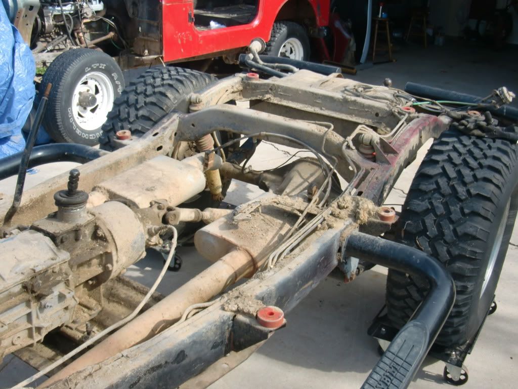

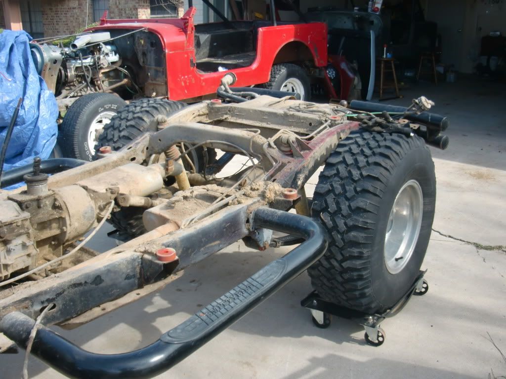

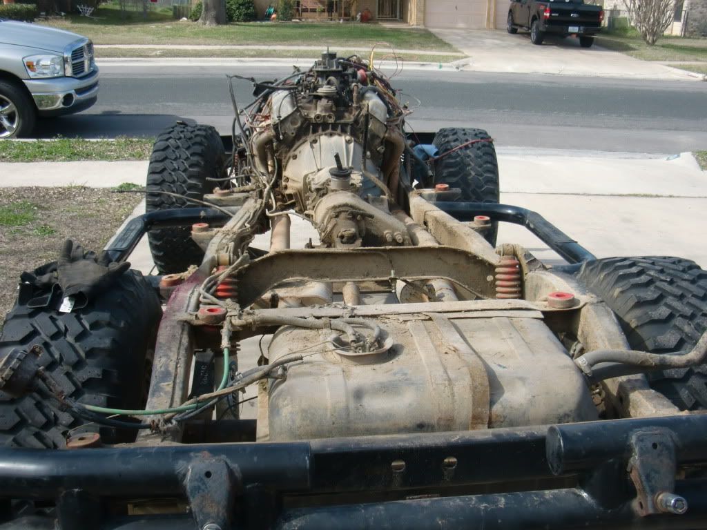

Taking the frame and all to the wash to spray out to see what all needs to get replaced and to think of what im going to get coated. still wondering what to use por or something else or just rhino line the underside

post #25 of 49 Old 02-02-2012, 07:41 PM Thread Starter
maxamillion
1978 CJ7
Location: Eagle River
Posts: 158

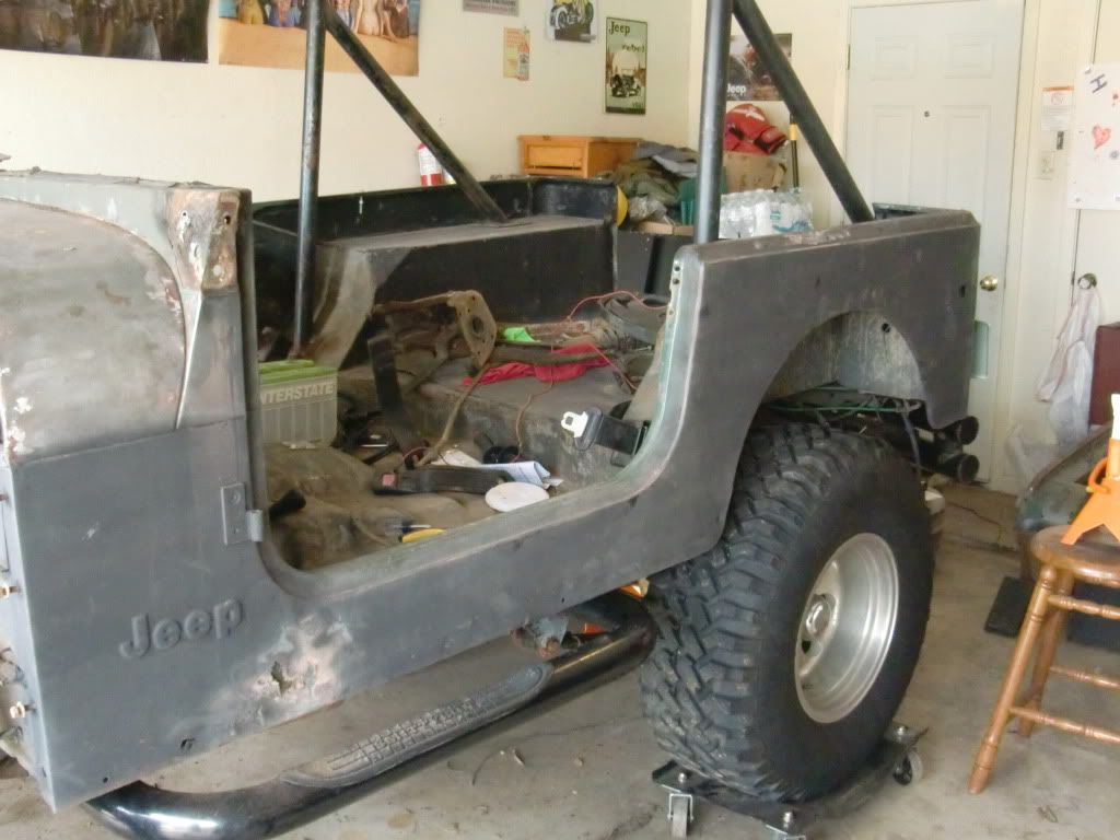

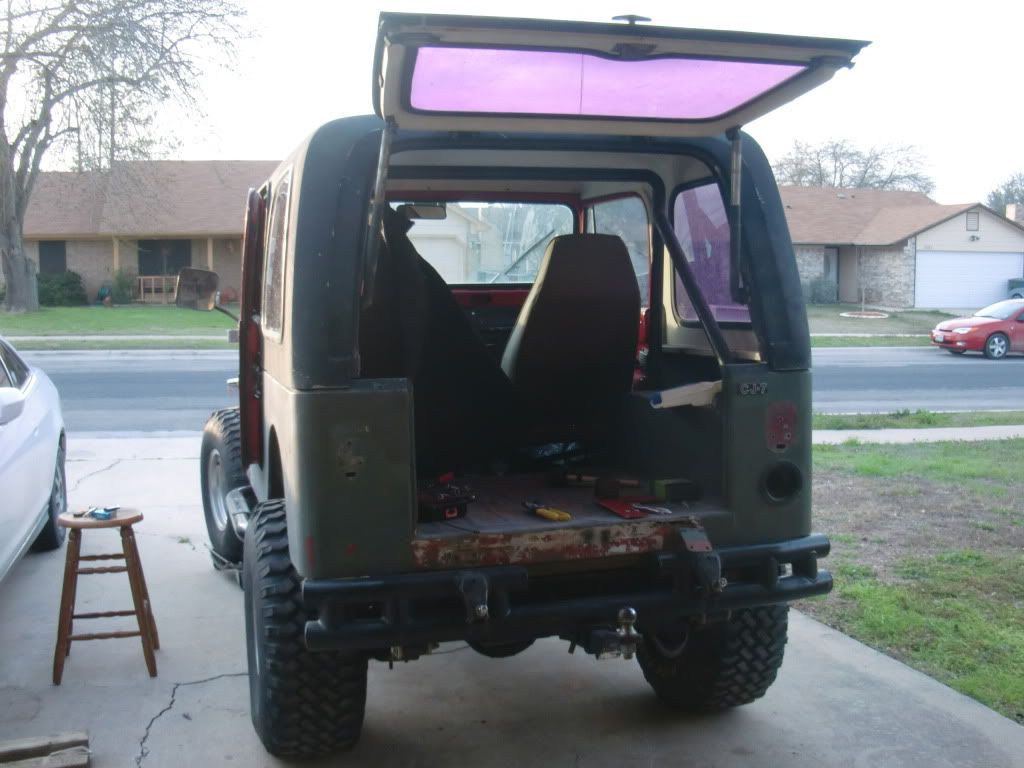

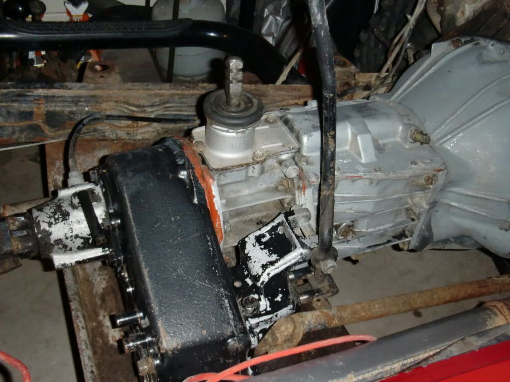

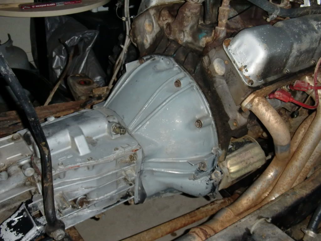

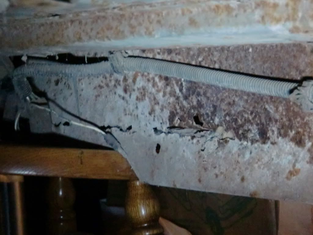

thanks nshefuch. today got under the tub going on and found that need what im guessing is the rear valence. not sure if its the same piece for the tailgate. cleaned up the tranny. thought it came out great. next stripping the engine to clean it up too for paint.

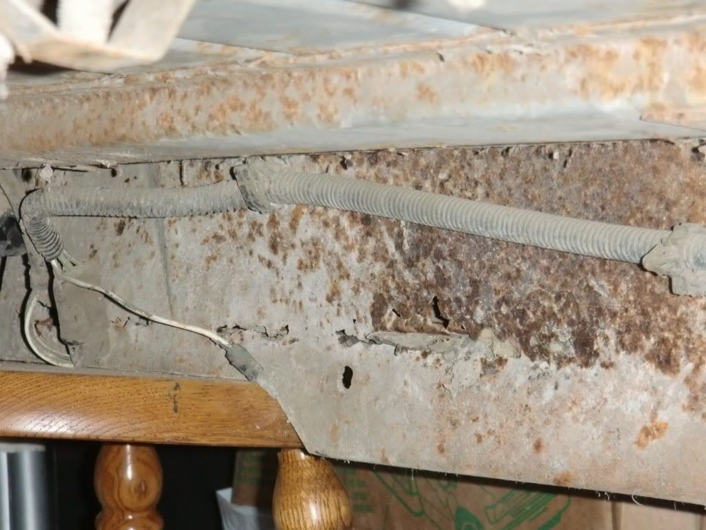

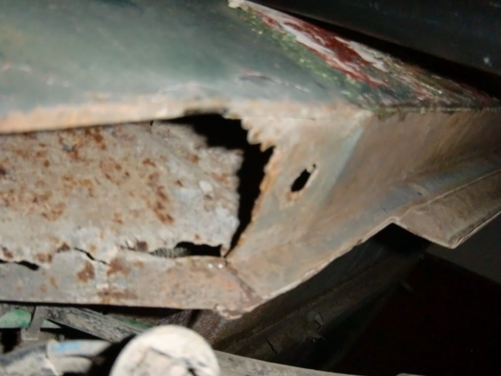

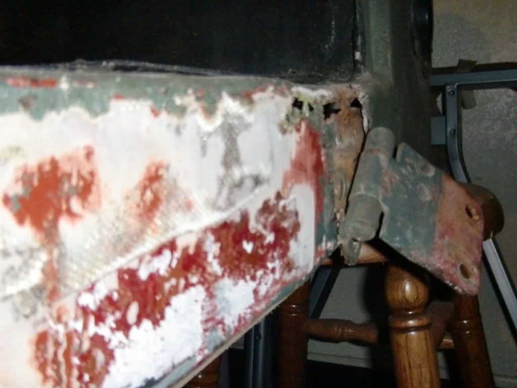

When you start on the rear frame read up on fish plates at all joints when welding new sections of frame on. What you do is butt weld the pieces together and use plates shaped like a diamond and weld over top of the butt welded joints. My photo shows one. I'll post another below

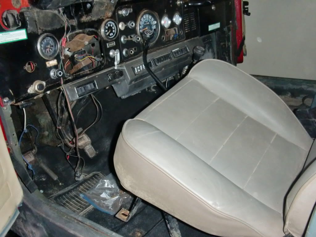

putting the CJ back together
nice fit
time for a new dash and gauges
