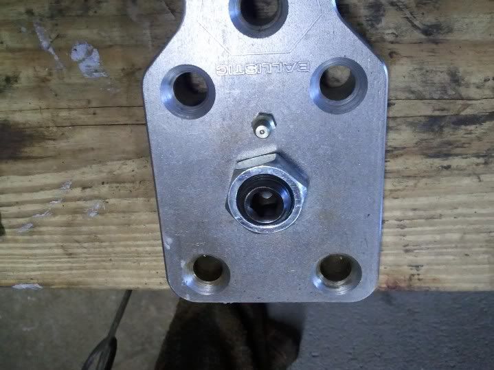

High steer arms installed

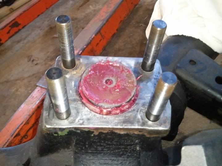

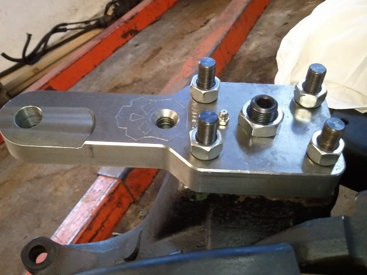

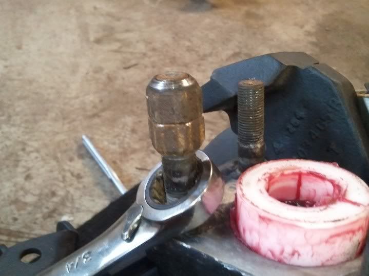

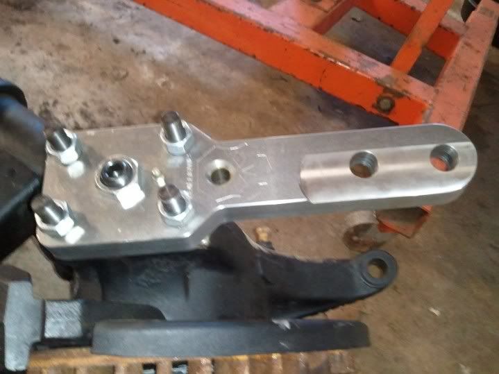

Had a few minutes this morning so I got the high steer arms installed.
Remove the existing studs using 2 nuts:
Install the grease zerk and adjustment nut:
Install the new ARP studs, place the washer on the kingpin bushing:
Tap the driver side arm in place and tighten the nuts:
Tap the passenger side arm in place and tighten the nuts:
I will torque everything to spec after I re-attach the axle to the frame. I should be getting my frame back next weekend.

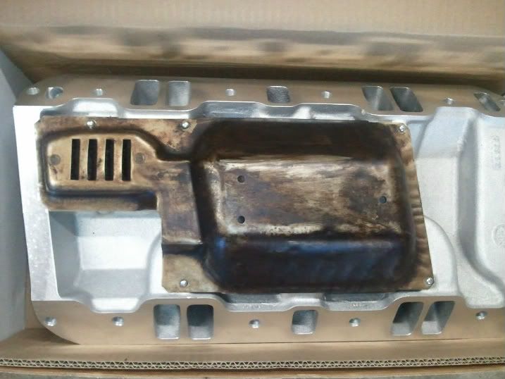

intake manifold
Was planning on getting the intake installed this weekend but my order from totally stainless isn't shipping until early next week. I did get the PCV heat shield removed from the stock manifold, cleaned up, and installed on the new intake:
Some brake cleaner and wire wheel work:
Hammered the heat shield in place with the supplied studs:
When the new bolts arrive I can complete the install...

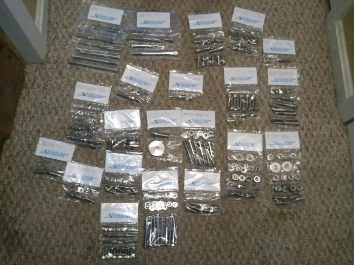

Received a couple more packages this week.
The new u-bolt kit for the dana 60 axle:
The totally stainless bolt kits:
Engine kits:
Body kits:
I don't know if I'll use all of these kits but it's nice having pretty much every bolt, nut, and screw labeled with it's application.

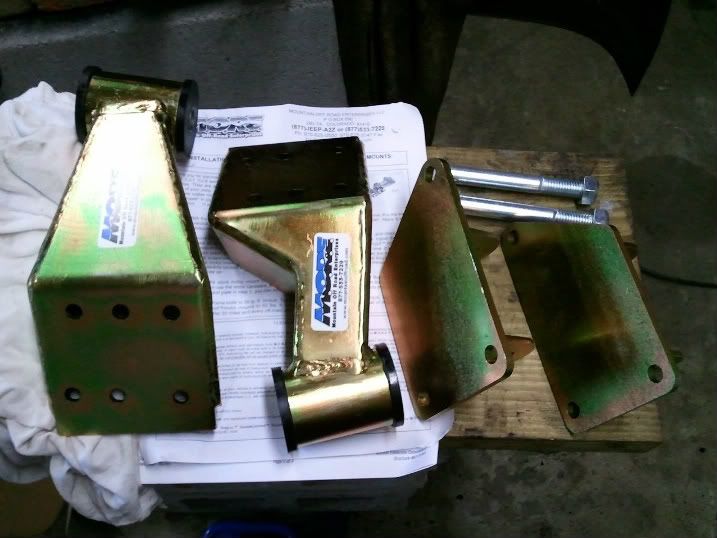

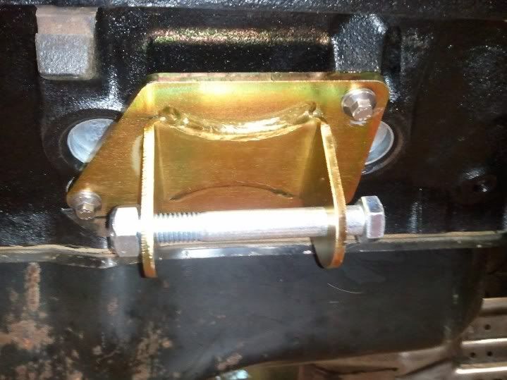

I also had a little time this evening so I installed the engine brackets for the motor mounts.
1) First I hand tightened two of the three bolts to hold the bracket in place.
2) Then I coated the third bolt with anti-seize and hand tightened it.
3) Next I removed the other two bolts one at a time to apply anti-seize and tighten them again.
Here's the finished installation:
Repeat for the other side and it's done.

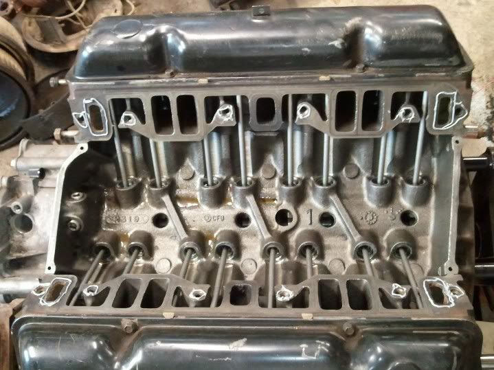

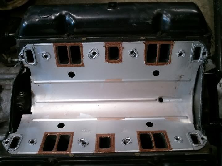

Had just enough free time this weekend to get the edelbrock performer intake installed. Here are the steps I took:
1) First I did a test fit without any gasket/sealants to measure the gap for the two end seals. I won't be using the rubber ones but ultra black instead.
2) Applied several coats of copper gasket spray to each of the intake ports on the metal valley pan gasket. Make sure to get both sides. I used lots of tape to catch the over spray around the water ports and bolt holes.
3) Applied ultra grey to each water port and bolt hole on the block.
4) Installed the valley pan gasket.
5) Applied ultra grey to the water ports and bolt holes on the valley pan gasket.
6) Applied ultra black for the end seals based on measurements in step 1.
7) Installed the intake manifold.
8) Applied anti-seize to the bolts since they were stainless steel and torqued them all to 20 ft-lbs.
Here are the pics I managed to get, not very many since this was a messy process:
Ready for the valley pan gasket install:
Ready for the intake install:
Intake installed:

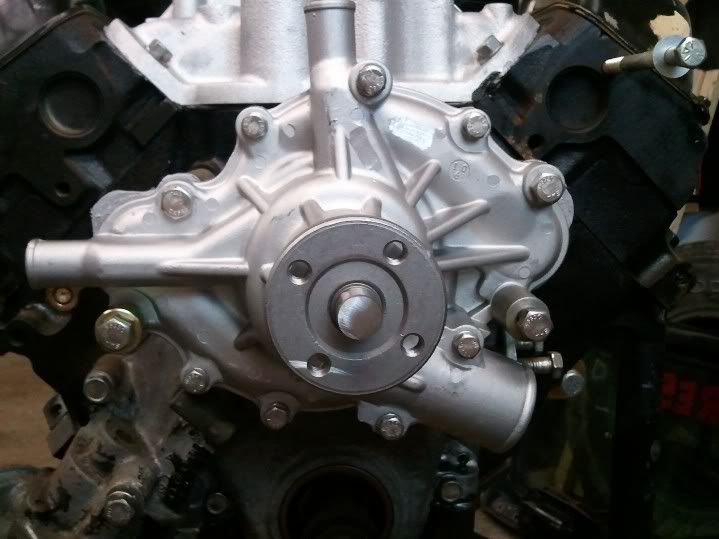

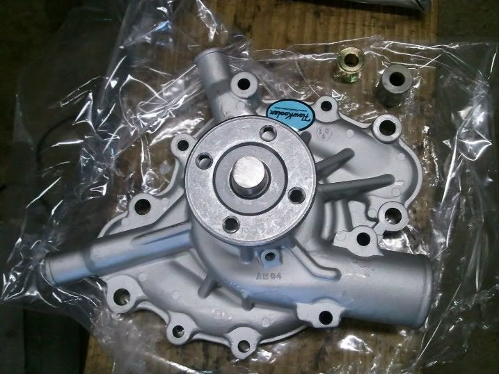

Water pump
Received my new flowkooler water pump today:

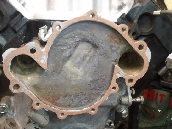

Applied some RTV to the timing cover mating surface and placed the gasket on:
Applied more RTV to the gasket and placed the water pump on:
Used my stainless bolts with anti-seize. I left the four bigger bolts un-torqued until I bolt on all the other engine accessory brackets.

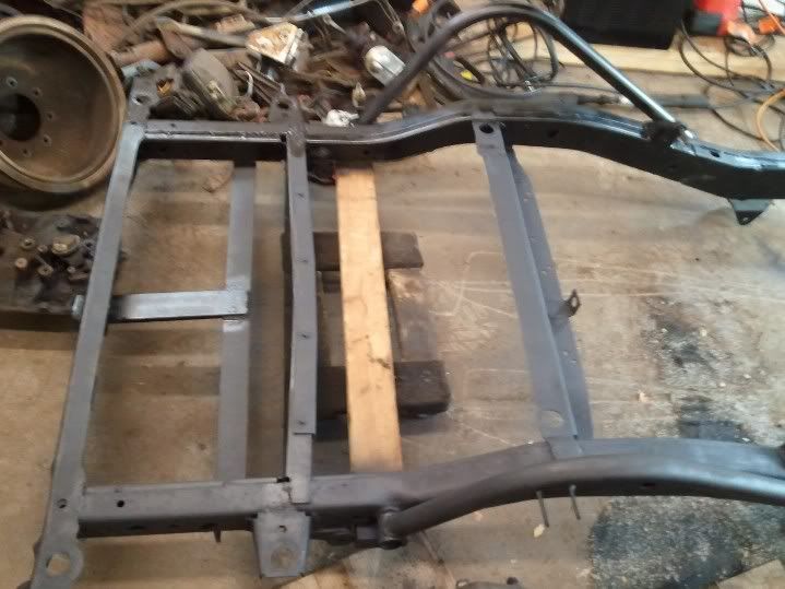

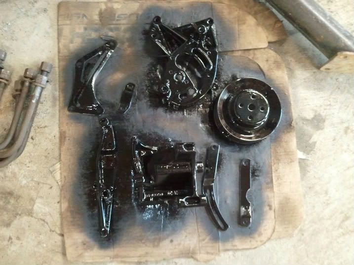

For the last few weeks I've been sanding, priming, and painting parts so nothing much to document.
Engine accessories, some probably won't be used:
Hood in primer:

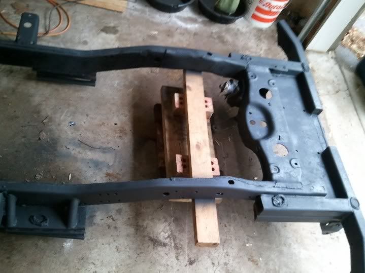

Frame in primer:

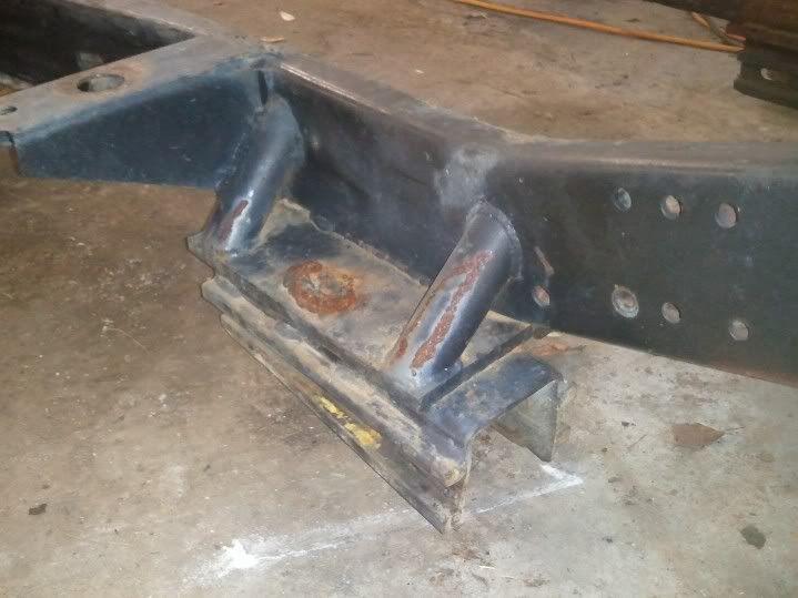

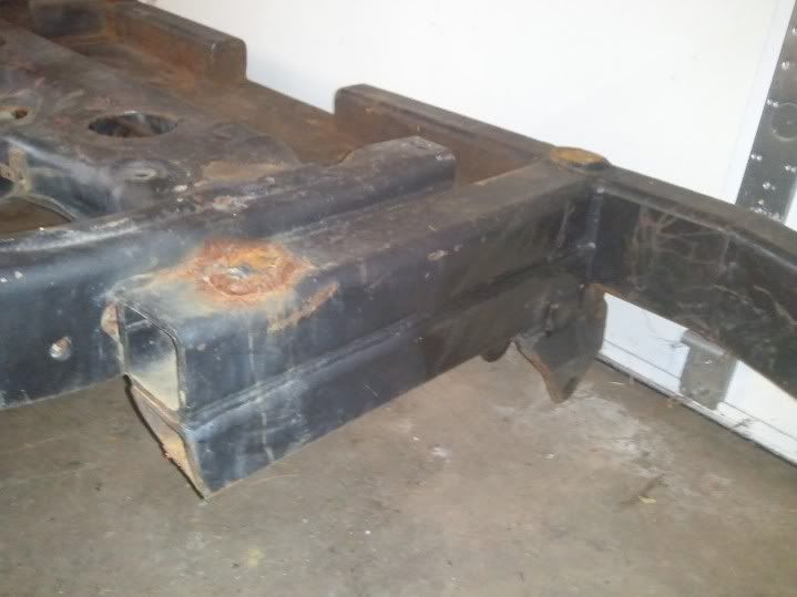

One thing I liked about this frame was the SOA setup. These are before primer and paint.
slider spring hanger:
I'd never heard of slider spring hangers but I'm going to try them out and see how they perform.

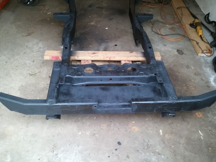

Out-boarded front hangers built in to the bumper:
Winch plate built in to the bumper:

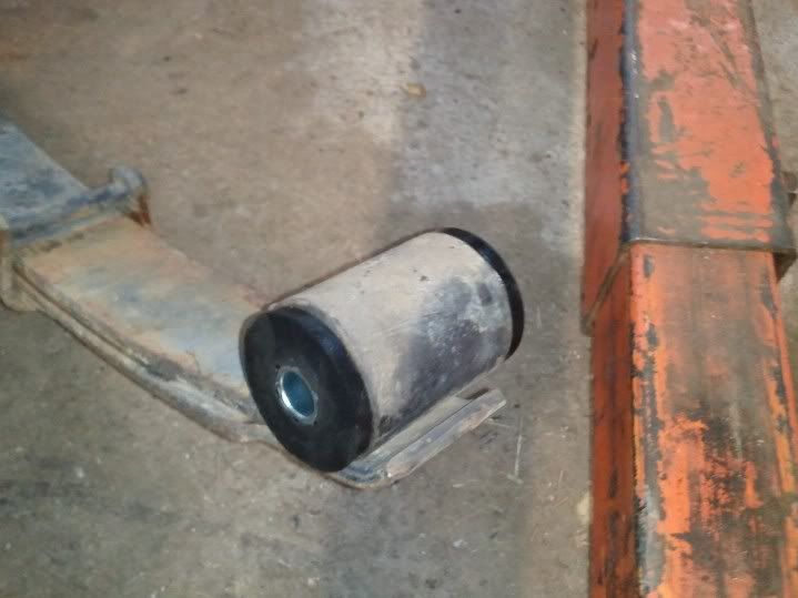

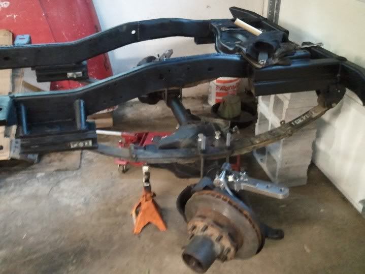

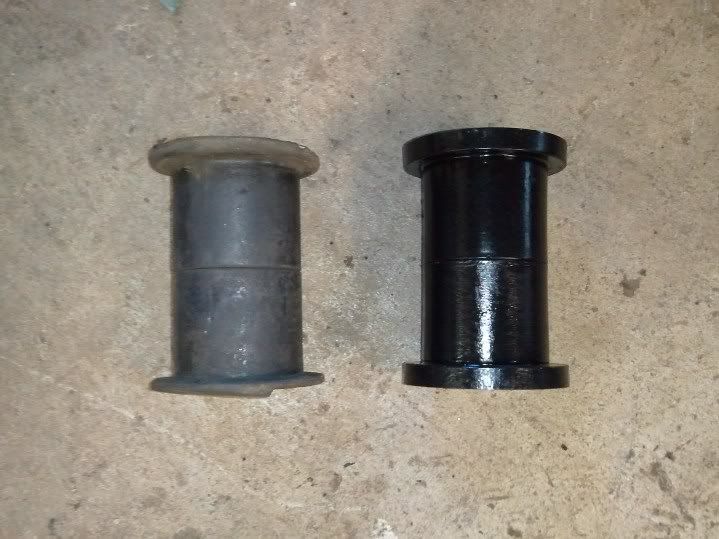

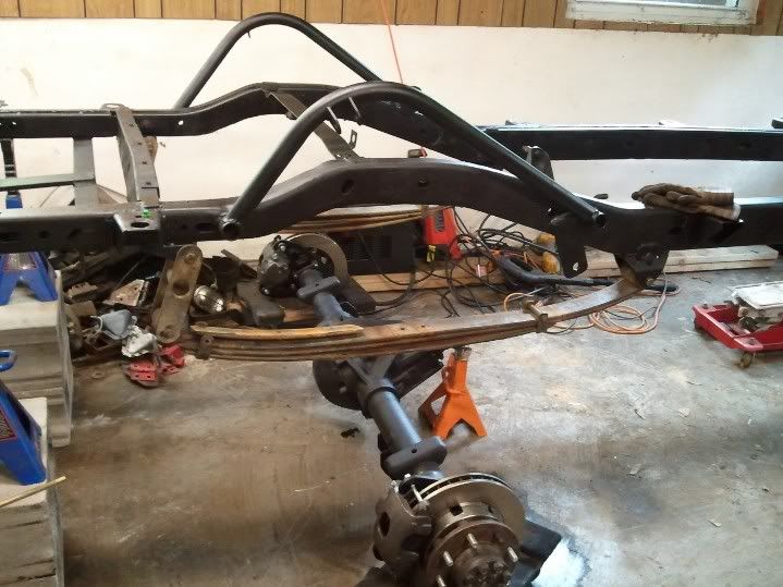

The front axle required a little more work. The bushings needed to be replaced so I pulled the new ones out of my Daystar master bushing set. The front springs I have are actually BDS 3.5 lift YJ springs so I had to use the rear bushings (the front CJ bushings are only 2 inches wide).
New bushing next to old:
Installed in the spring:
Springs and front axle installed:

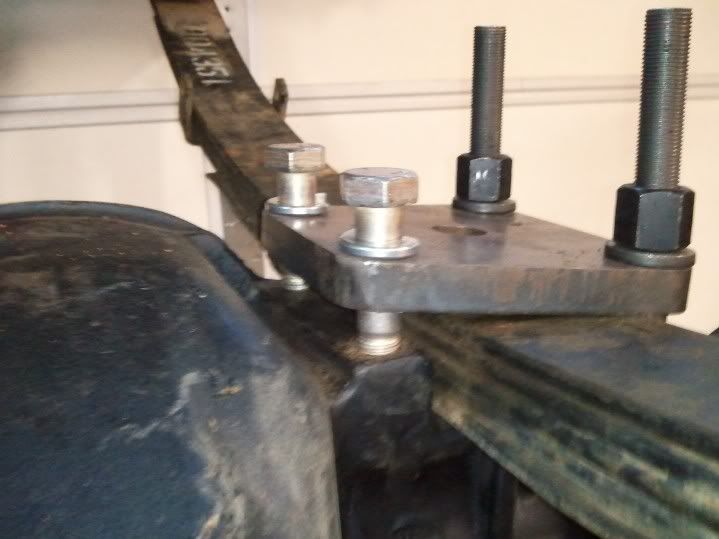

I ran into one small problem though. The spring plate kit I bought for the dana 60 seems to have the wrong size studs for the passenger side spring plate:
I'll just pick up some replacement bolts from the hardware store.

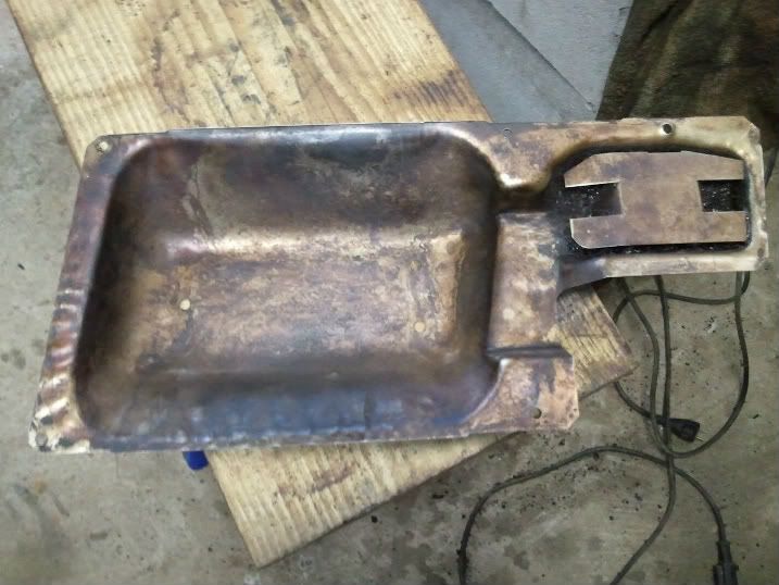

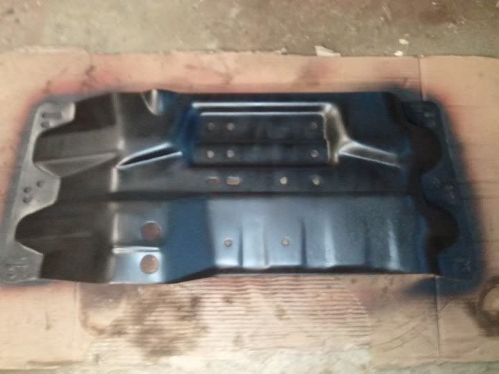

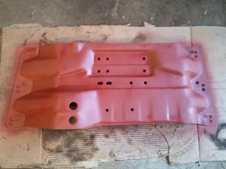

I also primed and painted the t-case skidplate/crossmember:
Since I'll be using an atlas t-case I'll probably end up creating a custom skidplate that doesn't hang as low.
