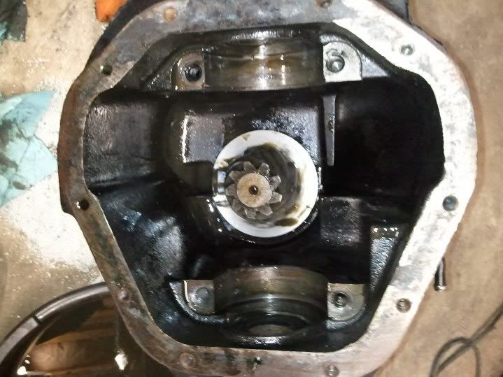

That looks to me like a 10bolt front. Shares the same Outers as a Dana 44 but smaller R&P.

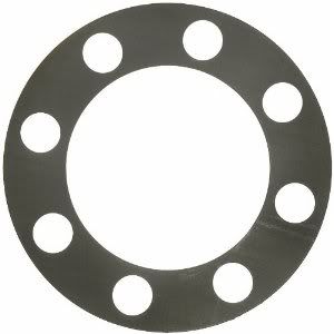

The CUCV manual says to use the gasket but from the factory it does not use one. Right now I'm planning on using both the gasket and RTV.
Here is the gasket, felpro PN 55350:

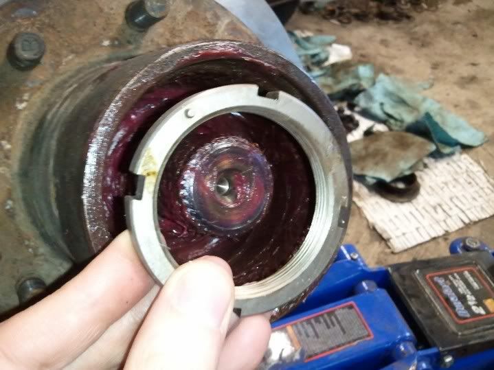

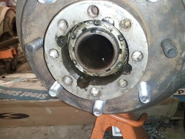

Rear axle spindle nut installation

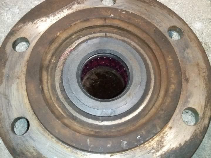

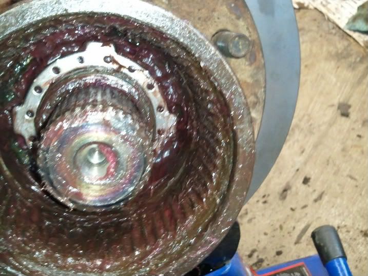

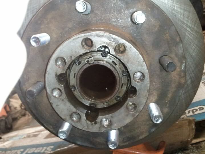

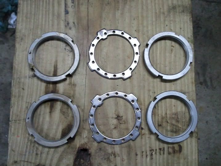

Had a few minutes to work on the jeep tonight: I reinstalled the spindle nuts, keys, and retainer snaprings.
First, install the spindle nut and torque it down to 50 ft-lbs while rotating the hub:
Notice that the slot on the inside of the spindle nut is not lined up with the index on the spindle. I backed off the nut just a bit to line it up:
After that the key slides into the slot to prevent the spindle nut from turning:
Finally, slide the key retainer into place to prevent the key from sliding out:
Repeat on the other side.

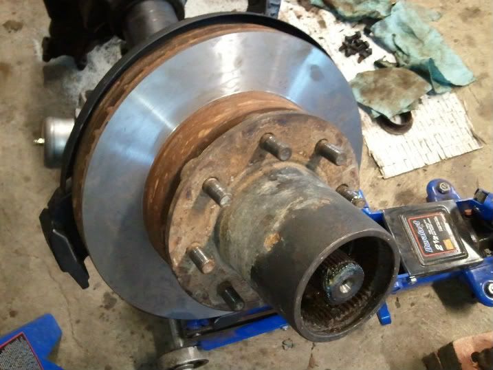

Installed axle shafts and brake calipers

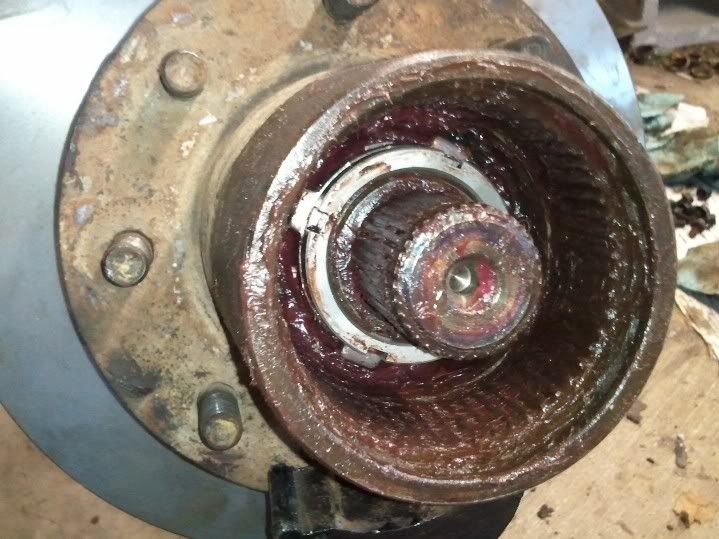

I don't have many new pics since my battery needed charging.
I re-installed the rear axle shafts:

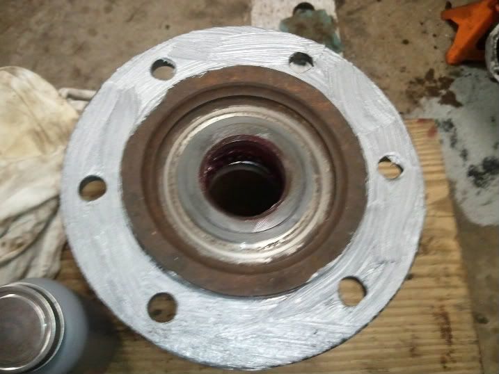

1) First I wire-wheeled the mating surfaces and then used brake cleaner to clean up the axles.

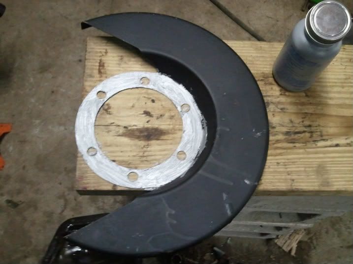

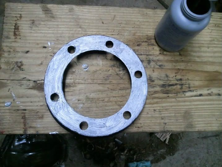

2) I then applied a thin bead of RTV to the hub's mating surface and stuck the gasket on.
3) Next I slid the axle shafts in place and bolted them in place. I will torque them to 115 ft-lbs tomorrow after the RTV fully cures.

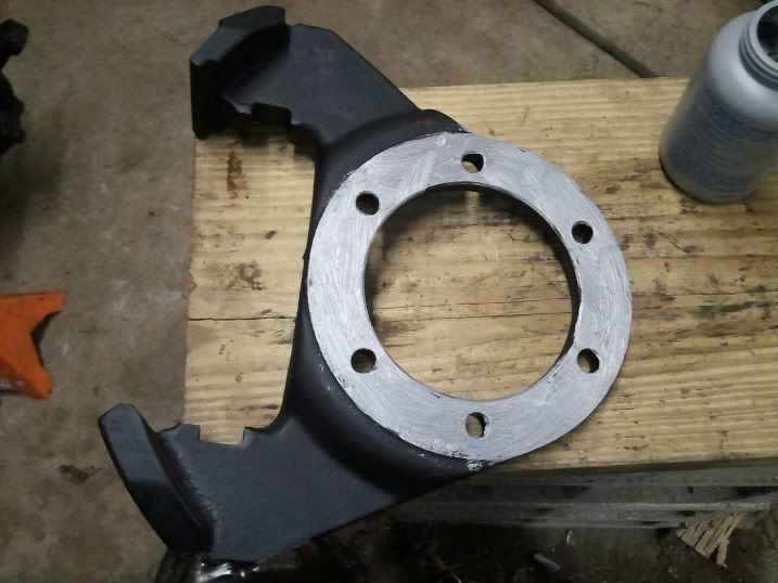

The brake calipers are an easy install:
1) Use a 3/8 hex/allen tool to unbolt the caliper bolts.
2) Place the calipers on the rotor and slide the bolts through the new brackets.
3) Make sure to use the correct caliper on each side, the bleeder screw should be on the top. In the pic below I have a green cap on the bleeder screw.

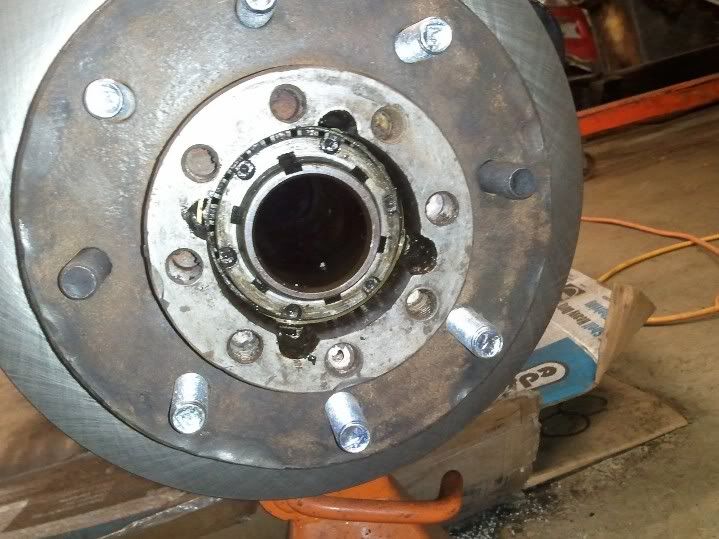

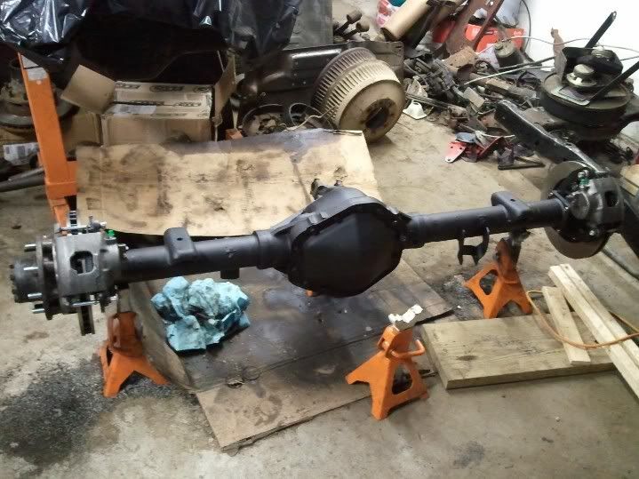

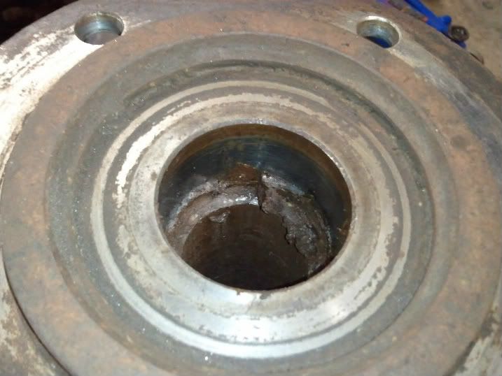

I did manage to get one pic of everything installed:
For reference, here's the rear axle when I first got it:
I think my pinion seal is leaking so I'm going to replace it and while I've got the yoke off I may upgrade it to one that uses ubolts instead of the stock yoke straps.

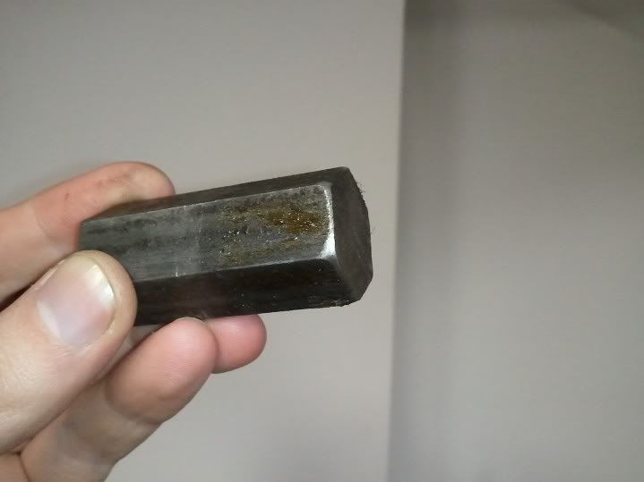

If I can get the kingpins off the front axle without taking it to a shop, I'll start documenting the kingpin rebuild. I borrowed an impact driver that maxes out at 600 ft-lbs of torque so maybe I can get the kingpins removed and the new ones installed. If that doesn't work, I'll put the 3/4 drive ratchet and long pipe on it.
I have a little tool to allow the use of a 7/8 socket on the kingpin:

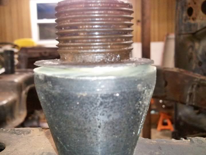

I managed to get the kingpins removed but I had to use a little trick I read about while searching on the subject:
If you take an angle grinder and cut into the kingpin just above where it meets the inner C, it loosens the kingpin up for easy removal. Don't cut all the way through, just a 1/4 inch or so all the way around. After the cutting, I was able to remove them with no effort.
Here's a pic of where I cut mine:

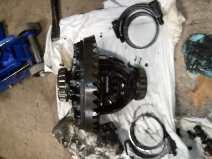

I've got the steering knuckles back on but before I put the axles back in I decided to replace the inner axle seals.

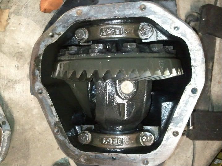

Took the differential cover off:

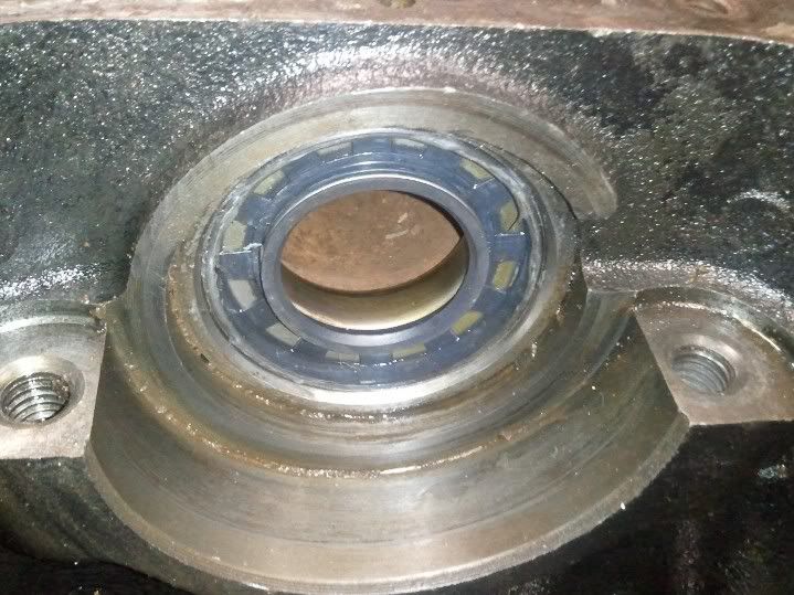

Next I removed the carrier. I loosened the bearing cap bolts but left them in so the carrier wouldn't fall out. I then put a rag into the carrier between the ring gear and housing and turned the yoke by hand until the carrier popped loose.

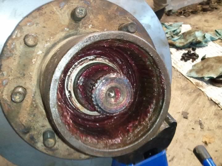

There is a lot of gunk in the axle tubes so I need to get some wire brushes to clean them out.
The seals don't look too bad but since I already had the axle torn down this far it made sense to change them out.

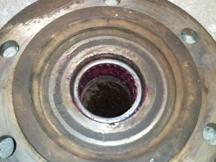

Turns out Advanced Auto does carry a loaner tool that can pull the spindle bearing. They were nice enough to do it in the store so I didn't have to take the tool home!
Here's one of the spindles without the bearing:

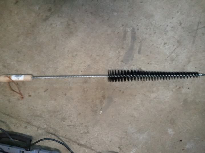

I also stopped by the hardware store looking for some wire brushes to clean out the axle tubes. This was all I could find:
It's a dryer lint cleaning tool. It's nylon so I doubt it will get the tubes as clean as I want but I'll give it a shot.

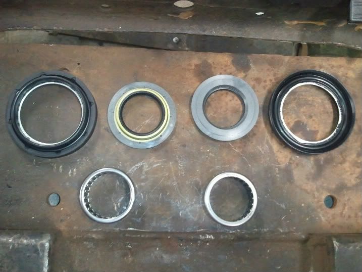

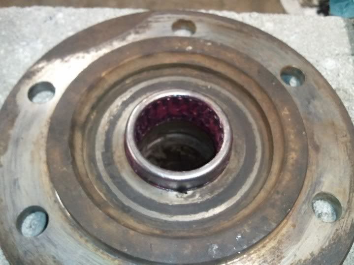

Spindle bearings installed
I got the axle tubes cleaned up and now need to build a tool to install the the new inner seals. I just saw a thread started by Exposed that shows a nice tool he created for the job. ASteve also covers this in his thread which I linked in a previous post. Unfortunately I don't have enough spare parts around to build something so I'll return to the hardware store tomorrow.
New spindle bearing install started:
I used a block of wood and a hammer to start it.
Then I used a socket with the same diameter as the bearing to drive it in the rest of the way:
Next I used the same socket to drive the seal in:
I don't know if I like this new seal/washer combo since it's made of plastic. I may go buy just the seal and re-use my old brass washer instead.

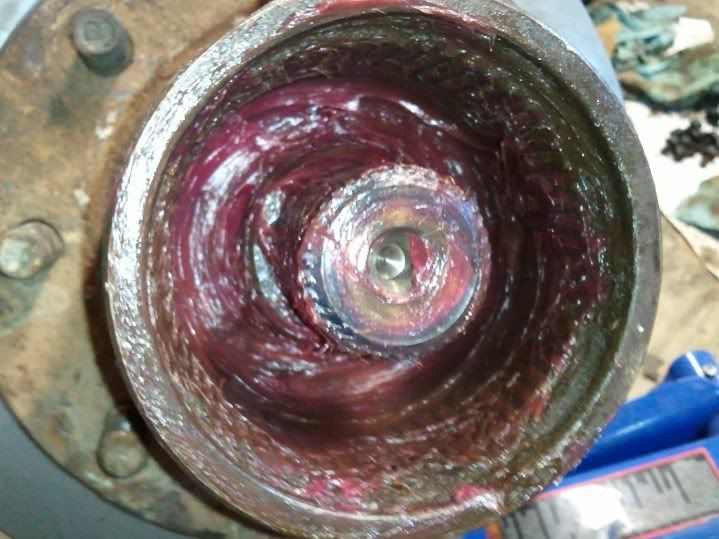

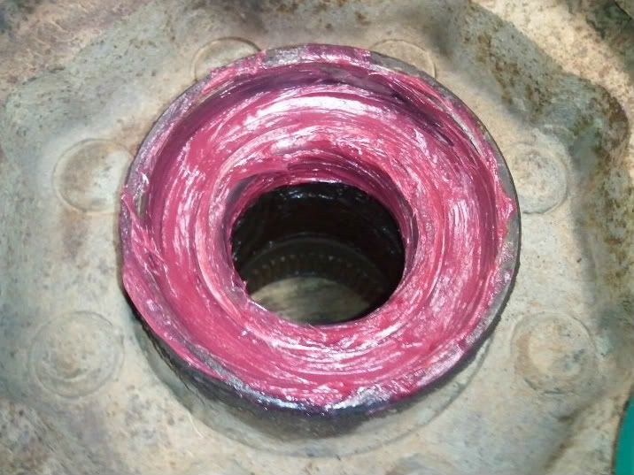

I also installed the inner wheel bearings and hub seals on the front hubs.

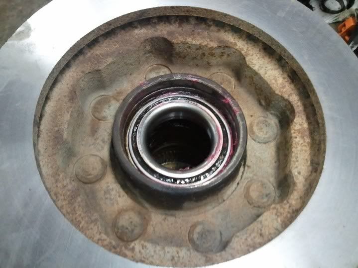

Cleaned up the inner wheel bearing race, greased the bearing and placed it in the race:
Packed the installed bearing with grease:
Installed the hub seal:
For the hub seal I pressed it in place by hand and then lightly tapped it around the edges with a hammer. Same way I did the rear hub seals.

That earlier pic is definitely of a 10 bolt as its got the "ears" on it. Great build so far and awesome detail. For my 14 bolt I have ruff stuff caliper brackets that are curved so no need for spacers.

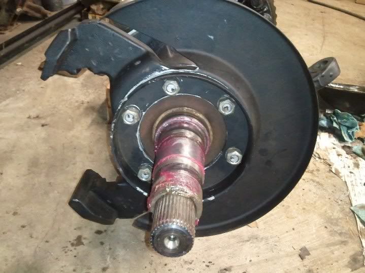

Continued the front axle rebuild...

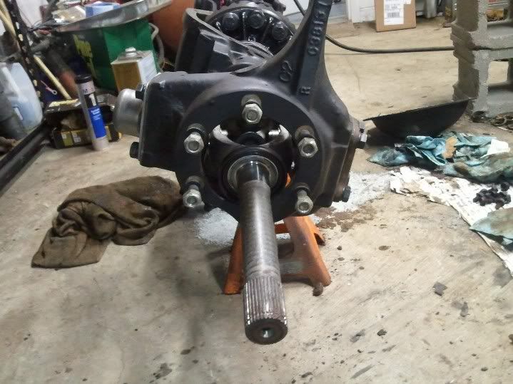

I installed the inner axle seals. I tapped them in using a ball-peen hammer and a socket with the same diameter as the seal, 2.5 inches for the dana 60:
After the seals were installed, I applied some grease to them so the axles can be reinstalled without damaging the seals.
I then reinstalled the carrier and bolted the bearing caps back in. Torque them to 80 ft-lbs.

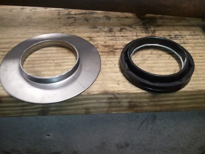

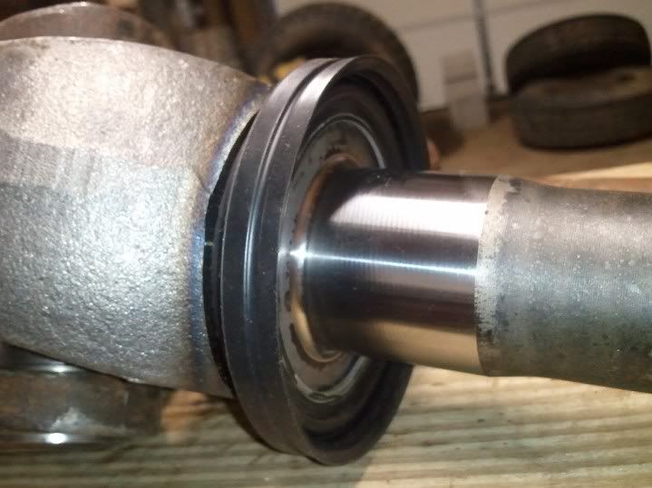

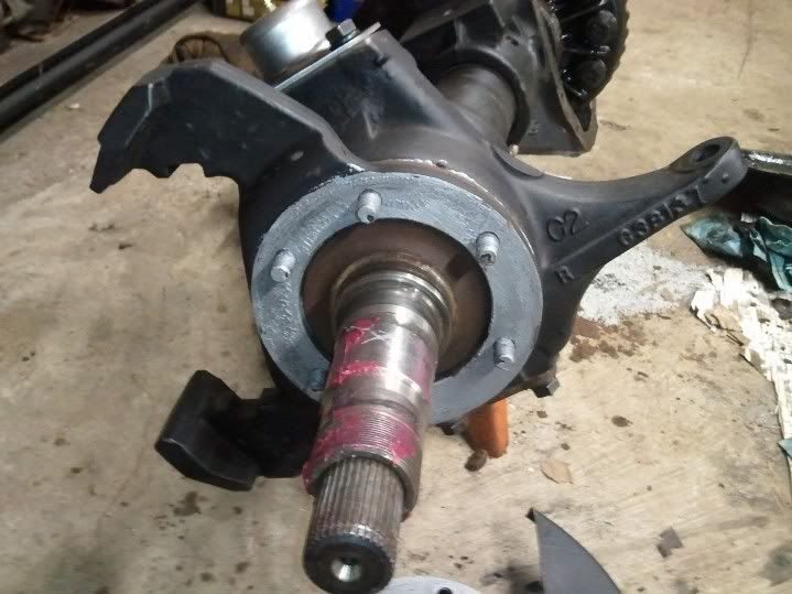

The new spindle bearing kit included a newer type of thrust washer and seal for the outer axle stub:
The original style on the left and the new combo one on the right.
I tapped the seal on to the outer axle:

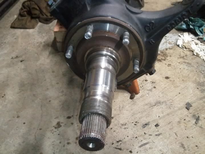

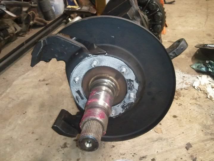

Installed the axle:
Before installing the spindle I greased the bearings and applied some anti-seize to the spindle/knuckle mating surface:
Thanks to ASteve and JeepHammer for the anti-seize idea.
Slid the spindle on to the axle. The bolt holes only align one way so rotate the spindle until it lines up:
I also applied anti-seize to the caliper bracket:
Then slid the caliper bracket on to the spindle:
It's not visible in my pic above but make sure the hole with for the caliper retaining bolt is on the bottom.
I applied anti-seize to the splash shield:
Slid the splash shield on to the caliper bracket:
Applied anti-seize to the spacer bracket:
Slid the bracket on to the splash shield and tightened the locknuts to 32 ft-lbs initially and finally 65 ft-lbs:
That's as far as I got today. I'm hoping to get the hubs installed tomorrow and then the new warn lockouts. I'll probably mount the new calipers as well.

Front wheel hub assembly
I installed the hub/rotor assemblies, outer wheel bearings, and spindle nut assemblies.
I already had the inner wheel bearings and hub seals installed. I cleaned up the inner side of the rotors using some brake cleaner before installed them.
The hub and rotor seated on the spindle:
Grease up the outer wheel bearing and insert it into the hub:
Here is the spindle nut set used by the CUCV dana 60:
You'll need a four-prong 2.5 inch socket to properly tighten the spindle nuts.
The left nut is the inner nut, it has a little peg on one side that must face outward so the lock nut hole can fit over the peg. Torque it to 50 ft-lbs while rotating the hub (to seat the bearing), then back it off a few turns, then torque it back to 50 ft-lbs.
The lock nut also has a tab on the inside that fits into a groove on the spindle so it can only fit one way. You may have to loosen the inner spindle nut to get the peg to line up with the hole on the lock nut:
The peg is in the hole at the 2 o'clock position in the picture above.
Next, install the outer spindle nut, it's the one without a peg on it. The torque spec on this one is 160 ft-lbs which I can't do until I get the axle mounted on the frame.

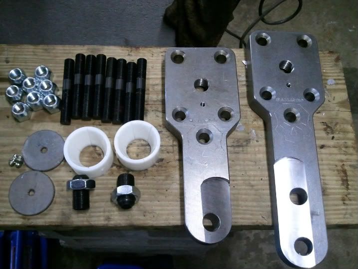

1410 u-bolt style yoke for the 14 bolt axle:
1350 u-bolt style yoke for the dana 60 axle:
Ballistic Fabrication high steer kit:
I still need to pickup some new pinion nuts and a pinion seal for the rear axle but I will have picks of the install coming soon.
