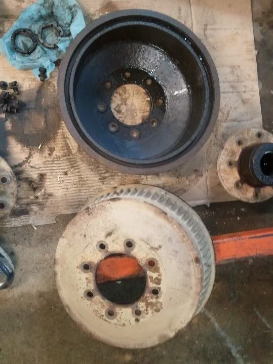

4) Pull the hub/brake drum assembly which is very heavy for this axle. I think it weighs like 50 lbs!
5) The drum brake backing plate is held on by four bolts. I had to remove some of the brake components to get to all of them.
6) Remove the wheel studs to separate the hub from the drum. I used a 3 lb sledge to hammer them out. If you plan on re-using the studs you might want to use a brass drift so you don't damage them. I bought all new studs so I wasn't worried about it.

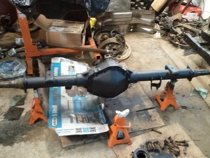

At this point I cleaned the axle, sanded it, and painted it using rustoleum rattle cans. Nothing fancy since it will get scratched on rocks and stuff.
Here is the painted axle:
The spindles have some wear but nothing too bad:
Here are the brake drums:
And the pile of now useless drum brake parts:

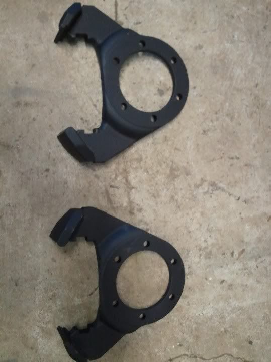

I bought a disc brake conversion kit off ebay.
caliper brackets that mount to the existing backing plate flange:
new rotors and calipers:
I chose not to pay for the extra emergency brake calipers since this will mostly be a trail rig.
Here is one of the brackets mounted:

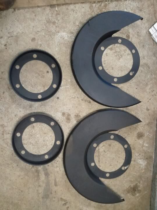

Painted splash guards:
Painted caliper brackets:
