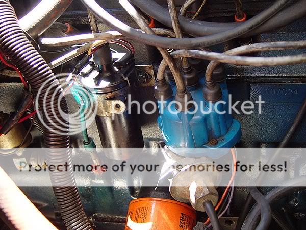

I looked back but could not find what ignition system you have? This is very important. Most of the people have jumped on the low voltage bandwagon. I don't believe this to be the case becuase you have enough voltage to refire the jeep. It takes a lot more to start it than it takes to run it. Something is heating up and failing in the ignition system. Until I find out what system you are running I will make a guess. First when it shuts down touch the coil and see how hot it is. It could also be the ignition module. Both the prestolite and duraspark modules have had problems.

I will take a pic when I return home this evening and post it. I will also check the coil. Thank you for the suggestions.
This isn't mine, but mine looks like this.
