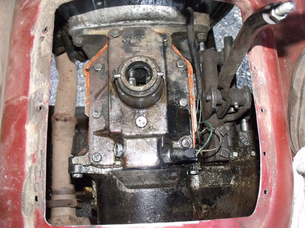

Quick pic to see if you have a T-150 trans.
My trans is doing basically the same thing yours is. I need a new set of syncros to put in there.
