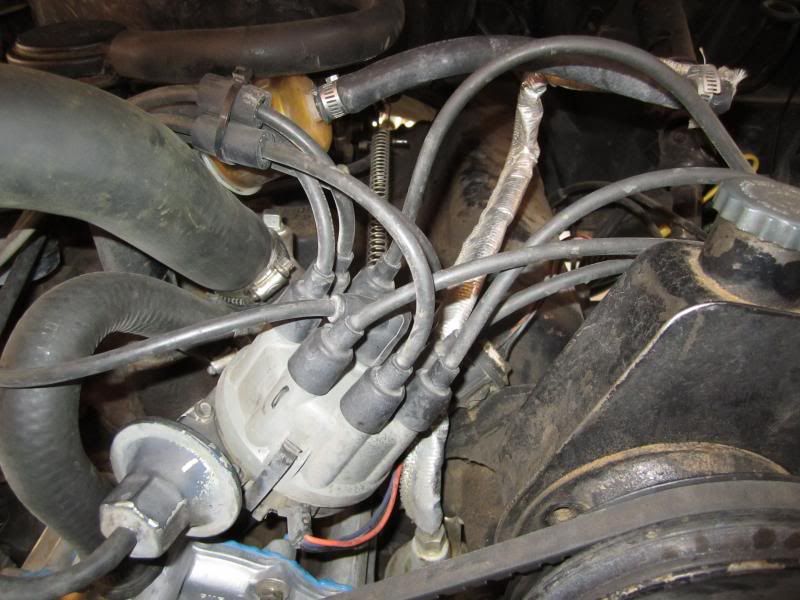

So I went and checked out a few things.... PO must have taken the fuel filter out and replaced with an inline.... PO got me before on other items!!.. I had a thread going and I ended up replacing everything on the front end of the motor due to broken bolts and timing cover held together with RTV.... long story and a lot of money later!!
I took some pics of what he did.... when I replaced the front end of the motor I also replaced the fuel pump and hooked everything back up the way he had it... but after reading on the forum and seeing some pics of what filter should look like . I will have to redo that as well.
I think that is the return line down there?? that I see with no hose on it?? and an inline filter coming from the tank to the fuel pump.
looks like he wrapped some insulation around the fuel line to keep it from getting hot??
does anyone have any pics of the way it should be so I can do it right?? correct routing of fuel line etc...so what I can tell is, he has an inline filter before the fuel pump ( silver filter by open line) then coming out of the top of the fuel pump he has another inline filter before the carb with insulation wrapped on the line... I am thinking this is my issue??

i have had exactly the same and it turned out to be a split hose in the fuel supply line above the tank.
As you nose up the pump has to suck harder and more air gets in.
The way to check is to put in a short length of clear hose and look for large bubbles.

so should I leave that section of metal fuel line going to the carb and just replace the correct filter with the one that is there, and run rubber fuel line all the way back to the metal return line??
I think that is the return line ?? I will have to get under there and trace it back.
