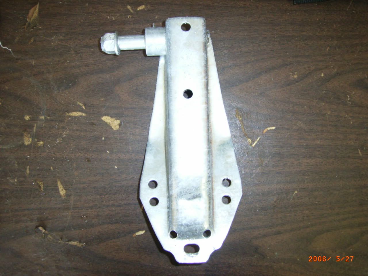

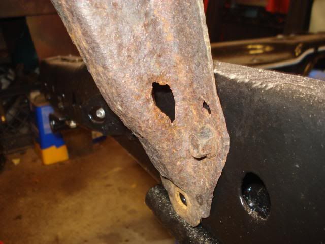

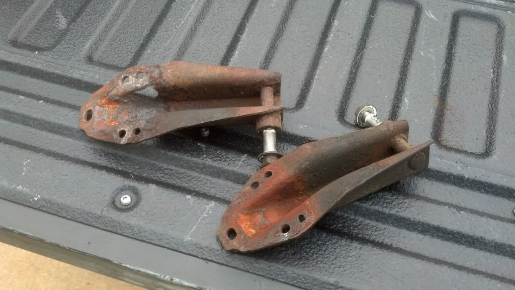

You might be able to see in this picture how the old shock towers on my 83 CJ7 rusted at the bottom. It does not surprise me that they did rust due to the design. The back of them leaves an open spot for anything to get in and stay. Almost like a bowl or cup.
I have newer mounts now (used but new to me) which are the same design. I want to see if any of you have any recommendations on how to full or plug the back of the towers. I was thinking of bondo or welding a plate over it. What are your thoughts?

Either drill a drain hole in the bottom of the tower to let the junk out or weld a plate over the back side.

Hate to say, but the only real permanent way to repair the holes is to either fill in with welds, and or weld in small plates. Mine were about the same shape as yours. I chose to fill in the various holes with welds, then ground the outside flush.
You may be able to JB Weld (Epoxy) in the holes by leaving the epoxy thicker on the inside and extending out about a 1/2" beyond the hole. Sand the outside flush to make it pretty. This after removing all rust (sand blasting recommended). Bondo/caulk probably not so good.
Also as mentioned - drill about a 3/8" diameter hole at the lowest point to allow water to drain. This should have been done from the factory.

Water will find it's way eventually in there even if you plug it up. Instead of keeping stuff out, give it somewhere to go and just drill a hole. Stick the hose back there every once in a while and flush everything out.
