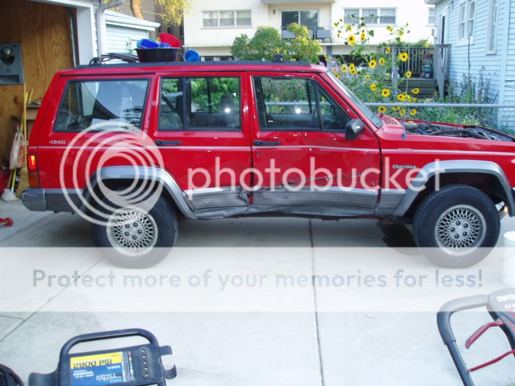

Picked up a 95 Cherokee for $350. Engine compression at 150PSI on all cylinders. 99k miles. Runs great. AX-15 and 231 transfer case. Vehicle was totaled and the price was right. Purchased for engine swap into the CJ.
I'll part out what little is usable.

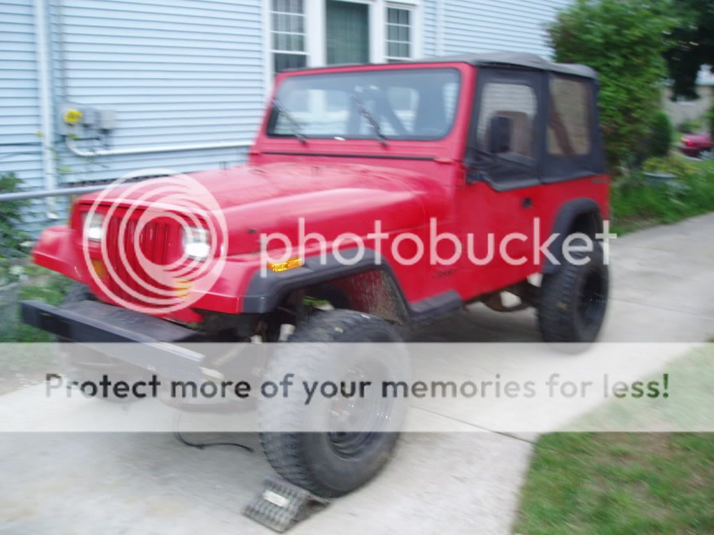

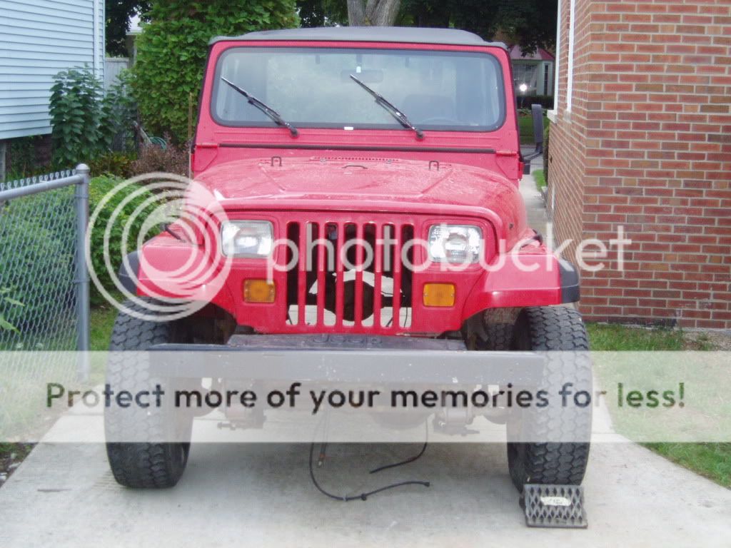

Also picked up an 89 YJ, less drivetrain. It's originally from TX and there is VERY little rust. Nothing more than surface and that's on the frame. I've been looking for a good tub for over 2 years. The frame is clean. No rust on the inside of the frame at all, from what I see. Even the rear cross member looks great. It has other misc. parts I could swap, as well.

Put the CJ front clip and dash on the YJ. Only a little work needed to do that. Bolt the 4.0L and harness from the XJ into the YJ. D300 from the CJ will need a clocking ring to work in the YJ because the CJ front is passenger-drop.
Then, you will have the classic looks of a CJ with the stronger frame and wider springs from the YJ and the power from the venerable 4.0L.
Can be done in a couple of weekends. Part everything else out.

Yeah put the front clip of the CJ on the YJ, front fenders, hood and grille and you basically got a YJ7, nobody will be able to tell the difference unless you want them to.

No room to store a trailer and the rear end is trashed. Looks like the pinion bearing let go and the pinion nut backed off. I also don't have the energy or the cash for another project. I paid $1600 for the YJ, which included him trailering it 50 miles to drop it off. In this area, that is a very fair price and the guy was very easy to deal with. I'm happy with it. For what I would have paid to blast the CJ tub and the number of my labor hours to weld up all the holes, I think it's justified.
