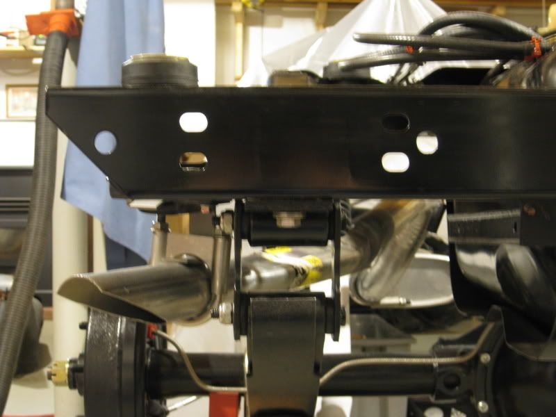

You need to get the exhaust pipes out the back corners just behind the rear wheels or that smell and dangerous CO2 is gonna kill you and your family. It is the ideal spot to route exhaust and it's what the factory does also. Also, it's a good idea to angle cut the very end of the tailpipe tip reduce vortex and pulsing rings of exhaust

Originally Posted by coolhandx1 View Post
In regards to the angle cut, slight angle to the rear?
Something like this:

Jeep put them in the right place, coming out on a 45 between the frame and spring at the back with a chopped tip angled down/out. I just put an OEM system on mine. This makes for the best smell.
