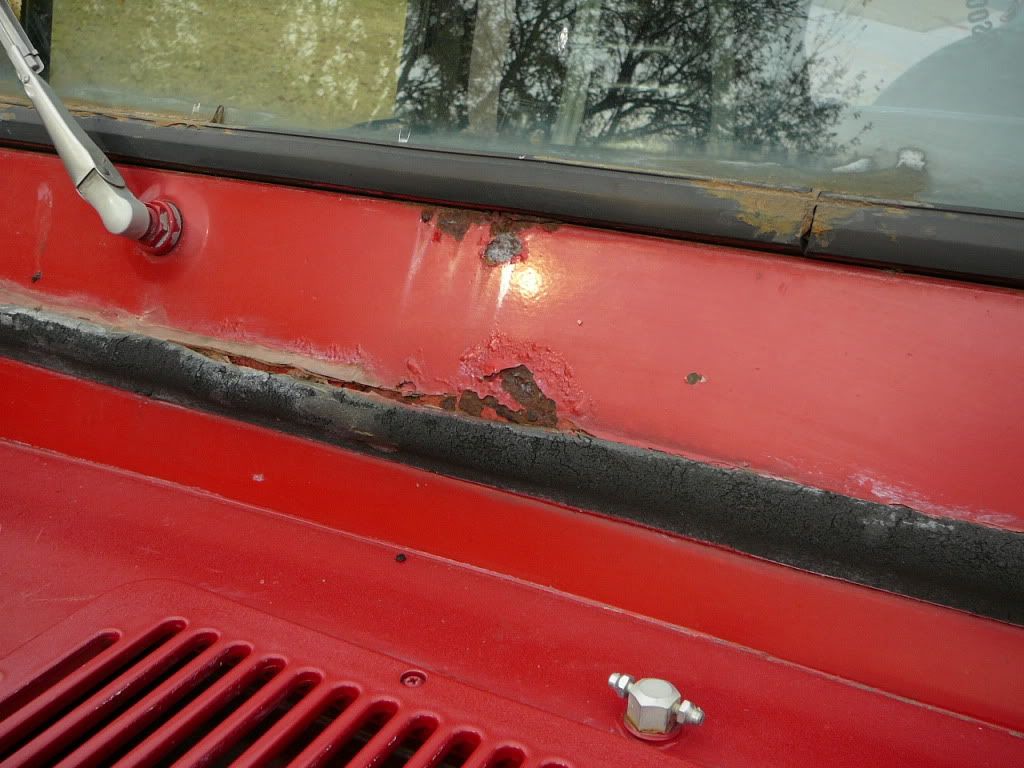

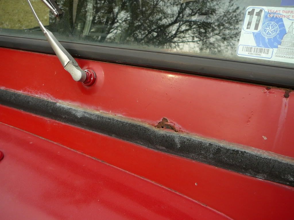

Some rot in a couple spots under the windshield and at the windshield seal.

As for any rust grind it off, if it goes through, then cut, patch and weld.
