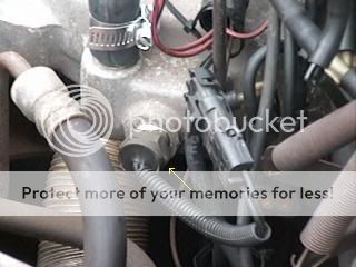

Hi guy's,
I have a quick question and I'm not sure this is where I should ask it but... does the Coolant Temperature Switch do anything once the nutter bypass is preformed?
This is the switch I'm talking about.
'89, 4.2, NUTTERED, Team Rush, 4" lift, 1"BL, 1"MML, Flat belly skid, SYE, CV Driveshaft,
35 x 12.50s, XRC8, 150w KC's, Herculined, Tauras Elec Fan, Dual Batteries, 1" shackles & Soft Top for the summer, TJ flares.
Mr-Rock is offline   Reply With Quote

Originally Posted by Mr-Rock View Post
Hi guy's,
Once the engine is nuttered and the computer is disconnected / removed it does nothing. When the computer is installed it feeds information to the computer. Once you remove the old wiring harrness you will find the wires from it leading to the plug at the computer. Here is a good link if you do not already have it. What Controls What
If you are already nuttered you should look in to removing the old wiring from the computer. I pulled mine about a month ago and was really amazed at the amount of wire I was able to remove. When I did it I also repalced the old black plastic wire conduit with some new conduit from auto zone. Be carefull when you start pulling the wire your reverse lights are mixed in with some of the old computer wiring. I cut my harness were it comes through the firewall at the computer, removed all the black wire conduit and tape and pulled each wire out one at a time. Took less that a hour, including reinstalling the conduit and looks nice.
