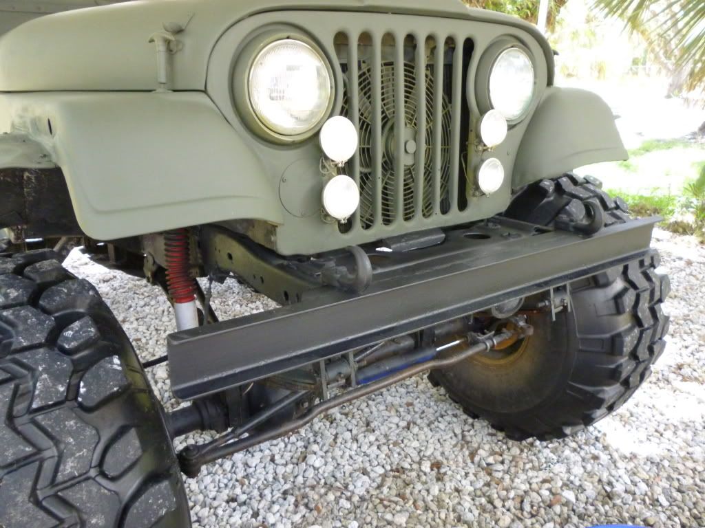

I need a winch for my 78 CJ7 it has 44 inch super swampers and in the mud a lot. I hunt in South Florida and we are wet 1/2 the year. I will not submerge it too many times but it will get plenty wet.
So what weight winch? and any suggestions on a winch? I know warns are the best but ???? are they worth it??
Here is my jeep: How do you guys think it weighs?
Do yall think I can mount the winch directly to the bumper? or should I buy a mount?
thanks for the advice

Bolt a 16k right on top of the bumper and call it a day.

A 16k winch with a snatch block will pull 32k. That is big but the mud may play a part. The warn xd series has a good reputation and has fast no-load line speed. The new Zeons look good and have good specs but have not been out long. I run a xd9000i and it is plenty for me and to help other heavier vehicles. Get a good mount or make one at least 1/4"

If youve got 1500 to play with grab a 12,000 or more warn. If your looking a lil less and dont plan on being a warn snob There are many other options in the 500 to 750 range. Either way stay with at least 12,000lb if you get stuck in those tires it will be nasty, however you dont have a gigantic one ton truck either so 16k may be more than you will ever need. You will need to think about recover gear though, snatch block, line extensions, extra straps and shackles. The only place I see that getting stuck is in an open area, so being able to reach a tree is something you'll need. As far as mounting That is a nice flat surface on your bumper, but you also need room for a fairlead. So I would suggest making a nice heavy plate, out of 1/4 or 3/8 steel that can be bolted down to your frame. I dont really like the looks of most name brand winch plates. They look flimsy to me. That and $100 for $5 of steel. Awesome jeep by the way, just go easy on those axles, 44s axles are beefy buy 44 tires are monsters.

Is there a gravel yard or anything near you? Weigh it, sometimes they charge $5 or something small like that, but then you'd know. And don't forget to figure in cargo weight. Then I hear to take your vehicle's weight and go X3 with it. I'm looking for either an 8274 or a 9k winch or bigger. Would love the 8274 for the style - they just 'fit' the CJ, but otherwise I want to go overkill with the winch. I like the margin of safety.

This is the way to go. Figure out your gross weight first, and with mud figure on tripling it. THAT'S YOUR MINIMUM sized winch needed. Mud does amazing things, but the worst is it creates a vacuum that's hard to break when pulling the Jeep out of the mud. Remember too that a winch is rated at the bottom cable wrap next to the drum. each wrap lessens the power of the winch.
Make sure you have a decent recovery kit with at least a couple of snatch blocks (more is better) and slings. With the right sized winch and a decent recovery kit, you can do anything.
