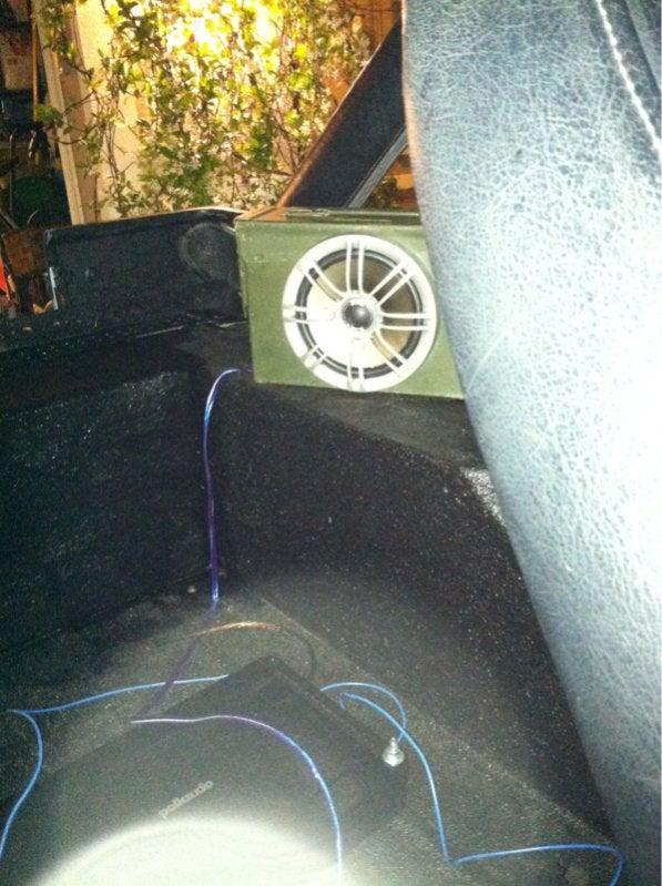

Awesome thinking and production. I did almost the same thing for mine. I used Polk marine speakers in ammo cans for the security, weatherproof, and look to go along with my Army theme. I also used the same spanner screws! Great minds think alike! The boxes are all bolted from underneath the body with carriage bolts (no head to grab) and have the same bar going across the inside bottom of the can with the bolts going through. Cans are tack welded shut so no getting inside.
The fronts I used the retail box but same bolting security
The fronts are 5.25 and the tears are 6.5. The sub is a 10" also Polk marine grade and in a MDF box which I covered in fiberglass an rolled with bed liner. You can see the added angle iron for security and it is bolted same style to both the angle iron and wheel well.

Hope I didn't invade on your thread. Kind of feels like it. I just get excited over seeing someone thinking along the same lines. And your title is perfect, it does make it more awesome!

No invasion at all. This thread has been dead for 5 or 6 months, so it's pretty cool to see it return from the grave and roll a bit.
Your ideas and theft proof designs are awesome! Ammo cans and jeeps are built to be together! very nice work man!
