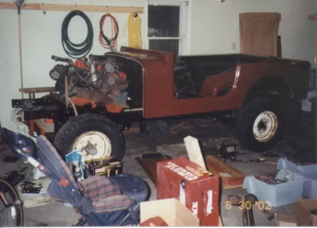

Where do I begin.. This is what I did and would never do it again. Was shopping for a CJ7 and up here in WI they are SCARCE. The ones I found I thought were too much money so along comes my Jeep in pieces. The guy began a restoration and got as far as disassembly and sandblasting/painting everything. He had bought the fiberglass tub, but there were not 2 pieces bolted together. "A great father/son project" I thought so 3 trucks and 2 trailers later this pile of parts is sitting in my garage. Since I didn't know how anything came apart I did not know which parts to bolt together. The first thing I did was buy an OEM service manual. It is 3 parts and was quite helpful, but even that did not show every part or how it gets bolted on. This forum was probably the most help of all. Also I have a relative with a junker (that he wouldn't sell me) that I could use as a reference. I took pictures and measurments of everything.
I did learn every piece of a CJ and what it's function was (well nearly every). But many things I did 4 or 5 times over because I simply didn't know and didn't do it right the first time. The project became an obstacle in my garage for 3 years and I am fortunate(I think) that I am still married since my wife had to scrape snow off windows for 2 complete winters when there was a perfectly good 2 car garage out back that was occupied. Also the honey-do list did not budge as I was hibernating out in the shop every night. And the sons that were supposed to help got bored with the project really quick and it became the family punchline at get-togethers.
All said and done, it was a great learning experience and knowing what I know now, I could easily complete it in less than half the time. Again my biggest problem was recognizing a good part from bad, what is repairable, and what should just be replaced. I would spend a week cleaning a part and then put it in only to find out later is was shot and had to be replaced with a new one anyway. I went way over budget and plans changed many times throughout so I would buy something, not use it, then sell it on e-bay for a loss.
Now I am not discouraging you from an ambitious undertaking, merely trying to help you see into the future and what lies ahead. Your family situation may be different and if you have the time and space, it is a great learning experience. But you need deep pockets. You can get a fairly decent CJ in parts of the country for around the $6k range and it is done. The one I first looked at was $5,500 and I thought that was too high. I stopped keeping track but I am well over that and had to do all the labor myself. Good luck on whatever you decide.
