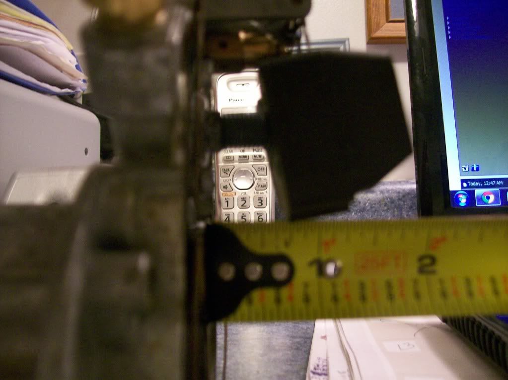

Stick with the 18mm and not my pic. I forgot to mention that in my post. I just wanted to make sure you held the top of the carb correctly when you measured it. Good catch and good luck

I think the float level is good. You will see a little pen mark on the measure, thats 18mm.

Yep, damn. Keep digging, buddy. You'll find it.
