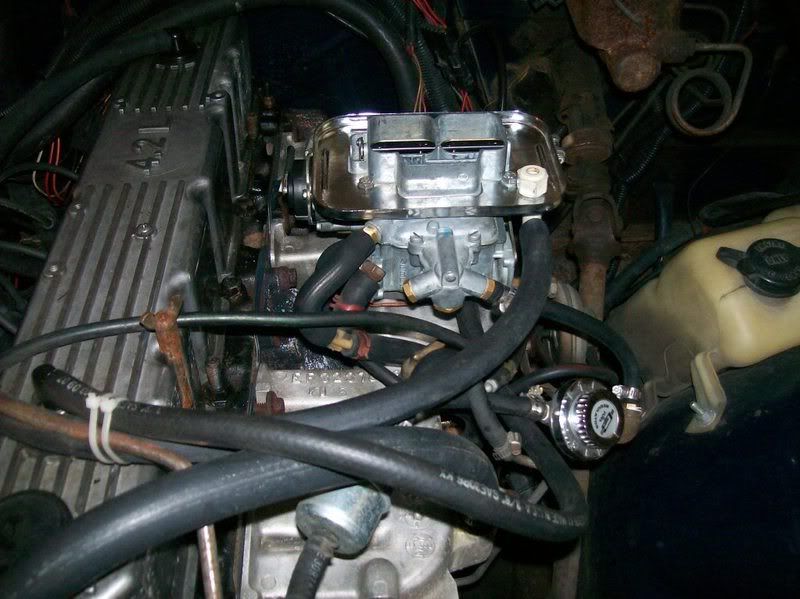

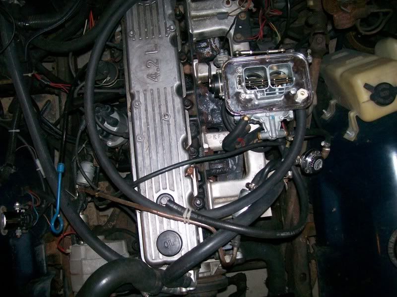

Well went out this morning and started it, wouldn't stay running on its own until it was warm...and barely....

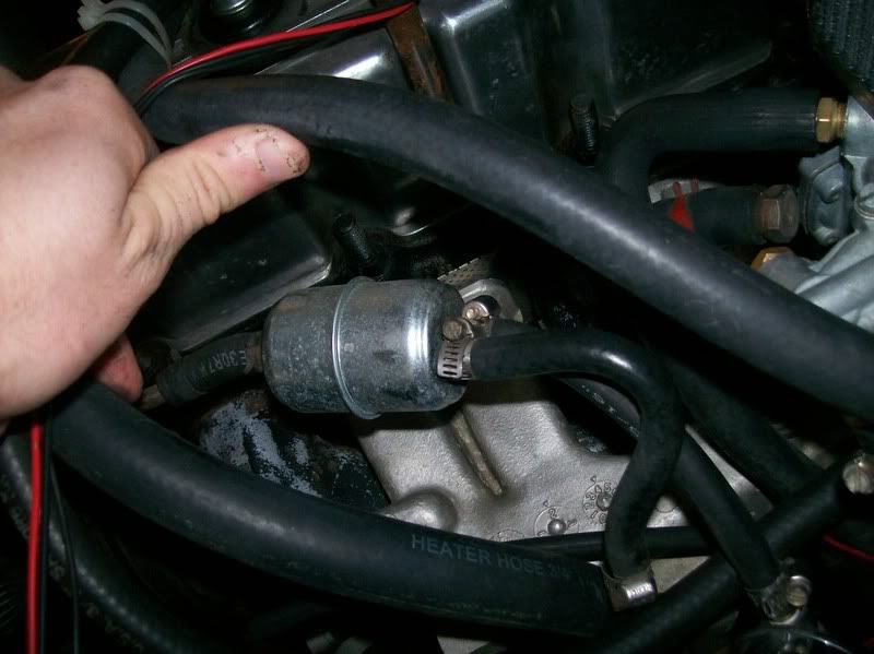

Kovic,
It's difficult to tell from your tiny pics, but your description indicates the fuel filter is not vented. It should be a 1-in 2-out type filter. The vent should be installed at 12 o'clock and connect to the canister.
Also, I think I see an extra fuel filter down by the distributer. That shouldn't be there.
You may also consider getting rid of the pressure regulator. Yes, I know Weber recommends them, but they aren't necessary on a 258 with the correct pump and filter, and they can cause more problems than they eliminate.
Otherwise, your plumbing doesn't look too bad, from what I can tell. I've seen much worse.
