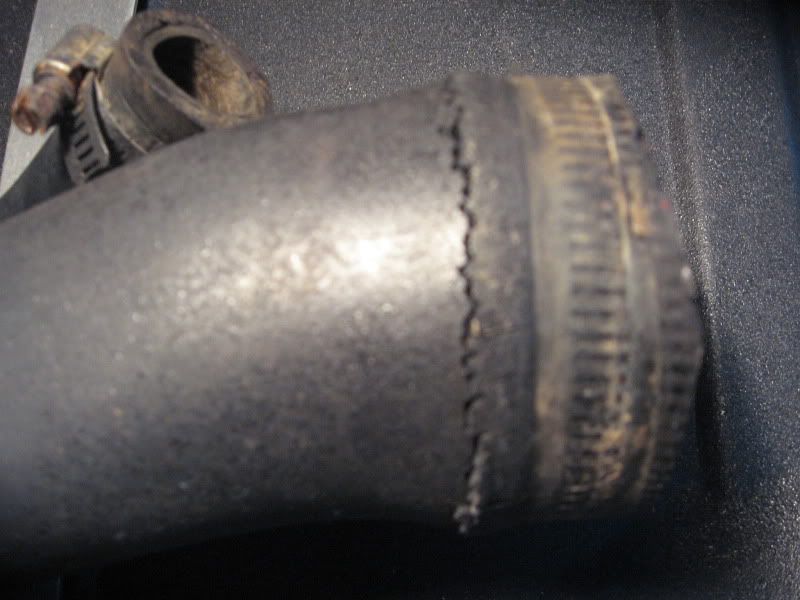

The fuel filler hose on my 77 cj7 has this nasty dry rot crack in it. however it is not busted completely thru and I really only wanted to fill with some sort of epoxy type filler any suggestions

Replace it...
I normally get from 5 to 15 years (the originals seem to last a bit better than the replacements) from these hoses. I just replaced both on my 85 for around $25.
Enjoy!

If it were only that easy. The '76 and '77 filler hoses are next to impossible to find.

You can get a new one from here.

i tried that option 2x only to get one that is shaped like mine but is about 4 inches to short. so i was wondering if i could just put something around it for right now and just chance it till its day comes.

i had alot of trouble trying to find the Z shaped vent hose, as mine had some cracking near the ends. after not finding one, I wrapped the ends on the outside with tommy tape, a 'waterproof' rubberized electrical type tape. I hated to have to do it, but it actually worked!

NAPA-form fit your own.
I bought one of the last one from 4WD and it was 4" to Long. My tank has a longer neck on it. I couldn't get the vapor fitting off my old one so I don't remember if I ever used it.

Are you waiting for someone to suggest JB Weld? Because that would work for what your asking.

This might sound stupid, but how about a tire patch repair kit? Like on the bicycle tires from when I was a kid ('70's). Fill the crack with the glue, then glue a rubber patch over it. Might make clamping the hose back on interesting though.
you trying to kill him!!!
you may need to go to an exhaust shop and get them to bend up a piece of exhaust tubing to the shape of the hose and use short sections to join it together.

Didn't seem any worse than JB Weld.

i found some epoxy at napa this stuff worked pretty good and i put about 3 coats on i hope this does the trick
its called clear weld

Just out of curiosity, why are you dicking around with a mickey mouse band-aid fix instead of properly fixing a potentially dangerous problem? Any auto parts store can sell you fuel grade hose to length...just bring in your old rotten one and they will match up the inner diameter to a length of new hose...costs about $5 per foot...

+1 it should only be fixed right.
