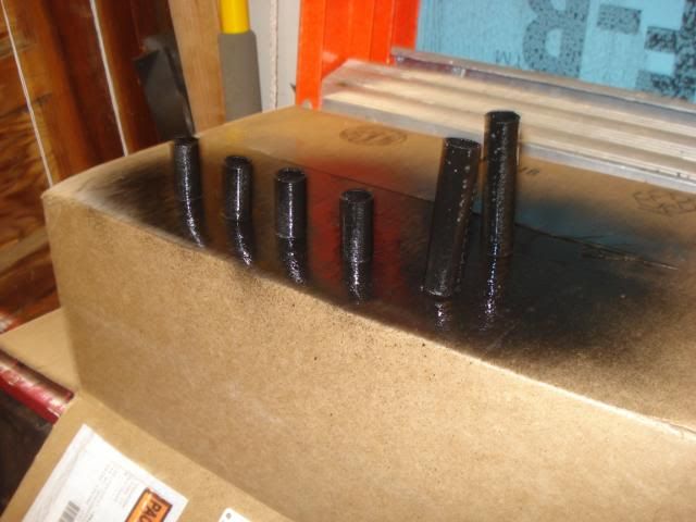

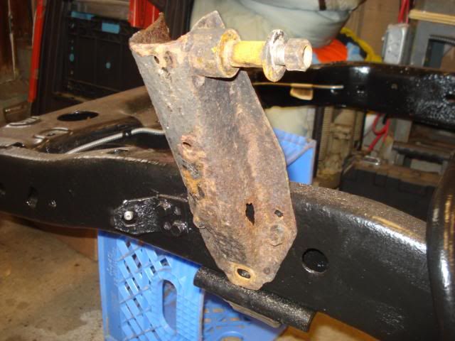

With the lift hopefully on its way I started the Ford shock mount swap on the front of the chassis.
I cut a few pieces of 1/2 electrical conduit for crush sleeves and then hit the mounts and all the new holes that I just drilled with some chassis coat. There is a factory hole in the frame that the crush sleeves can just slip into and be worked into place, you can see it in the first pic. Here is a link that I kind of followed http://www.in2jeep.com/fordshockmt.htm
When the paint is all dry I will get some better pics.

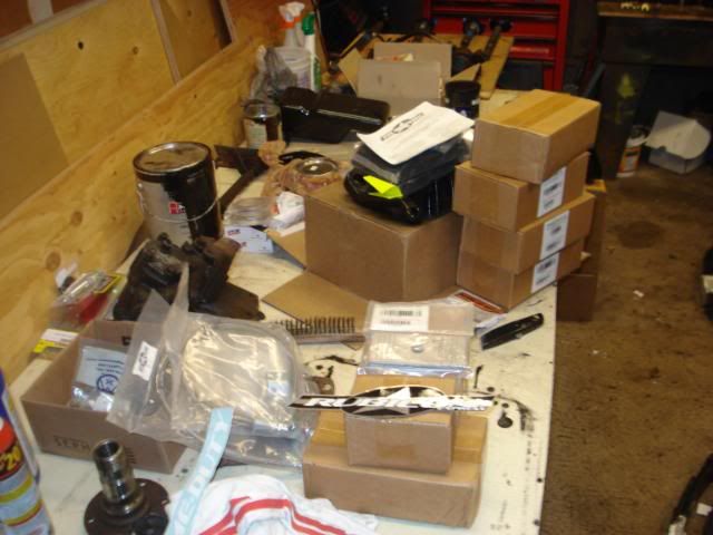

Two words, LIFT KIT. It came in tonight and I am very excited to get started.
Boxes of goodies
Should be a great weekend

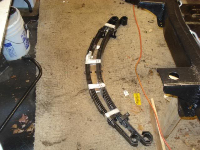

I just ordered this dana 30 diff cover from Ballistic fabrications. It should look cool on the front of the cj. Last night I got the lift in and the rear on with the tires. I'll get pics up tomorrow.

Here are some pics of the progress from this weekend.

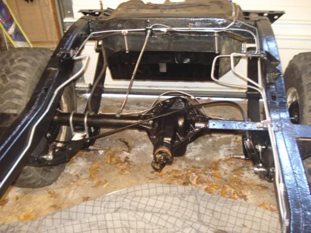

Everything is looking good but it looks like the rear brake line from the crossmember to the axle is a little short with the new lift. That won't last long acting as a limiter strap.
I'm diggin' the new front diff cover.

It is a little tight, you would think that since it came with the kit it would be long enough. I may need to have a custom line made in the near future. I must say all of the parts that came with the lift are really nice, quality pieces.
