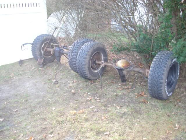

Not much building today, more of a get this old frame out of my driveway before the neighbors say something. I started with this
and took off the axles, steering components and anything else I may need in the future. Ended up with this so far
I am going to practice my welding on the frame and then weld up the axle tubes on the amc 20. Maybe put it on craigslist and see if I can make a buck or two and then the frame is off to the scrap yard finally.

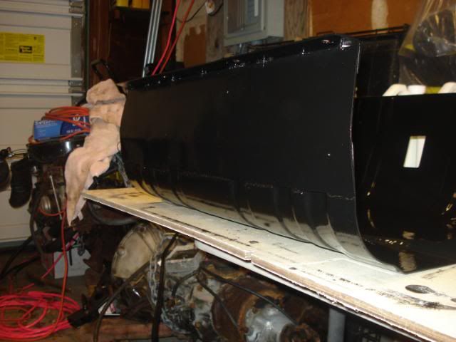

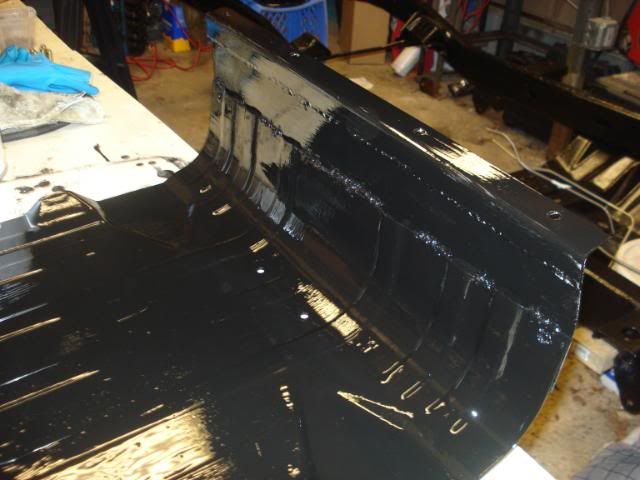

I went to install my gas tank and new skid plate today only to find that I have a 20 gallon tank and not a 15 . The only thing I could come up with was to extend the skid plate to make the tank fit. I bought a piece of flat steel and a piece of angle, welded them together and started my first welding project.
This is the shot of the tank with the 15 gallon skid
and this is with the piece welded on
I also got the skid plate for the transmission mounted, motor mounts and cross brace mounted.

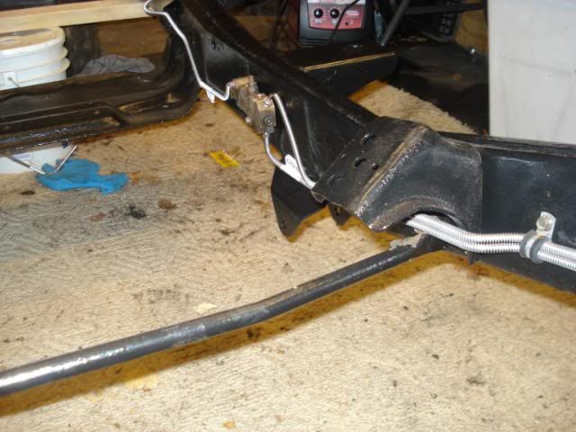

I got a coat of paint on the gas tank skid and started on the new stainless brake lines.
