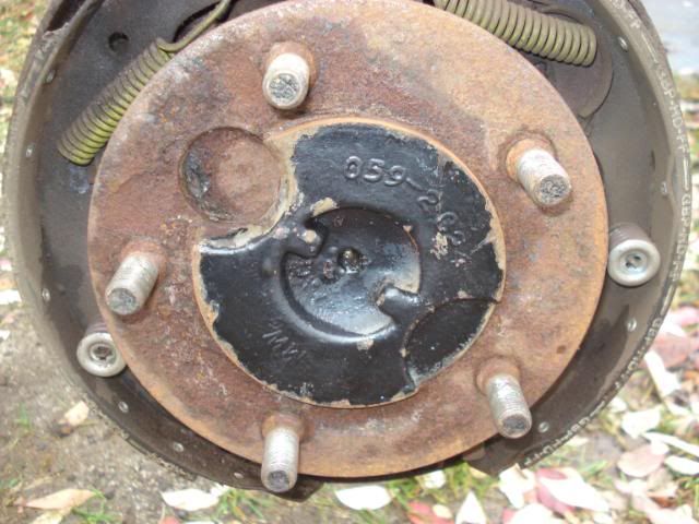

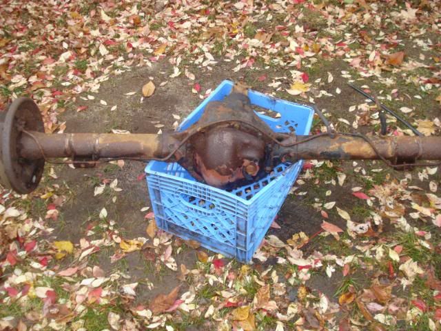

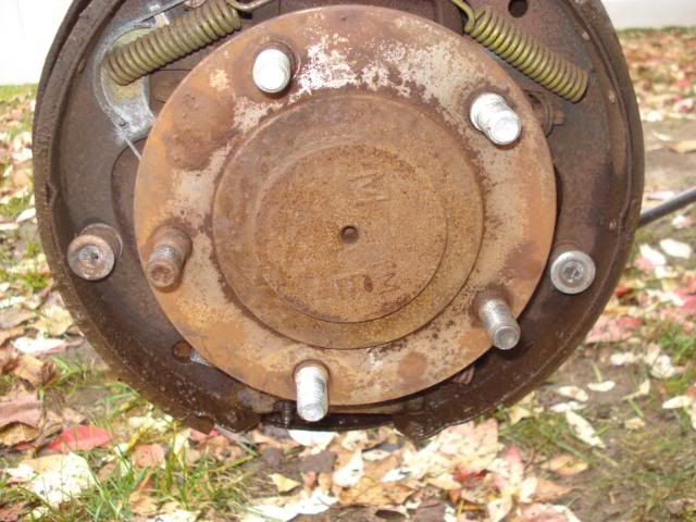

Well I picked up the Dana 44 this morning and I am real happy with the purchase, $150 not bad.
I do have a question about the axles that it came with. One axle looks different than the other?
What do you guys think? Maybe one was replaced for a reason?

I'm pretty sure the bottom one is stock and the top one looks to be an old school Mosier Engineering axle.

Coiz and I figured out that the gears in the Dana 44 are 2:73's. I guess I will be doing gears after I find out what ratio the 30 in front has in it. Just scrubbed the dana 44 with marine clean and metal ready, so now I will try to get a coat of por15 on it in the morning.

I finally got a coat of por15 on the rear. I do have a question about gears, do you think that 3:73's will be enough for 33" tires? If not I need to start doing some home work .
