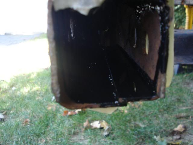

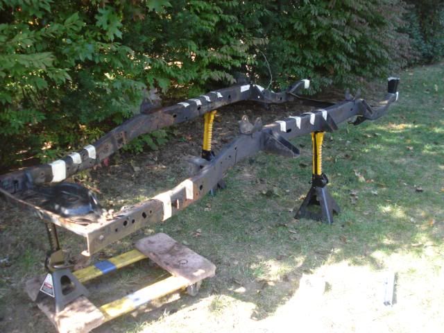

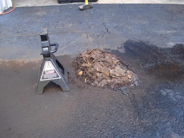

Here are some pics of the frame with a coat of rustoleum being applied to the inside. I got the idea from another member and it seems to have worked out good, im just waiting for it to dry now. There is also a picture of all the rust and dirt that poured out of the frame when I stood it up and smacked it with a hammer.
This seems to be the theme of my build-RUST
I am in deep
