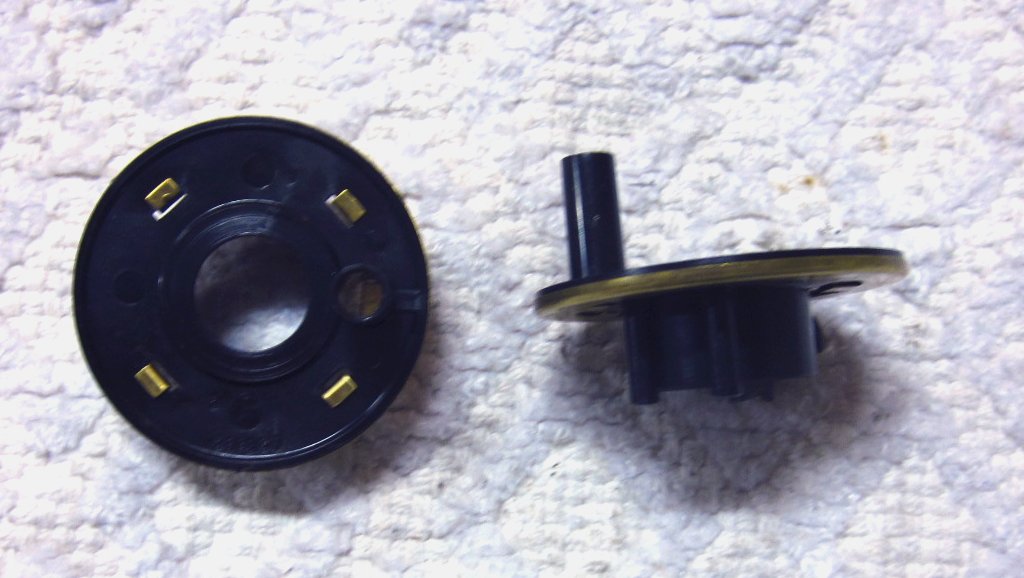

Originally Posted by Gigemags05 View Post
I can't find the post you're referring to. I searched through your posts but didn't see it.
If that was the case, though, would the horn still be on constantly when the button and assembly is off?
With the button off but what assembly are you talking about?
Is this a stock steering wheel?
Stock, this plate might be upside down. This will cause it to sound continuously or intermittently.
it's made up of these parts. It varies a little with the jeep stuff
Internally there is this plate:
There can be all kinds of thing wrong here.
it can be broken off, contact missing and spring shorting out. installed wrong...
Here is the spring loaded button:

Yeah it's stock. I guess it's not actually an assembly. Just the little plastic piece, the screws, the metal plate, and the little piece with the spring.

I added more after you posted...
There are some internal stuff shown above.
Is this sticking out with a metal button sticking out?
John Strenk is offline

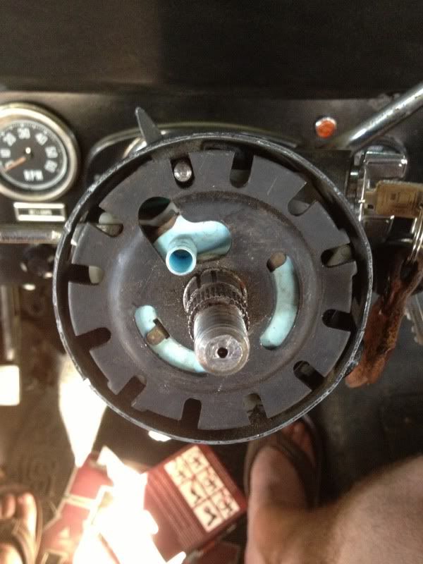

I pulled the wheel and couldn't find anything out of the ordinary. I also went ahead and attached the new wheel just to see if by chance it was something in the old the was messing it up. No luck.
How do I get this part off to check the wiring underneath?
Any other tips on what I can do to troubleshoot?
