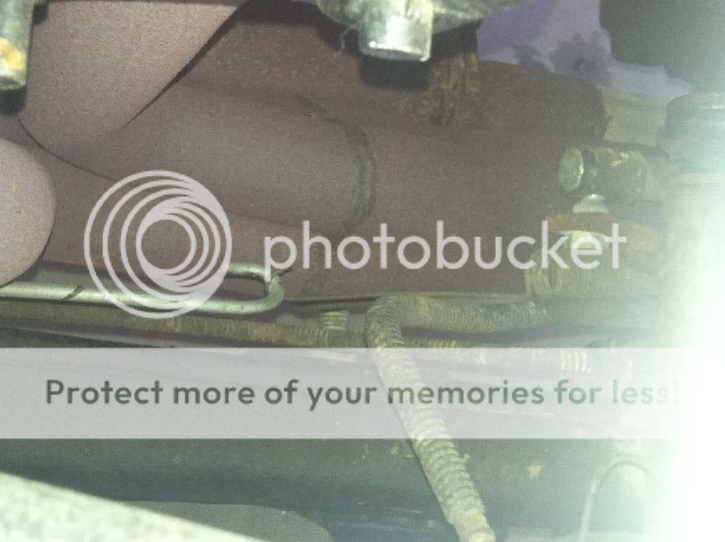

My clutch pedal spring is attached to the motor mount with a bent piece of wire. Thank you to the PO for that. It works fine but what's the spring supposed to connect to?

Slot in throwout fork to the edge of the bell housing. Different spring I think too, than what you show.
