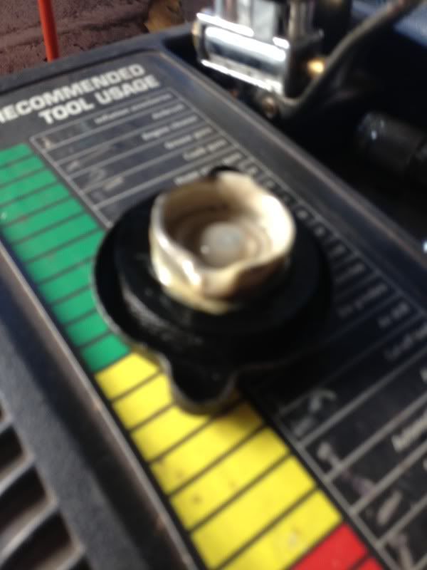

Welp....
I guess the leakdown test was probably moot.
Unless this could be from the 'decorbinizing' treatment I did.....

Please tell me that is NOT the first time you have removed the oil-fill cap........
That can also be from short trips, in that the engine doesn't get hot enough, for long enough, to 'cook' off the water from condensation that's inside the block.
Is the crankcase over filled now?
Have you run a pressure ck on the cooling system?

Definitely NOT the first time! That's why I was floored...
And short trips would explain it...
I've only been driving a few blocks during this 'project' to test for knocking.
Haven't tested the cooling system pressure because the PO pushed it into the fan at some point and there is sum kind of bubble gum crap on there, i assume to plug some leaks...

That picture would be goop on the rad cap?
Forget it.
Forget it.
Oil fill cap
