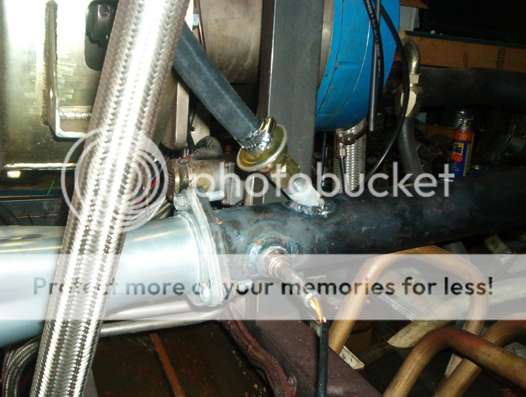

post #724 of 844 Old 07-15-2013, 04:36 PM
swatson454
1983 CJ7
Location: Texas Hill Country
Posts: 6,594
Originally Posted by 86cj74.2L View Post
... or get the kit to run it into your exhaust. Which will help evacuate the crankcase anyway.
This won't work on the street.
Notice the hose from the breather. There was one on each side welded in like this...
They'll weep oil out of every gasket under normal use. Ask me how I know
Live in a way that those who know you but don't know God will come to know God because they know you.
swatson454 is offline
post #725 of 844 Old 07-15-2013, 05:03 PM
86cj74.2L
86cj74.2L's Avatar
Location: Stouchsburg, PA
Posts: 10,939
The guys on the Dodge Daytona Fourm in Allpar used this as a secondary evac system.
However it didn't look like yours. It was a 6" long piece of tubing inserted into a hole drilled then egged out into the exhaust pipe then making sure the pipe lays flat wield it into place.
It created a better eductor effect because the exhaust blowing by the open pipe inside the exhaust pulled more air with it. I haven't herd them complain of it not being effective.
I never tried it........so I have no first hand experience. But pictures and what knot.......
Edit.
Here is a picture of what I think you have Shawn. From the inside of coarse. If it had a 90 degree fitting on it with the opening pointed down stream it would be similar to what the Daytona guys were doing with a piece of pipe........
86cj74.2L is offline
post #726 of 844 Old 07-15-2013, 06:47 PM
swatson454
1983 CJ7
Posts: 6,594
That looks about right, 86. It's been a while though.
Unfortunately, the only time those exhaust evac systems work is with full-tilt, WFO deals. If it works well for 2X, it's a band aid and we've missed the real culprit somewhere.

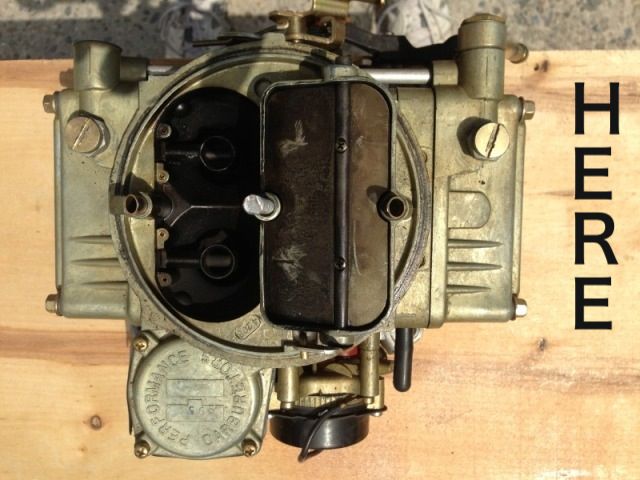

post #728 of 844 Old 07-16-2013, 05:11 AM
John Strenk
Moderator
John Strenk's Avatar
1976 CJ5
Join Date: Feb 2005
Location: Shalersville Ohio
Posts: 16,500
You know, my '63 Chevy had a crank case vent system. even back then they knew it was important to get rid of the fumes in the crank case forcefully. It was just a road draft tube but it worked and you changed your oil every month.
My PCV system has no effect on my engine I could tell. no reason you can't get your to work. I think they gave you the wrong one or a bad one personally.
Yes, one side pulls the fresh air in, should be filtered.
John Strenk is offline
post #729 of 844 Old 07-16-2013, 05:13 AM Thread Starter
2Xtreme
2Xtreme's Avatar
1979 CJ7
Join Date: Dec 2003
Location: Schenectady
Posts: 1,462
Originally Posted by swatson454 View Post
...I've said this more than once and I could most-certainly be wrong but I'd drill and tap the adapter plate so the PCV inlet is in the front where 99% of the air flow is and see what happens. That
Offy intake is a goofy azz design.
Did you mess with the vacuum advance adjustment any further?
Tell me more about relocating a new PCV port. Where and Why?
And by 'front' I assume you mean here, since the carburetor is rotated 90* on the intake...
I agree about the Offy intake design.
Lot's of people have good luck with them. but if I had to do it over, I'd go with a different one.
I have not messed with the vac advance any further.
