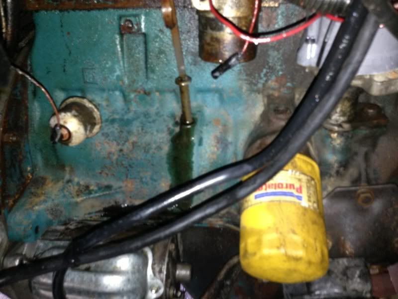

Did pinpoint my leak, though:
It was bubbling right out of there at high idle. And, let me tell you,goes EVERYWHERE when I drive it! Worse than when my VC gasket went....
