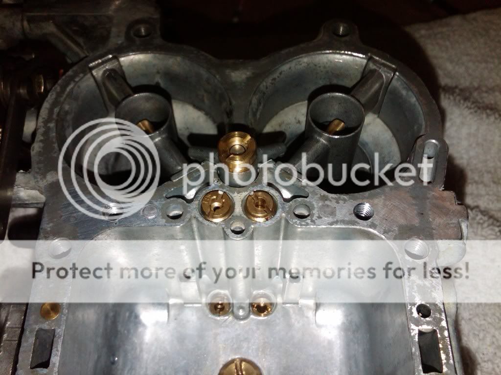

No promises on this post but I'll try. Three hours of Stevie Ray Vaughn and three bottles of wine have done me in.
You'll need a couple of things. A 61-80 wire drill kit, some 6X32 plugs, and some enthusiasm.
I had to cheat a little yesterday because my memory fails me; more than I'd like to admit. http://www.speedtalk.com/forum/viewt...hp?f=1&t=36401
To figure out what you need to do without the aid of a wide-band air/fuel monitor:
Warm the engine up and make sure it's tuned as good as you can get it. Using the idle speed screw, increase the engine speed to about 1,400 rpm. Turn the mixture screws in a quarter turn and listen to the engine and note any change in rpm. In your case, it should sound cleaner and probably come up a little in rpm when you turn the mixture screws in. Go in another quarter turn and see what happens. For kicks and grins, take them out a quarter turn from where you started and see how the engine responds.
What you're doing here is getting the carb off of the idle circuit and forcing it into the transition slots. When you add to or remove some of the fuel with the mixture screws, you can determine whether or not the transfer slot is getting the right amount of fuel to the engine. If the engine cleans up or increases rpm when you close the mixture screws a little, it's probably delivering too much fuel and you'll need to decrease the idle feed restrictors by a couple thou.
If the engine cleans up or increases rpm when you open up the mixture screws, it's likely a little lean and you need to increase the idle feed restrictors by a few thou.
Once you find out where you're at, likely rich, you'll need to remove the float bowl and metering block and start sticking drill bits into the idle feed restrictors to see what size they currently are. Then you'll have to drill the hole out with a #37 bit, tap (blind tap?) it for your 6X32 plugs, drill a hole in the brass plugs that's .002 smaller than whatever size your restrictors were to begin with and try it out using the above procedure.
It's not complicated it's just a PITA draining the fuel out of the bowl and testing over and over.
I did a similar deal with the idle air bleeds on my Weber. Pics for referrence only.
Holes drilled and tapped...
Brass plugs threaded in...
86 posted a perfect pic of where you'll focus your attention. Mark also has a pic of a metering block that's been modified in one of those links above.

All of a sudden we went from talking jet sizes, to idle circuits, feed restrictors, metering blocks, air bleeds, and god knows what else I can’t remember…. I have no idea what any of that meant. Looks like i will be pouring over Holley's site and diagrams again.

Mark, I’m assuming the process of drilling those plugs required a drill press, no?

Jet your carb down and drive it. If it has any effect on your idle quality readjust your idle mixture screws. You want to be around 1 1/2 turns out when you have everything sized right. Of the many ways to restrict the idle restrictors end result is yours is too much for your engine requirements and needs to become smaller.
All the Holley carbs I've had required some amount of tweeking to match what they went on too. Be it the idle feeds, a different power valve, different pump nozzles. Bla bla bla.
