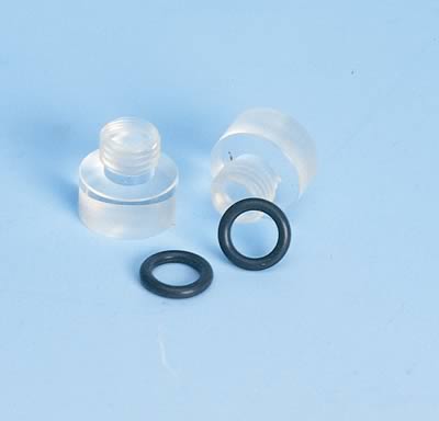

These are cool:
http://www.summitracing.com/parts/mor-65226
There use to be a plastic block that would bolt to your fuel bowl but I can't find them anymore. Not even at Summit Auto.
Maybe JC Whitney might sell them.
