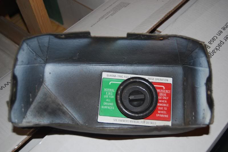

Bill, we buried it a few times, if there was anything besides that glove-knob, I'd have seen it. Sometimes I'd steer, place logs or get my head used for traction under the wheels! That's why I was surprised to see the lever on some q-tracs of AROUND that vintage. Usually well over on the passenger side. Maybe if we had something besides just the "Emergency Knob" we'd have done better off-road.

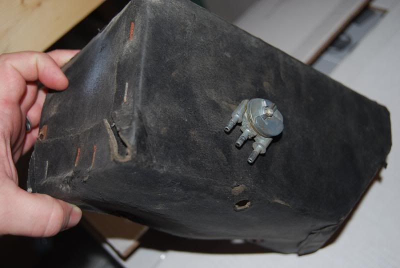

I knew that vacuum switch was used for something in the Quadratrac TC.

Do all three ports on that switch require a vacuum source?

No, just one source and then the switch moves the vacuum source from one port to the other.

No, just one, the other 2 lines go to the actuator.

I'm also thinking I'm of the opinion (that should be enough distance to make Jay Carney proud ) that, being the manifold supply to the valve in the glove box doesn't actually flow, you might be able to tee into it and use that for your vacuum advance, seeing as I don't believe you have another, independent source of manifold vacuum. Might be worth a try.

I do have 3 vacuum lines into the glove box for the QT.
Now Hi/ Low lever, as I have the TH400 as well.
So that answers THAT question.
