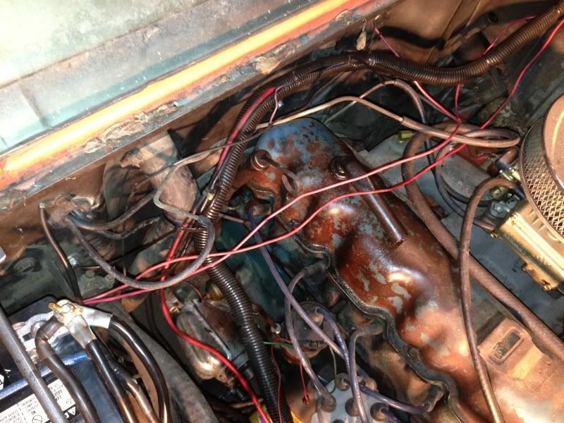

So I just got back from taking pics at the garage (Ssshhhh!) beore jumping on the road. This is what I found:
The vac line that Matt asked about runs into a hard line before another soft line that runs INTO THE PASSENGER'S COMPARTMENT???
Here is a pic that should show it...
THAT doesn't seem right.....

Uhhhh WOW.
Got a picture of your dash? Maybe there was a vacuum gauge on it allready.. Cant think of any other reason to run a vacuum line in there unless it has a YJ heater...
any vacuum gauge will do as long as it has a long enough hose. Those with hooks on them are nice also.
The bigger the dial, the easier to read. Usually they also have a fuel pressure gauge built in..

Nope. No sign of a vacuum gauge installed previously. Just a stock dash with a big ol' hole where a radio was....
So, I guess the question becomes where SHOULD that port be connected to?

Follow it and tell us where it goes.
As John says unless you have a vacuum gauge or a newer heater box that uses vacuum motors instead of cables to operate things it should not be there.
Hopefully if it does nothing it's capped off.

Are you sure you have a Dana 20 transfer case and not a Quadratrac unit?
That would explain the vacuum hoses going into the dash. Quadratrac TC units had a vacuum operated switch mounted in the glove box to switch from high to low 4x4 and vice verse. The switch could have been removed from a PO and then plugged the ends of the vacuum lines.

Assuming it's not used for a Quadratrac, or some other purpose, I'd connect your distributer to it, and cap the s-port nipple.

Holy Crap!
I DO have a Quadratrac unit! And that must be where it goes
I filled out my profile back when I had even less Jeep knowledge than I have now, if you can believe that's possible....
Guess I'd better go back and change that!
That being said, is that a proper way to connect that port on the carb and/or the switch...?
They two seem unrelated, so I have to wonder if that is right.

Not quite correct, the vacuum switch in the glove box locks the front and rear axles together for 4 wheel drive.
The low/high lever is on the drivers side close to the seat mount on the floor , it's mounted on the side of the transmission tunnel .
I know you know this Keith, just wanted to keep the OP from getting confused.
OP, there should actually be 3 small vacuum lines thru the firewall, if everything is connected as it was from the factory.
