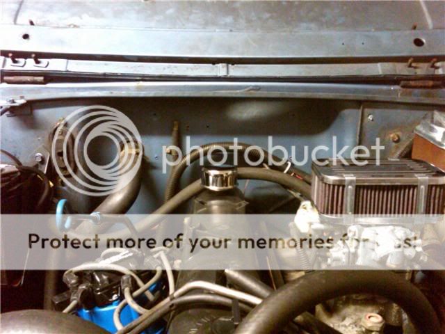

Originally Posted by swatson454 View Post
So bring me up to speed here. You did get your throttle plate to close down? Was it the fast-idle adjustment on the choke that was messing it up?
Shawn
This appeared to be the case.
One thing I was unsure of (and I've read recommendations of doing it both ways), is should I have set it with the throttle fully closed OR on the fast idle cam?
I think once, I verify that and eliminate the vac leak with new carb gaskets, I should be able to get the idle down to where it needs to be.
Another thing I verified is the gunk in my engine.
If you look closely in this picture, you can see it's quite nasty.
Although I would not really describe it as 'sludge', as looks and feel more like carbon. Kind of crispy/ gritty.
Another question I have is about the smoke/ steam coming out of where breather should be..... normal? I doubt it, right?
Should've set what? Try to start with the throttle plate exposing around .020 of the transfer slot. We can always come back to the fast-idle speed when the choke is set later. Am I understanding you right?
I don't know if it's been mentioned already or not but I'd replace all of the PCV stuff as well. New valve, rice-burner breather (the chrome ones make you go faster ) and a new hose. When I put the breather on mine, the O.D. of the chrome breather was different than the OEM fitting that it replaced. The guy at the parts store was kind enough to let me browse through their grommet bin and find the one I needed that had the right ID for the breather and OD to fit into the valve cover.
That's pretty common on an old engine. How much is the question, though. Unless your current PCV isn't working well, that could explain all the oil in your hose. In that case, your rabbit hole just took another detour.
You're getting there. I think you just had more going on than you realized when you started this thread. One thing at a time and it'll come together.
