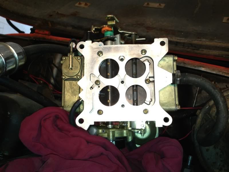

WAIT!
Don't just throw a few turns at it. Back it out until the plate fully closes and go back in a quarter-turn and see how it looks compared to the primary. Please post up some pics before you re-install it.
Shawn
Edit: A pic of how it is right now would be great! Don't touch anything. Just flip it upside down and take a couple of pics that show both the primary and secondary plates. Pretty please

post #298 of 844 Old 06-01-2013, 10:16 AM Thread Starter
2Xtreme
2Xtreme's Avatar
1979 CJ7
Join Date: Dec 2003
Location: Schenectady
Posts: 1,462
Here's a pic of how it was when I started. Not sure what you want to see, but I hope this shows it. Right now it's 1 full turn from where I started, so putting it back and starting over is no prob.

post #299 of 844 Old 06-01-2013, 10:29 AM
swatson454
1983 CJ7
Location: Texas Hill Country
Posts: 6,665
Something like this, if you're able to. Both primary and secondary

post #300 of 844 Old 06-01-2013, 11:12 AM Thread Starter
2Xtreme
2Xtreme's Avatar
1979 CJ7
Join Date: Dec 2003
Posts: 1,462
Ok.... Here it is.
Turns out it only took a little more than1/4 turn from where I started to close the secondaries. The I backed the screw out 1/4 turn.
I don't see anywhere to close up the primaries any further than they already are.
