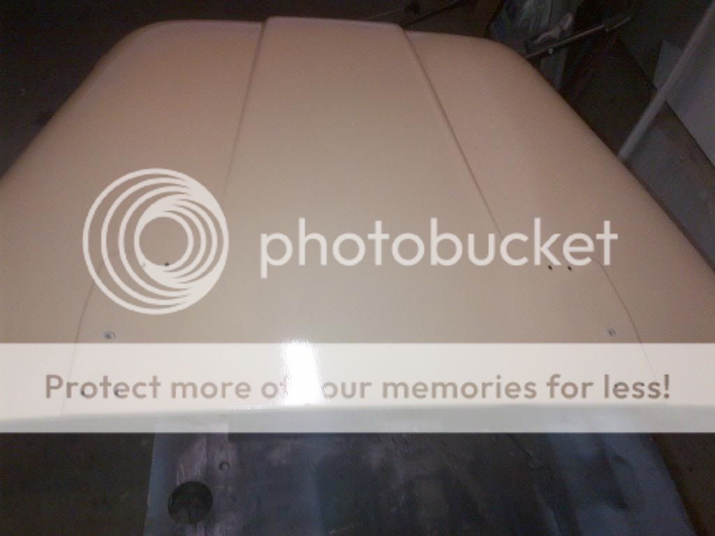

I've been doing some bodywork and also decided to try the Rustoleum roll on paint job I've seen. I'm pretty impressed with how its come out so far! Here are a couple pics after six coats of "Sand"-
The images aren't that great since they are from my cellphone. There is a little bit of orange peal to deal with, but I still need to wet sand a few times and then use polishing compound. While reading about this paint job, I've seen people mention that Rustoleum will fade due to it not having any UV protection. So I have two questions on that.
Will a gloss clear protect against fading? The only thing the can says is that its protection for the paint, but nothing about being a UV protectant.
Is Rustoleum from a quart enamel or acrylic? It just shows "oil based" on the front. I'm asking because I don't want to use the clear gloss in a spray can because then I might get that tiger stripe effect that I don't want. I found a quart of clear gloss but it says its "acrylic", and I know that putting two different types of paint down on each other can cause de-laminating.
If I can't use the acrylic or if clear doesn't protect against UV damage, is there any waxes or auto paint protection that anyone can recommend?

The term "enamel" has lost its meaning. When you can buy latex paint that's labeled as "enamel", then the term is useless, IMO. "Oil based" is what you want to know. If you need paint thinner or a similar solvent to remove it, then that's what you want.
Originally Posted by Dborns View Post
I
I would definitely be careful about using any kind of clear coat on top of the Rustoleum. I think the best you can do is to call Rustoleum and get their opinion, and then do a test piece with the clear over the same paint you used on the Jeep. I'd hate to see all your painting work go to waste by having the clear coat foul it up because of some chemical incompatibility. In the auto painting world it's pretty well known not to mix products from different manufacturers, so I would proceed with caution.

Thanks for the reply. I emailed Rustoleum customer service today about the clear coat issue. I'll run by HD and see what selection they have of oil based clear coat. I looked on the net last night and found an article about using a rub on sealant and then carnuba wax for uv protection.

The email I received said that Rustoleum does offer a gloss clear coat in a quart. The CS person stated that it will protect against Uv rays and that regular rustoleum has "some" Uv protection. I replied asking about using latex over oil based and she responded that it would be ok as long as I let the base coats dry fully before applying it.
Ive put 8 coats of base on and the next step is polishing compound. The PC I bought says its for removing light scratches and Ive read that it removes swirl marks and sanding lines. My thought was to apply the Pc to clean up the base coat and then apply the clear. Then I started questioning putting clear over a polish. I think Ill just apply a couple coats of clear then go over that with polish.
