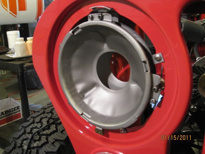

Kinda digging up an old thread, but figured I would give my $.02 for a five minute fix to to this. Go to your local PepBoys, Advance, etc and get HELP! item number 42125 adjustment screw. Remove your headlight assembly and drill out the thread hole *just a little*. The bolt end of the above part number has a "nipple" that can be inserted into this slightly enlarged hole and wings that will grab around the original threaded nylon assembly. Takes literally five minutes and $5 to do.

I just got some slightly bigger and longer bolts and held a nut on the back of the bucket, screwed the bolt in, and the tension holds the nut in place allowing me to screw/unscrew just like it's supposed to be.

One of my plastic adjusters on one headlight bucket was broken. Got a used bucket from junkyard for $5 and drilled out the rivet that holds the plastic piece on and transferred it to the OEM bucket and you can't tell the difference. Used the same type of rivet to hold it in place as we have them in stock where I work.
But the ones that LKCJ posted from ebay is a better choice than going through the hassle of acquiring a donor bucket IMHO.
