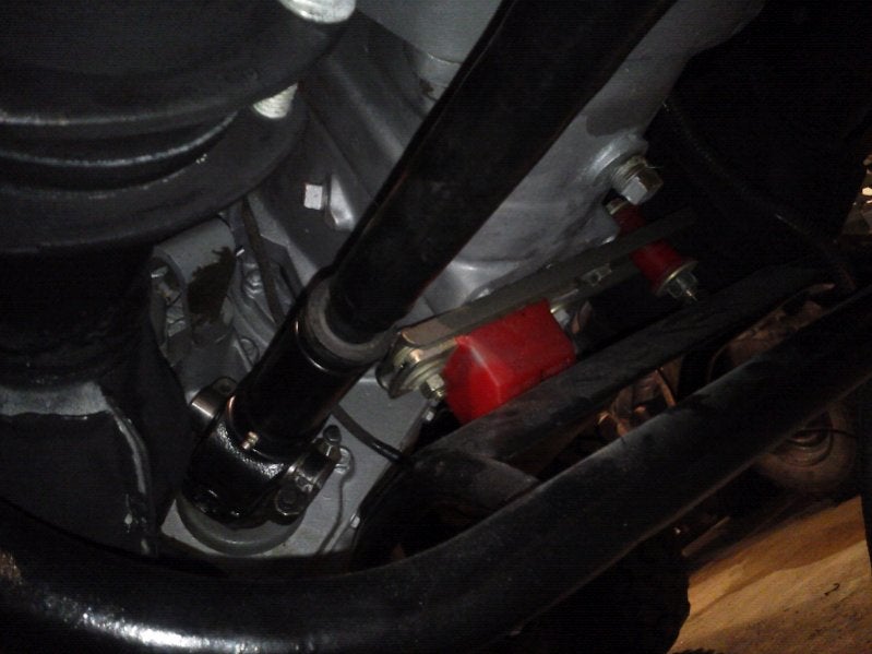

To finish off the weekend, I finished up my front drive shaft. I had to cut it down by 1 inch since I moved the engine forward. Didn't take any pics of the shortening process, but I just cut a chunk out and welded it back together, being careful to make sure it was straight, and the yokes were in phase. Then it got some new paint, and some u joints. Gotta get some new u bolts, then it can go back it.
