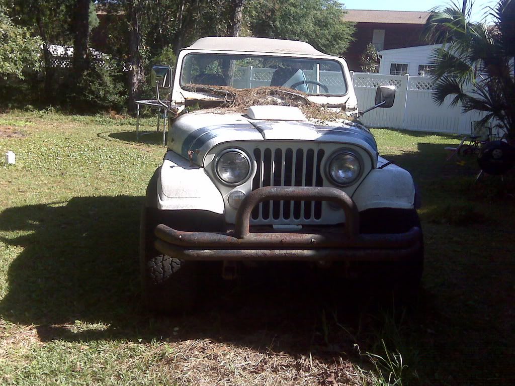

I started the tear down today on the 76. I have found way more rust then I was hoping too, however; that it what you expect when working with a CJ.

It's October and your working without a shirt on. I'm debating firing up the space heater to work on mine.
That rust doesn't look that bad. You should of seen my '76 CJ.
Have fun.
i concur.... that is child's play!

Well yeah.. no shirt, the beauty of working in Hawaii, however finding parts is another story. I am really encouraged to hear that the rust is not as bad as I was thinking.

HA! You call that rust?!

And you gotta love the gas fill location LOL!

I like the aerodynamics of the windshield. That'll save some MPGs.

It was designed to make it look really fast while sitting still since it wouldn't run. The PO would just sit in there and bounce around like he was going somewhere!
