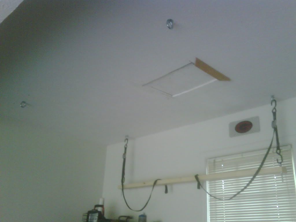

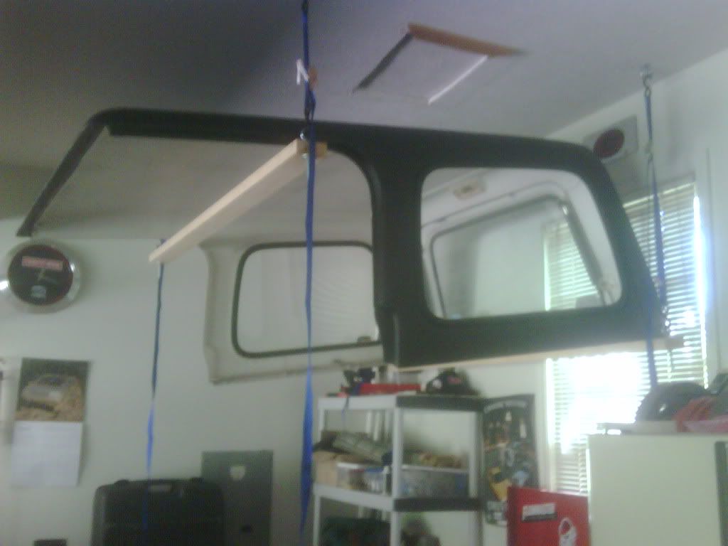

For the last 20 years I have mounted 4 eye hooks in the garage or carport directly above the 4 corners of the box. It takes me maybe 5 minutes to remove my top and maybe 10 to re-install depending upon if I add the weather strip back.
Back Jeep into area you want the top stored. First open the rear hatch. Then hook a ratchet strap in each eye bolt, with the straps hanging to the four corners; I lift a corner up and hook the S hook under the top and work my way from front to back. You just have to lift each corner about 4" , its not too heavy even my gf can take her in top off this way ;-)
Then you drive out. You can even hold it with your hand as you drive in or out to steady it.
The top is balanced and will stay hooked unless you bump it hard. Mine even stays if one hook falls off.
