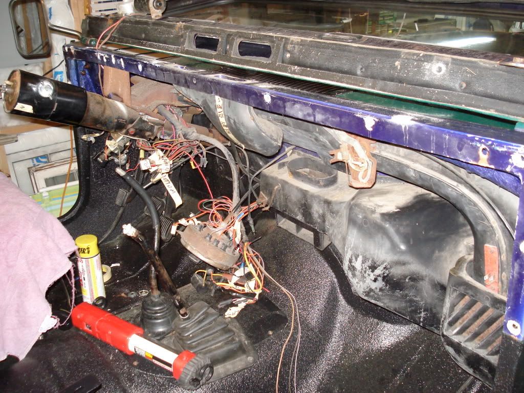

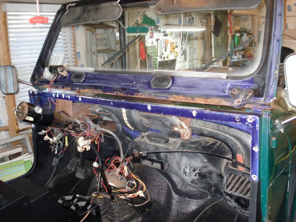

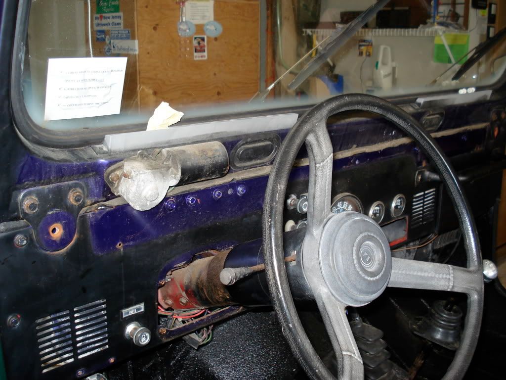

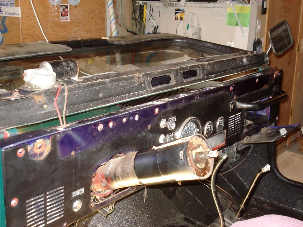

I am submitting a post to show off the results of the hard work and patience that has become an project a year or so in the making. I would say i am about 80% done (with the big thing being the engine swap to be finished this winter). I don't really have any mechanical experience, but I do have patience and the like to research and read as much as possible before I attempt to work on my jeep. I am lucky and proud to say that most of what I have picked up has been as a result of reading past threads and getting educated and thought out responses from members.
So to answer my "Half Learned - Half Paid" Title? Well, I also know my limits beings that I borrow garage space and have to drive a couple of hours to work on the jeep. I took the interior apart, rewired the dash, put a stereo and speakers, two security boxes, new bucket seats, painted the tire carrier and rear bumper, stripped and rhino lined the interior, reworked to Hard top Acme Fiberglass Doors, got on the Rally Top, and a few other odds and ends.

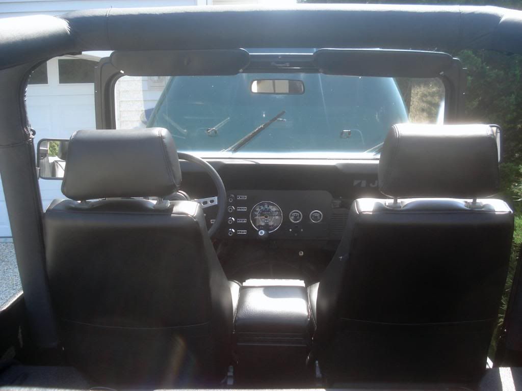

Some Photos

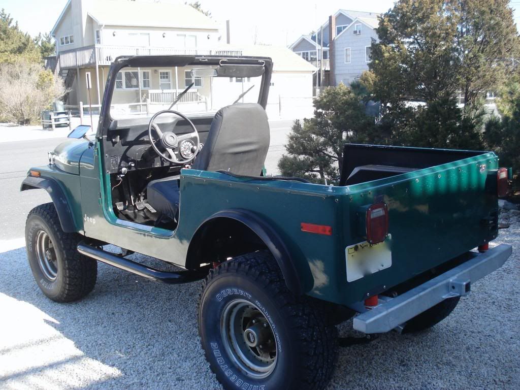

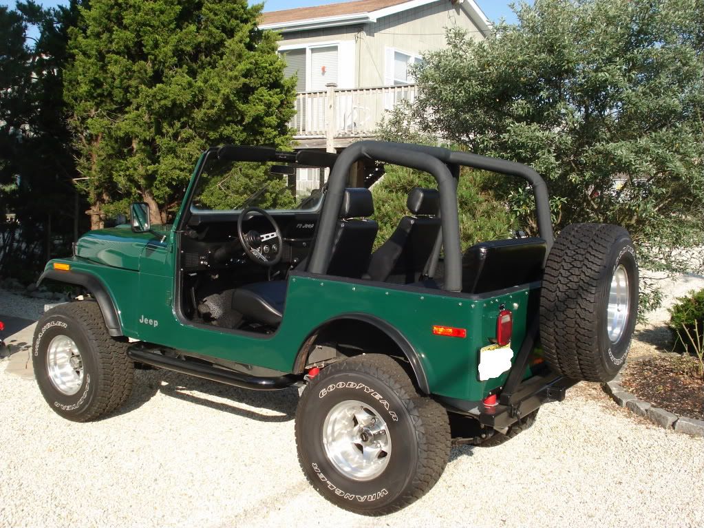

Some Overall Photos of Interior and Exterior

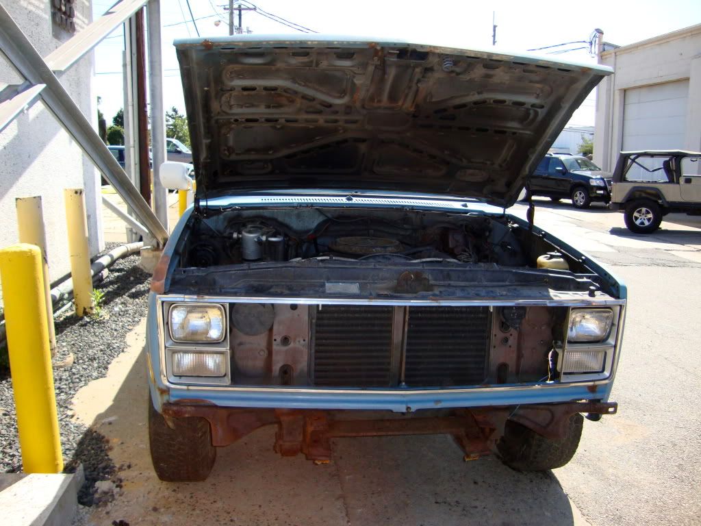

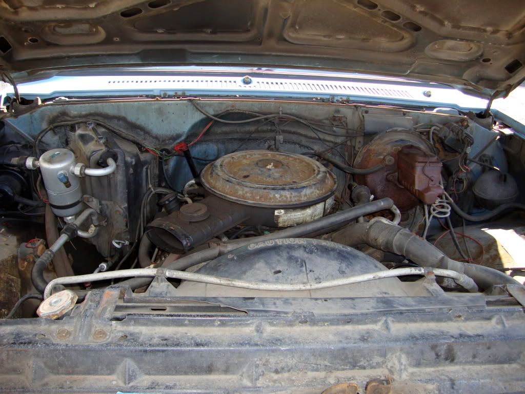

Posts: 91

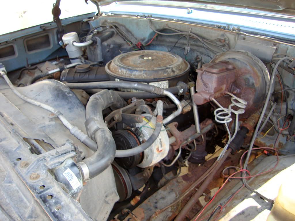

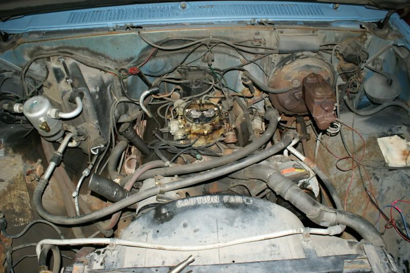

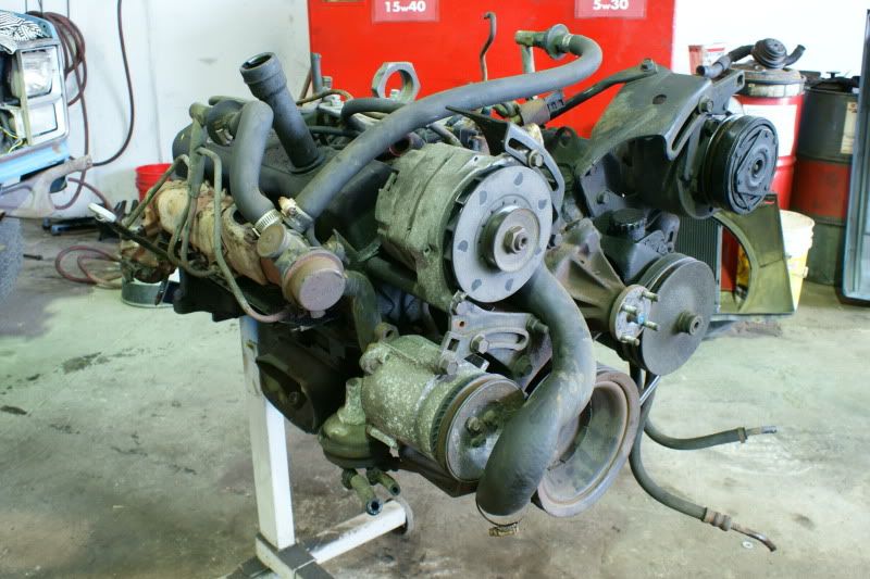

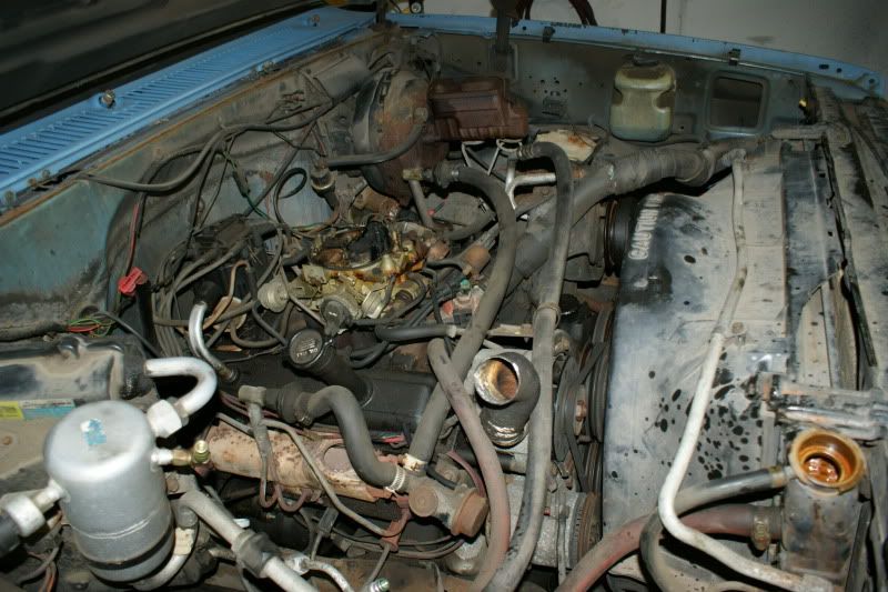

Donor Vehicle
1980-86 ? Chevy pickup with a 350. Bought it off CL with delivery from a real solid guy for a good deal. He said it was a plow truck for a company in PA. Seems like the original engine had been taken out, but that's still undecided.
I drove it around, shifted the gears, everything seemed to be working fine.

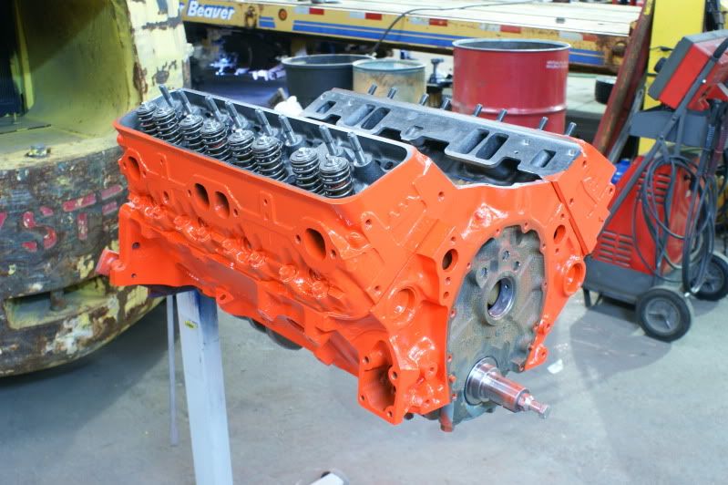

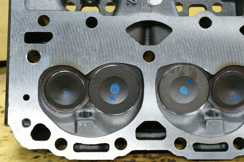

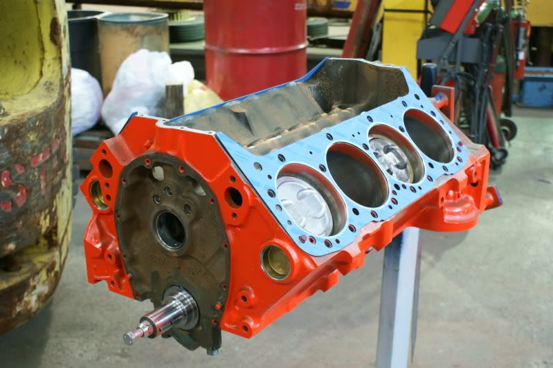

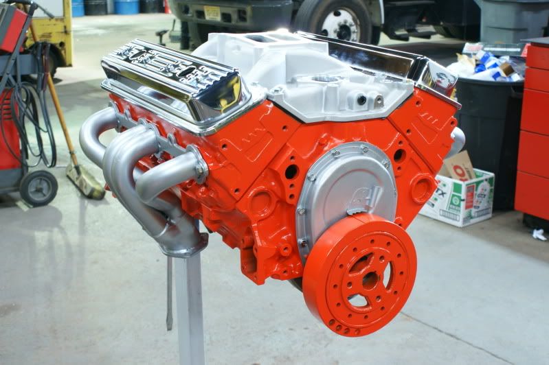

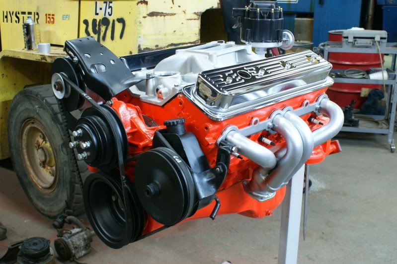

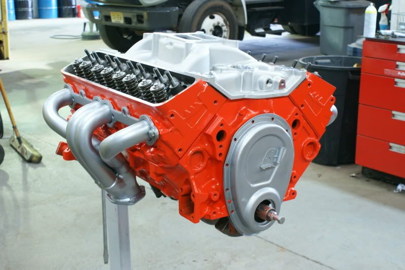

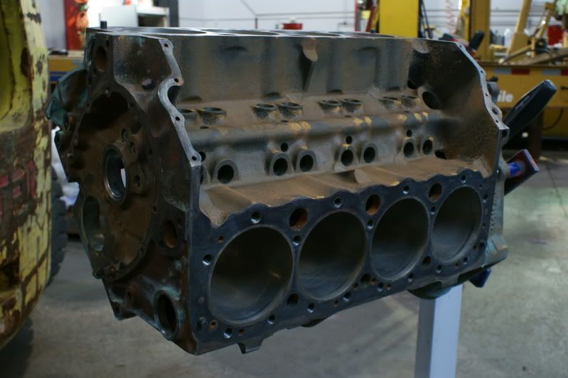

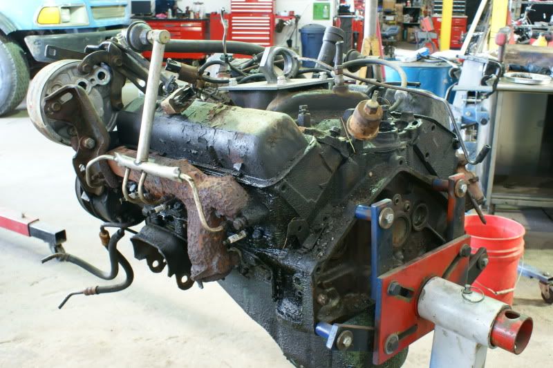

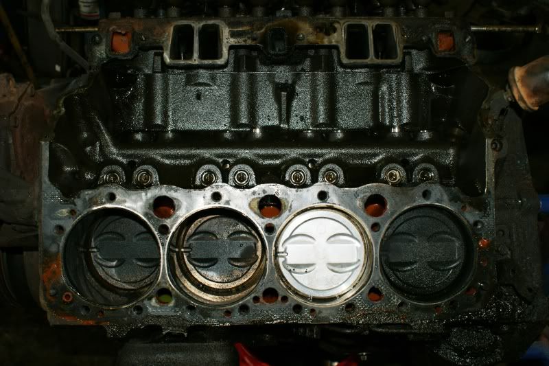

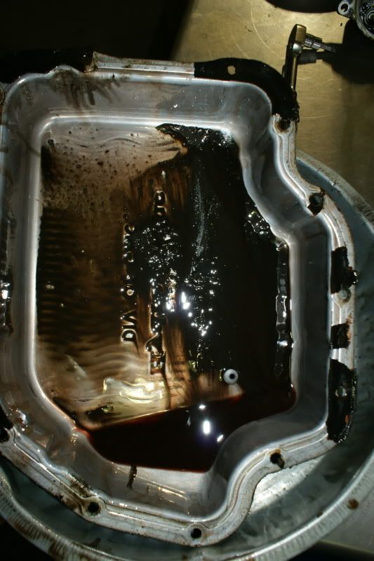

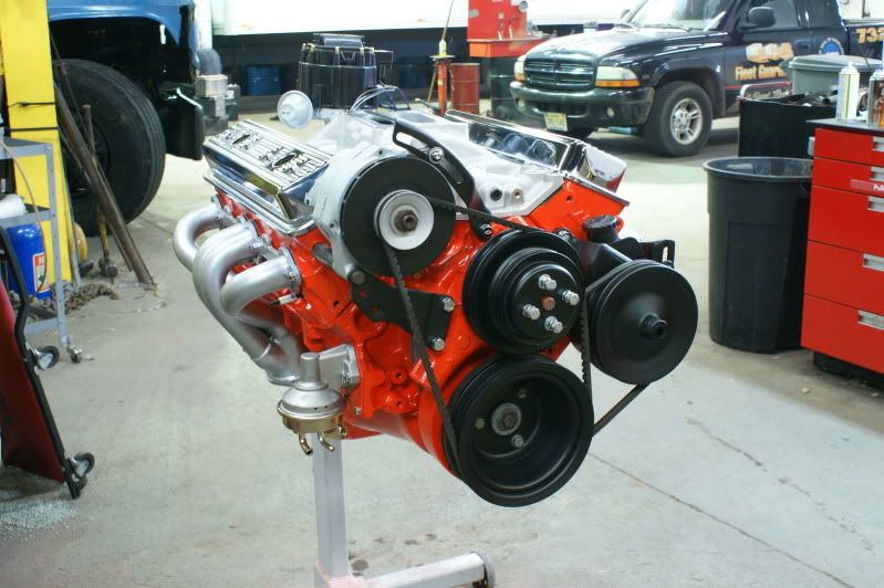

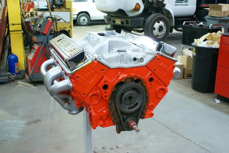

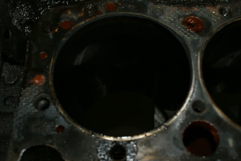

Progress of 350 SBC
I have included photos of the Engine Build. As my previous posts said. I am learning, but leave the expert work to the people who know what they are doing. I knew an engine swap was past my ability....

Final Mock Up and Assembly
Just got these photos.... Sweet! Any and all suggestions as to Exhaust Options would be appreciated. Thanks!

On the exhaust, no matter if you go single or duals, you will want the tailpipes coming out the back corners on a 45 between the spring and frame. They should even have the turned down ends on them. In this configuration, the exhaust blows out and away rather than vortexing behind the tub which gets you bad fumes and CO.
I have gotten good service, performance and sound from Dynomax mufflers on both my Jeep engine and a couple 350 GM engines.

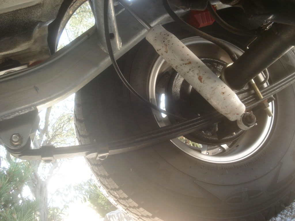

Nice build. What type of leaf springs is on that? Looks like a 3 leaf system... Hows the ride?
Have fun w/ the exhaust!!! I have a sbc in mine and that's the single biggest problem I've had - Well, that and the front DS clearing the bell housing... Gotta lift her now while the tub's off.

So with the stock lift, are you saying that there may be some clearance issues with the drive shaft and engine placement with the SBC? I am looking for any and all suggestions as to the roadblocks I may run into. I am hoping with the lift, it may reduce the amount of drive shaft angles.

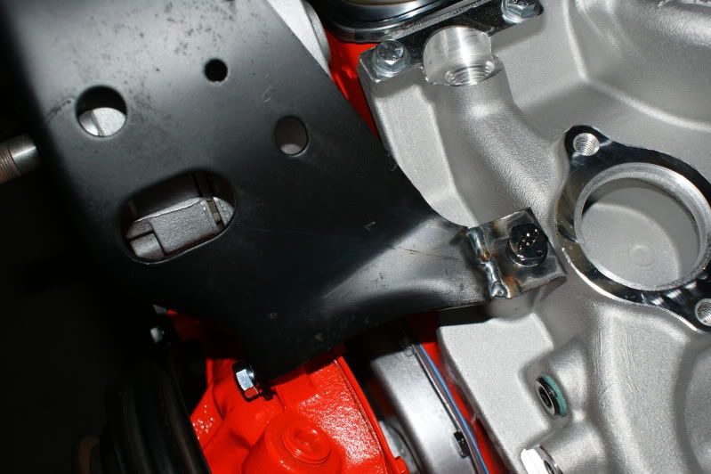

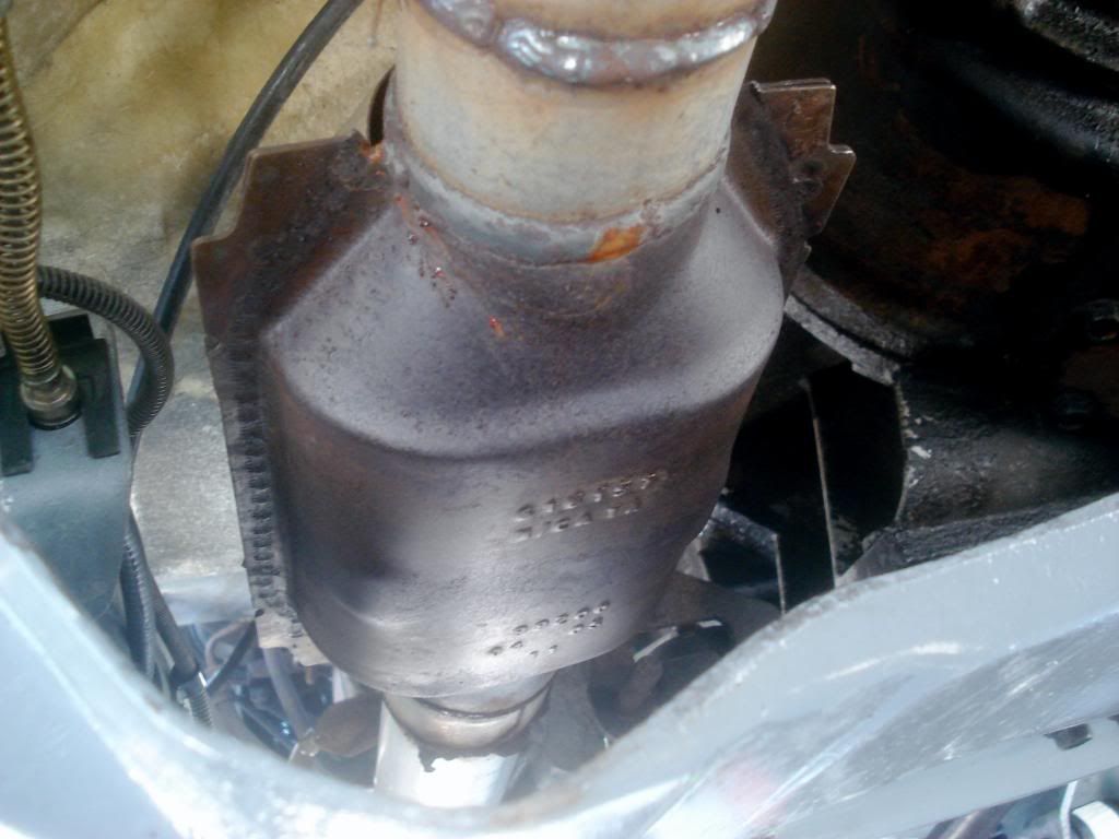

Your springs aren't stock - what brand are they??? Custom? - just never seen a 3 leaf pack before...
Ya, I have a '76 CJ7 with a chevy 350 -T400 - quadratrac tc. I have stock (I think) leaf packs on there now ,and they are not quite flat, but definitely sagging a bit. The PO put in lift shackles, so I'm approx 1.75" above stock / saggy ride height. There is a good bit of evidence of rubbing on the front DS. See pic below. Just something to look at. I'm not sure you're going to have a problem, because you have more arch/lift in your springs than I do, and you're running a different tc, but you'll want to jack up the passenger side of the axle & check clearances / maybe adjust bump stop a bit. A little rubbing and you could develop a pretty bad vibration in the drive shaft.
There's not a really good way to run the exhaust collectors around the oil pan on the passenger side, and you either end up under or over the drive shaft. If you go out by the frame rail, there's not much room to bring them together, and (at least in PA) then you have to get 2 cat's if you go with a dual exhaust... My passenger side collector is crushed by the Ujoint on the front DS, and It's restricted a bit and will get addressed now that I'm pulling it apart.
