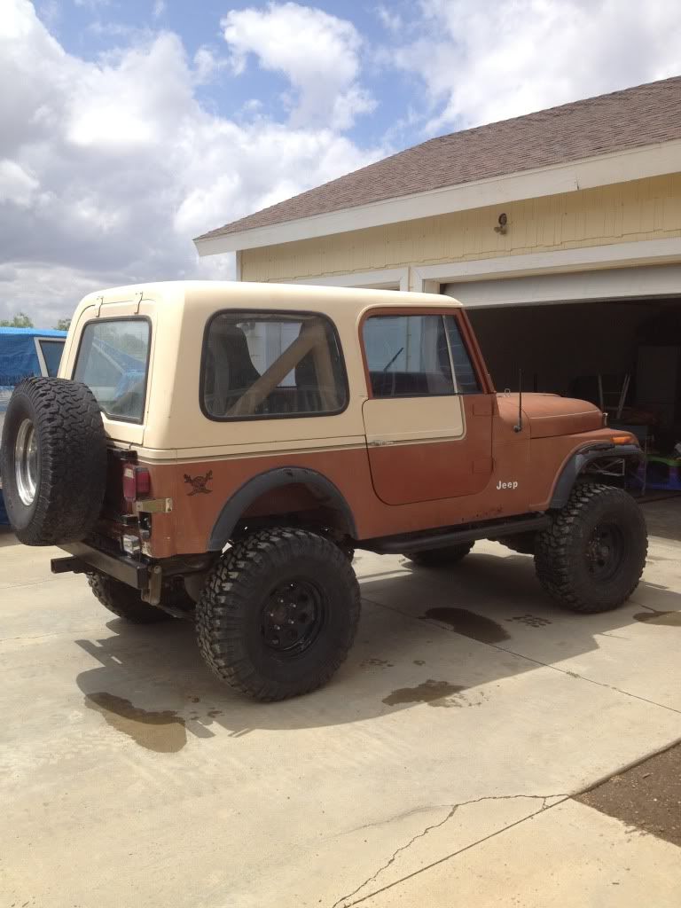

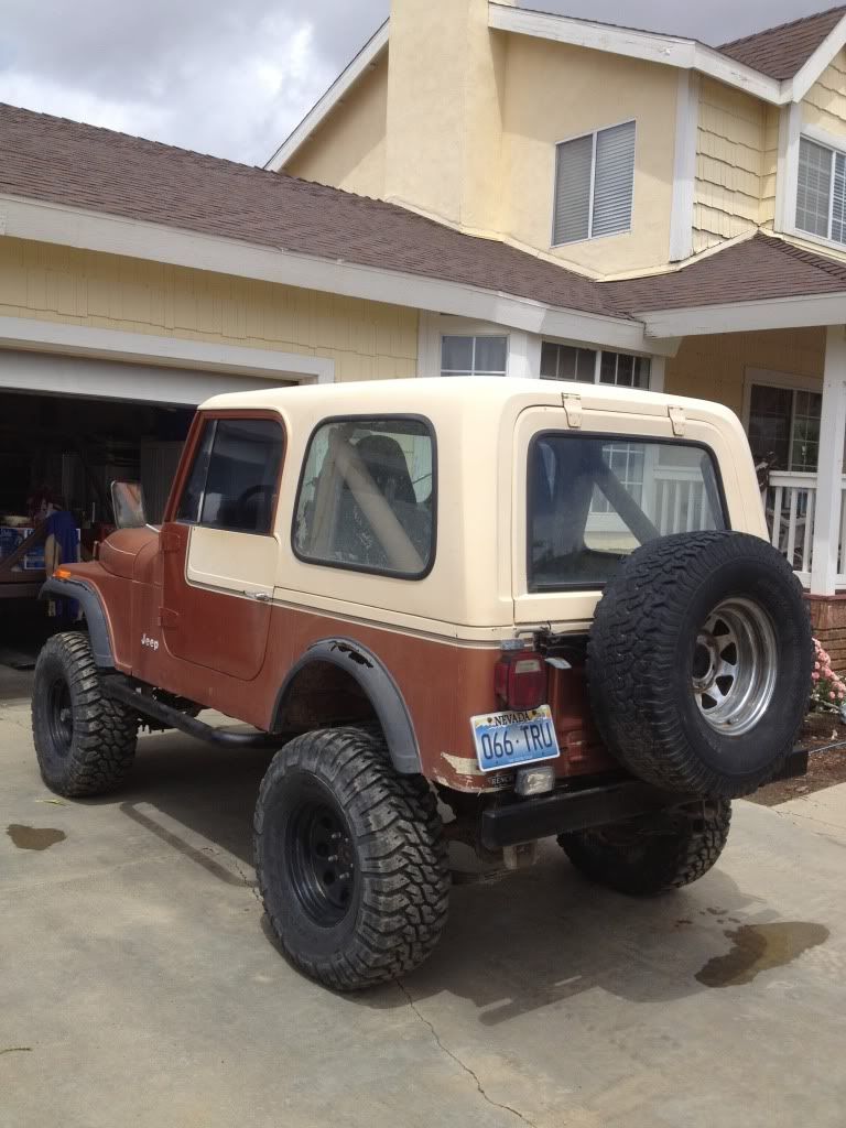

heres how the jeep looked when it was dropped off at our house

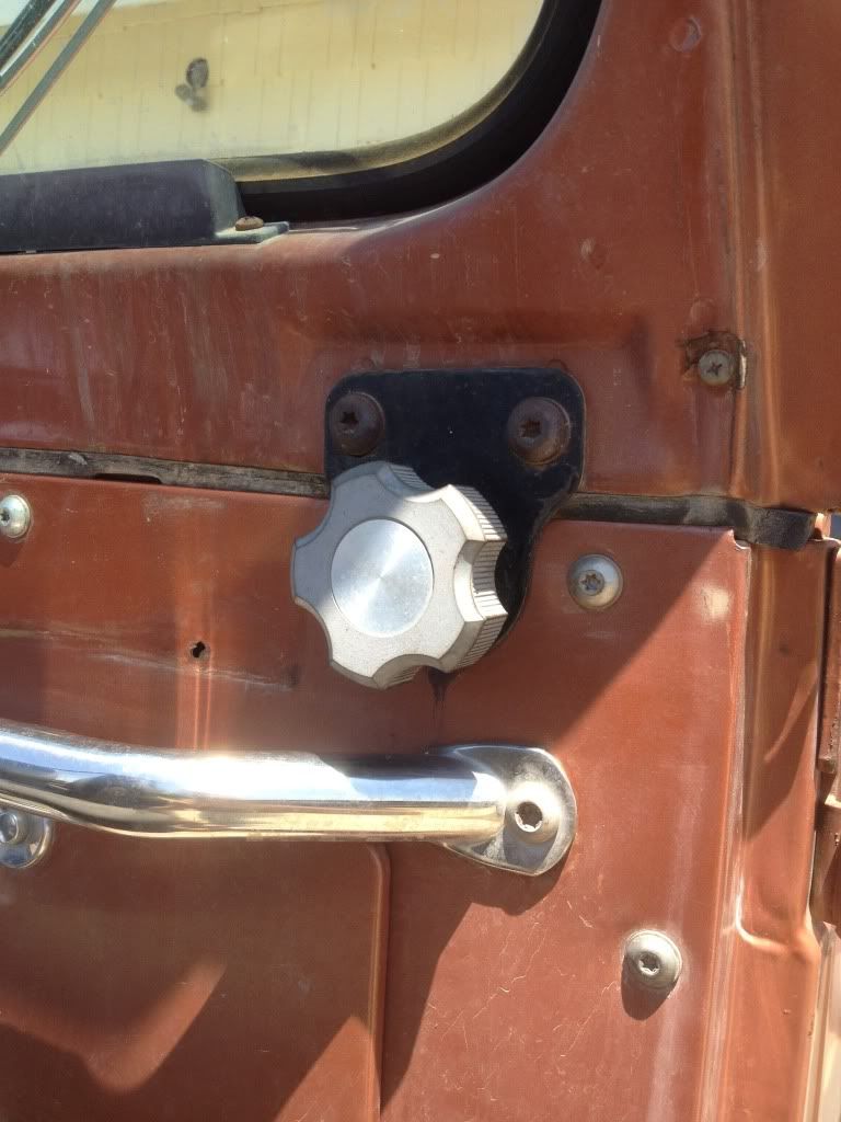

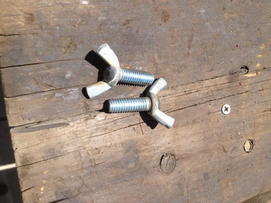

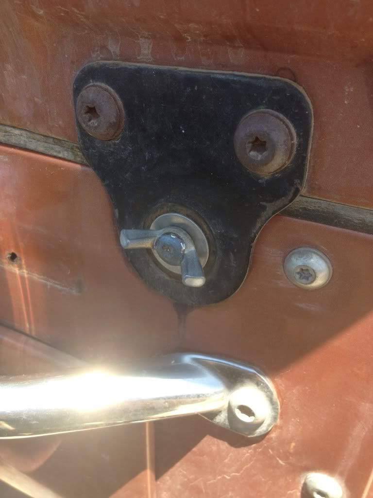

made some progress on the cage, the owner wanted the windshield to still be able to fold down and the knobs he had in there were gonna be in the way of the cage so i welded some wing nuts on a 3/8" bolt and put those in there
old knobs
new ones

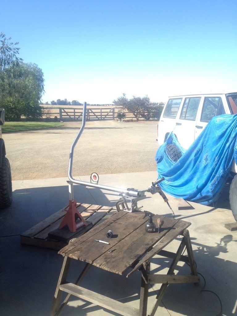

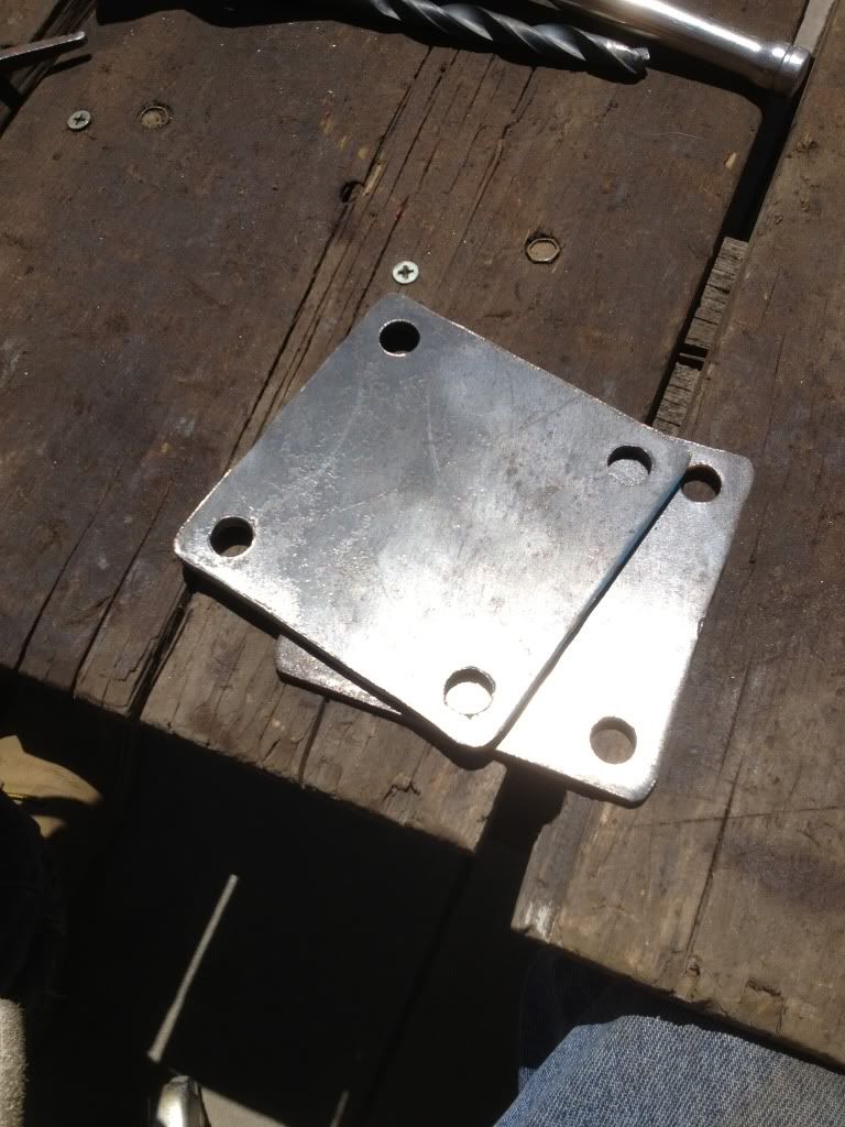

built some 4"x4" foot plates for the cage

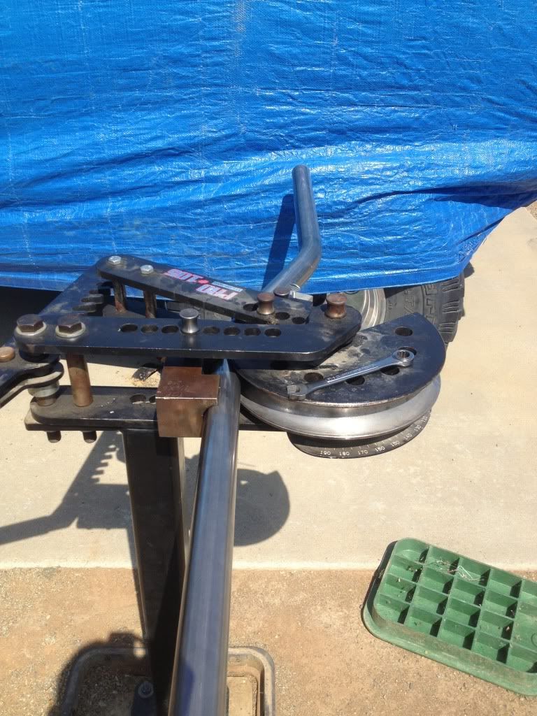

bending up the A pillar
all bent up

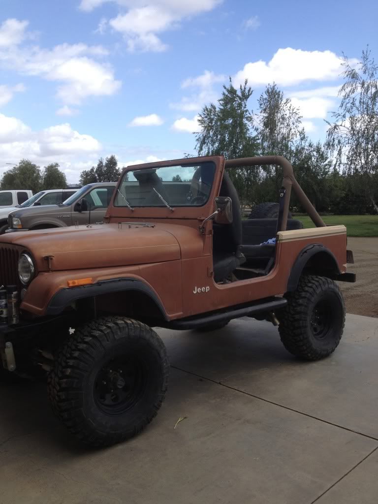

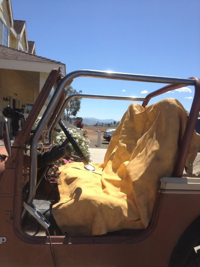

notching the A pillars
tacked in place
