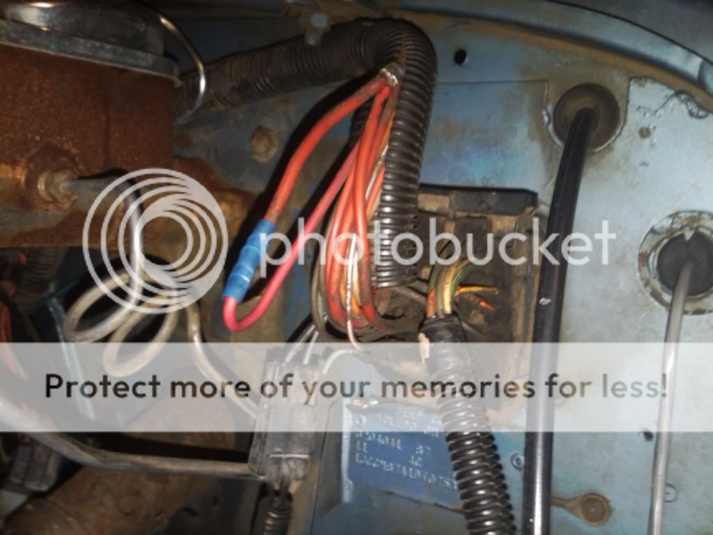

Gary, did you have it set up on manifold vacuum? Resistor wire out of the loop?

I think I may have exposed floors elsewhere in the system, with system being the whole engine. The fact that it just ran out of steam with or without the DUI had me a bit stumped. Possibly the stock air cleaner setup, stock Carter carb etc.
So here's an interesting thing I found today when I was putting the original back in my 7 and it will probably make y'all go "geez Gaz, what a dork!" I was setting the initial timing and I have a nice new timing cover with the 4, 8 and 12 degree marks clearly visible. Weeeelll the Overlander don't got that, it's all grubby and largely unreadable so I think I may have been setting up for 8 degrees thinking the marks were 2,4,6 and8. Get where I'm headed? I may have set up for 16 initial!!! No wonder I was getting some pinging on my short beach squirt after I installed the DUI. So maybe that's explaining something to us, sure exposes me as being No1 Boss Dufus. Bit embarrassing.
Anyways I reckon I gotta go back to the drawing board on the 8 with the DUI (with 8 degrees initial). This time though I'm going to do some different comparos. Something like going from cruising at 20k in second then flooring it (WOT) and timing the run up to 50 or 60k. Same again from cruising 3rd at 40 and ruining up to 80. Any other ideas guys?
Shawn
Stock vac spot Shawn , assumed ported. Resistor wire? Where is that little fella at?

Given the issues you mentioned, I think I'd start from scratch if I were in your shoes.
I'd get a timing tape and piston stop and go through the TDC Procedure to make sure everything lines up for you.
Next would be making sure I had a good, 12V power source to the distributor. I used the large, red wire that originally fed the OEM module. Before you snip anything, make sure that it maintains voltage in both "start" and "run" position from your ignition key. If so, snip it and run it straight over to the distributor. This will ensure that the resistor is out of the loop and you'll be feeding that D.U.I. roughly 13.5 volts when it's running. I'm not sure how yours is wired but my '83 looks like this. If all goes well, you can come back and solder and shrink-tube the connection. The red wire just above the butt connector shot straight down to feed the OEM module.
Lastly, your D.U.I. is set up to run straight manifold vacuum, not ported. Depending on your carb's ported vacuum signal, that may be why you didn't see the results you were hoping for and it could also explain the pinging you heard, aside from the 16* initial advance Having to pull it down to 6* is an indication that something isn't happy, assuming that the timing indicator is accurate.
Let me know if I can help with anything.
