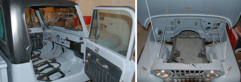

My son got his driver's license last month and now is putting pressure on me to finish the Gaucho. I'm thinking about doing that as soon as I finish my current Safari Cab project, so it's time for input from you guys. Here's how the Gaucho looks today:
I don't have an engine, transmission or transfer case or interior:
The bodywork is done, and the frame is a fully restored, lengthened and strengthened Scrambler frame (113.5" wheelbase now). The axles are stock CJ WT axles with 2.73 gears; these would need to have all seals and brakes replaced but otherwise are probably usable (if I'm willing to accept the crummy 2.73 gearing).
My last thought before I "put the Gaucho away" to work on the Safari Cab was that I'd try to find a 4.0 YJ Wrangler in decent shape, lengthen that frame to 113.5 WB, and just throw the Gaucho body parts on that running frame. But after casually looking for decent YJ's here for the past 6 months, anything in a price range I'd consider buying probably has a rust-damaged frame. So I'm now trying to decide on the best way to proceed with engine and drivetrain.
First, the expected usage: daily driver, no offroad use (ok, maybe I would try an easy-rated trail once, but that's it). Primary driver to be Alex, who so far is a careful driver.
Requirements/wants:
- Engine. Must be factory EFI. Don't care about OBDI or OBDII, either is fine, but I want an engine that came EFI from the factory. Don't really want to do a CJ 258 with aftermarket EFI.
- Transmission. I don't care whether it has a manual or automatic, although Alex says real Jeeps must have a manual.
- Transfer case. If keeping the current axles, then a CJ Dana 300 due to the passenger-side front driveshaft drop. If doing some other axles, another case would be ok.
- Axles. Don't really want to spend my life hacking brackets off donor axles and making them fit the CJ frame, also not interested in outboarding springs, etc. So it's either the CJ axles I've got, or do the complete YJ frame/running gear idea above.
Since this isn't a killer trail rig and won't see extreme duty, there's no need to do a big bucks killer build on this, all I need is basic daily driver reliability.
So here are some ideas I'm considering:
1. Keep looking for a 4.0 YJ to use as described above. Lengthen the YJ frame to 113.5 WB, and drop the Gaucho sheet metal on the complete YJ frame/running gear. Sell the current frame (perhaps to someone who needs a new Scrambler frame and would want to shorten this one. It is after all, a fully restored frame).
2. Keep the CJ axles, and find a Dana 300. Also get a 4.0 donor, perhaps an XJ (auto or manual), and use the XJ 4.0 and transmission with the Dana 300.
3. Keep the CJ axles, and find a Dana 300. Find Chevy S-10 with an EFI 4.3 V-6 and transmisison (either the S-10 version of the T-5 or an auto), and adaapt that to the Dana 300.
4. Do the YJ thing, but settle for a 4-cylinder instead. They're much more plentiful than the 4.0 YJ's so I could probably find one with a decent frame.
5. ??? Some other option you guys suggest...
6. Forget it, sell the Gaucho as is and get Alex some other vehicle.
Since this isn't a killer trail rig and won't see extreme duty, there's no need to do a big bucks killer build on this, all I need is basic daily driver reliability, so please keep your suggestions in that range.
What do you guys think? Thanks in advance for your input.
Jeff
