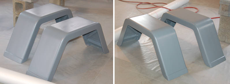

This week I'm working on finishing the new fiberglass fenders for the Retro. I made these in the fall at the same time I did the Gaucho fenders, but never got around to finishing them. Here they are sprayed with epoxy primer, and next I'll spray them with three coats of high-build primer/surfacer, followed by hand block sanding with 400 grit. Probably after that there will be another coat of primer/surfacer, followed by 600 grit block sanding, then they will probably be ready to go to the body shop for color/clear.

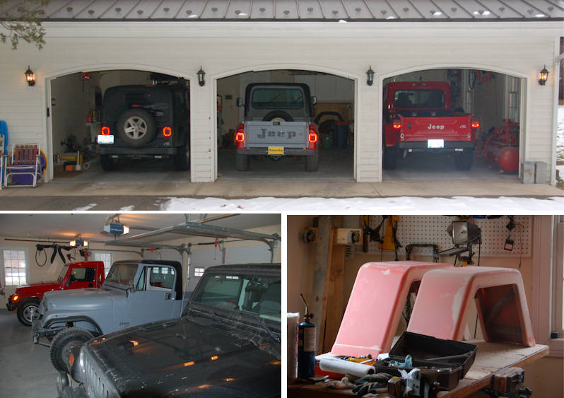

I don't have an update on the Gaucho project other than to say the Gaucho is sitting in the garage serving as a development tool providing measurements and test fittings for the Safari Cab hardtop project. I'm doing most of the development work for the Safari Cab on my LJ, but the top is also being designed to fit CJ-7's and CJ-8's; here's a recent concept drawing of the full top on a CJ-7.
Construction of the top is underway, documented in the TJ forum, because of the LJ being used for the primary construction. http://www.jeepforum.com/forum/f9/safari-cab-custom-hardtop-project-952157/
After the Safari Cab project is done, then I'll focus on the Gaucho again and decide what to do with it.
