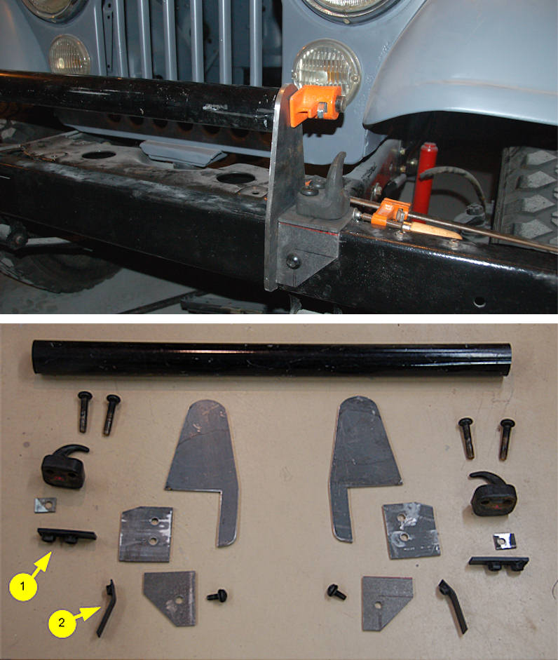

I got the rest of the pieces of the bumper bar cut out today so I could mock it up on the Gaucho. Before I weld it together I think I'll lower the vertical height about 2 1/2" - seems like it's too close to the height of the turn signals, could be a problem with inspection or the law - anyone ever have a problem with bumpers/winches/etc. obscuring the turn signals?

not unusual at all...another option would be to narrow it a bit with wider mounting plates, and flip your hooks side to side. (though I'm guessing that's out since you'd like to fit a winch behind it???)

Yes, there is a law about turn signals but its not always enforced in every state. In any case, I installed another pair of (small) amber turn signal lights into my front bumper just in case. I could have gotten away with installing those tiny amber LEDs units in the bumper or the front of the fenders.

I did some more measuring this morning, I think if I drop the bar about 1" I'll be comfortable the signal lights are visible enough, so that's what I plan to do.

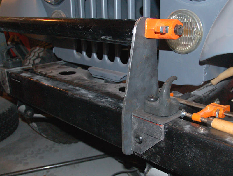

I lowered the bumper bar about 1 1/4", and at this height I think it won't attract any attention during inspection. It is lower than the original Gaucho bar, I guess they got away with it back then. Probably it would be ok now too, but I like to be on the safe side.
Anyway it is still high enough and wide enough not to interfere with the mounting of a winch, winch plate or fairlead.
The bottom photo shows the complete bumper bar "kit". I'm not going to cut the bar to final length yet or weld it together at this point because if I decide to finish the Gaucho on a YJ frame, the bar will need to be longer to fit the wider spacing of the YJ frame rails. So for now I'll just leave it in kit form.
Here's a couple of little tricks I built into the mounting:
1. I made nut plates from 1/4" steel and welded 1/2" nuts to it. This will make it easier to install the bar/hooks, you won't need a wrench inside the bumper, and because of the nut plates the assembly will be stronger.
2. For the bolts that go through the front of the bumper, I made "handle nuts", by welding 3/8" nuts to a piece of steel strip. There isn't too much clearance between the back of the bumper and the front frame crossmember, so the handle nuts make it easier to get the nuts started on the bolts, and no wrench is required behind the bumper to tighten the nuts, just hold the handle. Handle nuts are used in a couple of places on the TJ frame and I always thought they were a clever idea for hard-to-reach nuts.

John, I have to say the idea to make the nut plates for mounting the tow hooks is genius. I hate with a passion trying to get a wrench up in the bumper to install or remove tow hooks. Great idea!
