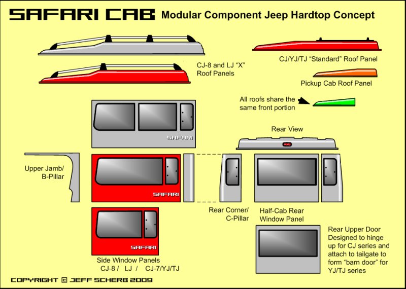

Fiberglass or Metal tops? You said they were a modular design, how do you plan on locking them together.
I see a great potential in these.
Fiberglass panels with some metal components. There are several methods of joining the modules, depending on which modules and which joints. Some joints would be permanently bonded with either polyester or epoxy resin, or with automotive structural adhesive, while others would be joined with bolts and rubber gaskets to allow the top to be disassembled into smaller parts for storage. Most tops would come apart into a roof panel, two side panels, a back panel and a rear door panel. The pickup tops obviously would only have a rear panel, and no rear door panel. Here's an illustration showing the modular concept in a little more detail.

My vote (not that this has been made into a poll) Finish the Gaucho! then.........I would love to see either a CJ8 or LJ with this elevated roof "X-Panel" I think that would be really sharp. And if you made a modular CJ7 hardtop I'd be first in line to buy one...and possibly the short trailer to go with it...
If I build the hardtops, I wouldn't be doing it as a business, that would take all the fun out of it. I only build this stuff for my own enjoyment.
But... I have had conversations with a company in the Jeep aftermarket business that has expressed an interested in licensing the top designs/molds/masters (if and when I build them) so they might offer them commercially. It's a long road from here to there though, so don't get your wallet out just yet.
