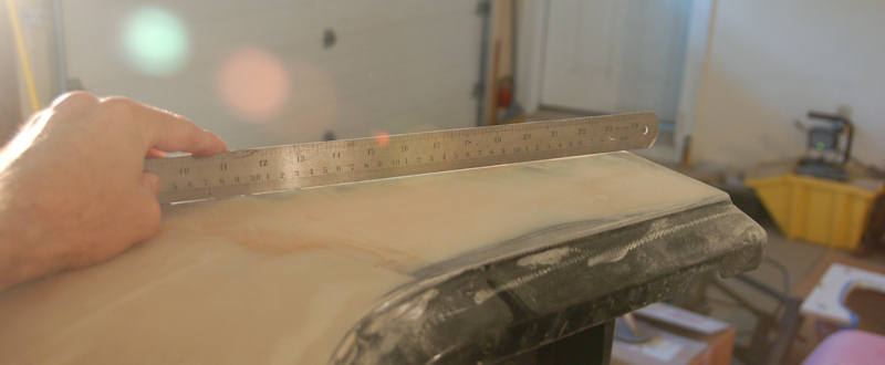

Here's another tip...
"It isn't right until there's no light." You can quote me on that.
I use a straightedge constantly when doing Jeep bodywork. With so many flat and straight surfaces, the straightedge is the perfect tool to check your work. It may feel smooth when you run your hand over it, but even a few thousandths of an inch variation will show up in a glossy paint job. If you can put a straightedge on it and not see light between the edge and the body, then you're good. I've got a few minor high spots to work on in this photo, there's one just under the tip of my index finger, you can't see light there... a little more time with the long board sander and this will be perfect.

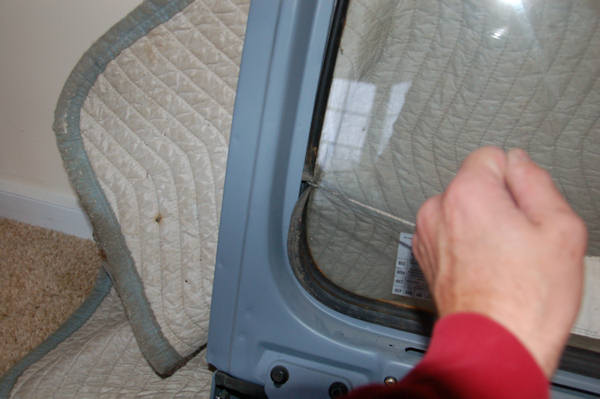

Another little "how to" today - installing windshield glass.
First step is to put the weatherstrip on the glass. I'm working on a Mover's Blanket, they're really nice for working on painted or primed parts - they are designed not to scratch furniture and have thick padding. They're often available on sale at Harbor Freight for $6 or so. Or maybe your mover will forget one, like he did with me
Also remove anything that will get in the way, such as the visors, VIN plate and defroster deflectors.
BTW I'm working on a blanket on the floor, but this is just as easily done with the windshield frame still installed on the Jeep.
Next, put some small rope in the weatherstrip channel where the weatherstrip will go around the sheet metal of the window opening. Wrap it all the way around and overlap it as shown. The twine I'm using is really slightly small for this job, it might break when I'm pulling hard on the last few inches later, but it's all I had on hand this morning. Sometimes it helps to lubricate the groove in the weatherstrip, you can use glass cleaner for that, some people use dish soap. I didn't use anything.
Set the bottom of the weatherstrip over the sheet metal of the window opening from the outside, making sure the rope is inside. Using your finger, make sure the weatherstrip is seated fully across the bottom of the window opening.
Now begin pulling the ropes out, as shown. This will pull out the weatherstrip from in front of the sheet metal to the back and seat it. Usually it's easiest to pull alternately on each side, so eventually the rope ends meet in the middle of the top of the windshield.
Once you've pulled the rope all the way through, run your hand all the way around the weatherstrip to make sure it's seated properly. Then reinstall the visors and other parts and you're done.
It took me way longer to write this up than it did to install the windshield.
